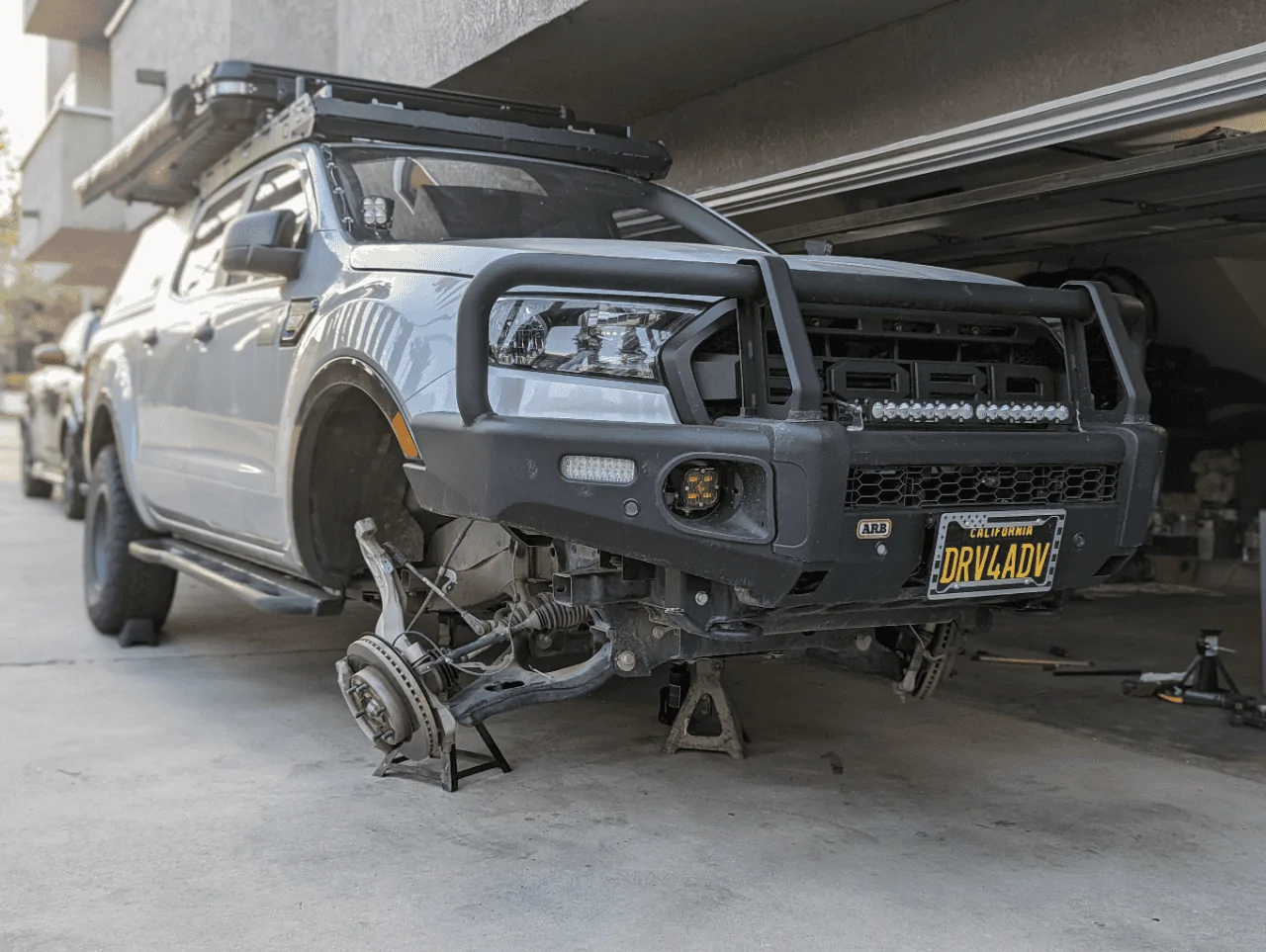

How high is your lift in the front to clear the 33s? Did you do all the works yourself?
Height...don't know. My coilovers are currently with Saint's Offroad in Glendora. I am having them swap my springs. Going from 550 to 650 lbs springs to accommodate for the bumper and winch. Once those are done and I bolt them back on the truck I can get measurements for you.
Right now my truck is sitting on Jack stands. It's so sad to look at.
