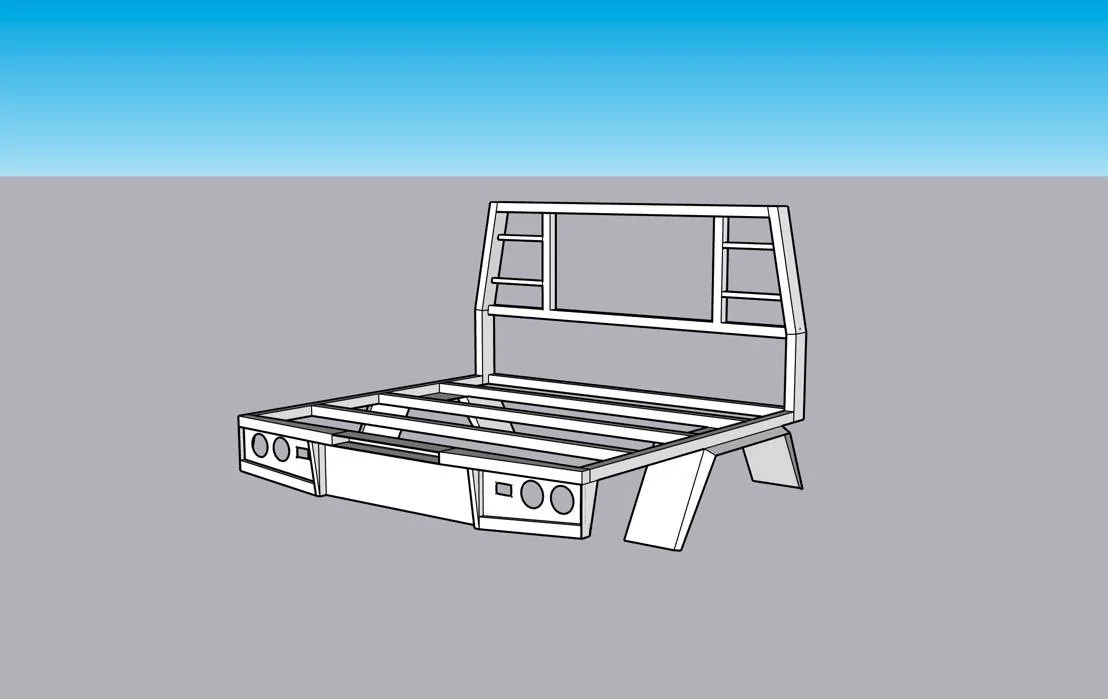

I think for the corner storage I will work the fuel into the drivers side. Then possibly a water spigot into the passengers side.
do you plan on building/including a water tank?

do you plan on building a water tank?
Yes I sure do. I will plastic weld it. And will fit it either below the tray or in between the headboard depending on how I brace it.

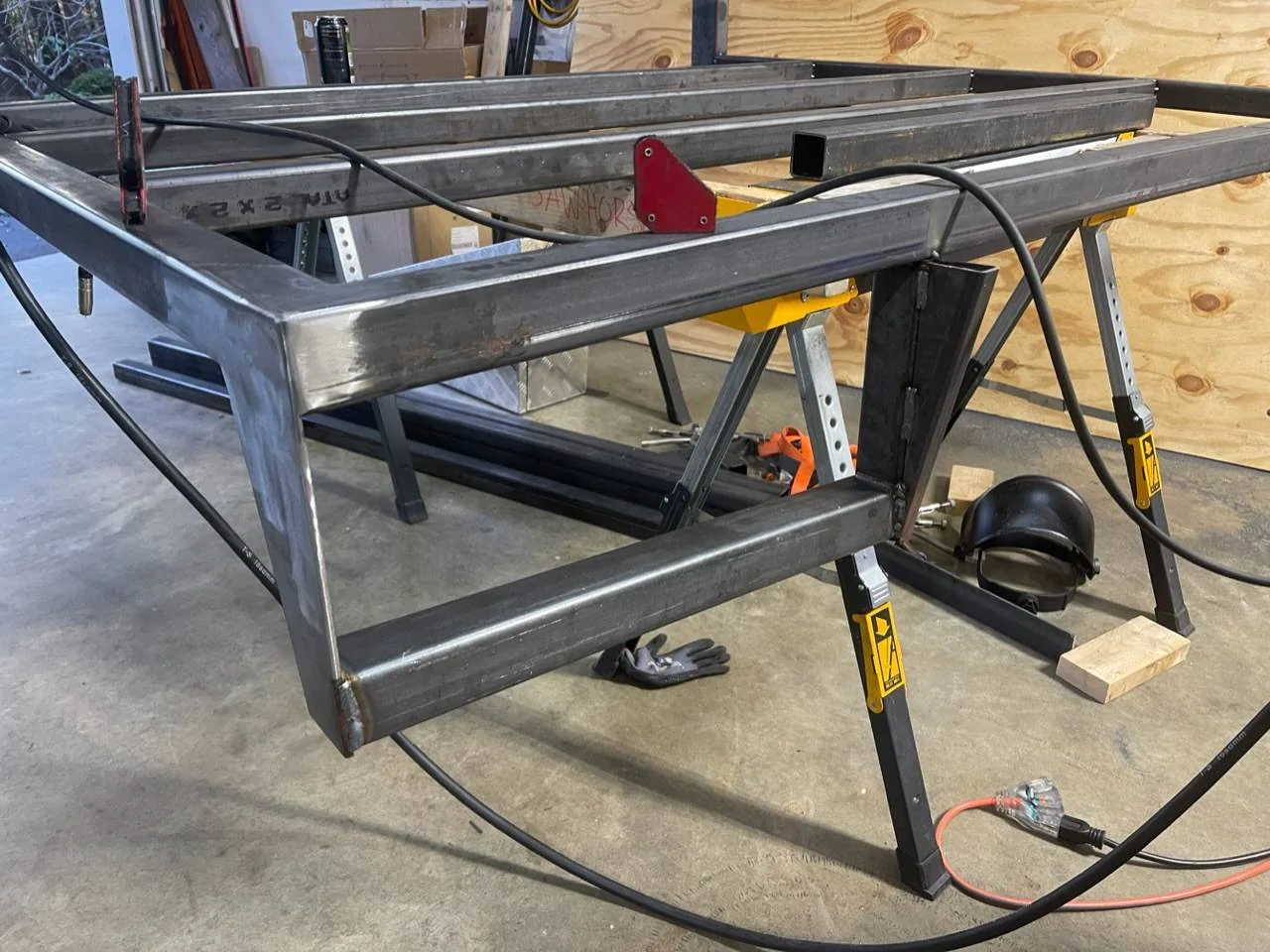

Updated the tail light section. I dig it!!
Nice neat welding, unlike my crappy stuff! As I said before - great job, can't wait to watch it progress.
Thanks bud! I do find myself sometimes trying to hurry so I always remind myself to chill the hell out. lol. I should finish the other side tonight then do a little more Sunday.
