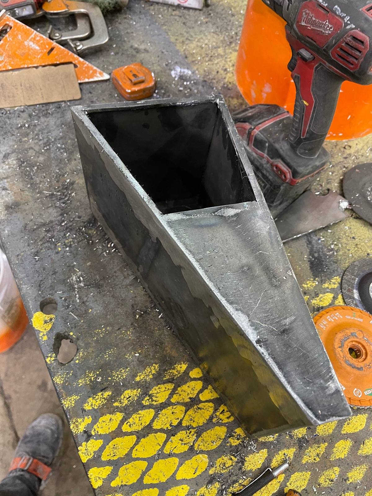

Here is the update on the fuel compartment. I’ve got it all welded up and ground down smooth enough for a DA sander. Then I’ll paint it all up at the house. I’ve got to cut the lower compartment opening then weld up a flange for the gasket to ride on and seal the compartment up.
it won’t match the rear under tray compartments because I hate them and I want to build my own.

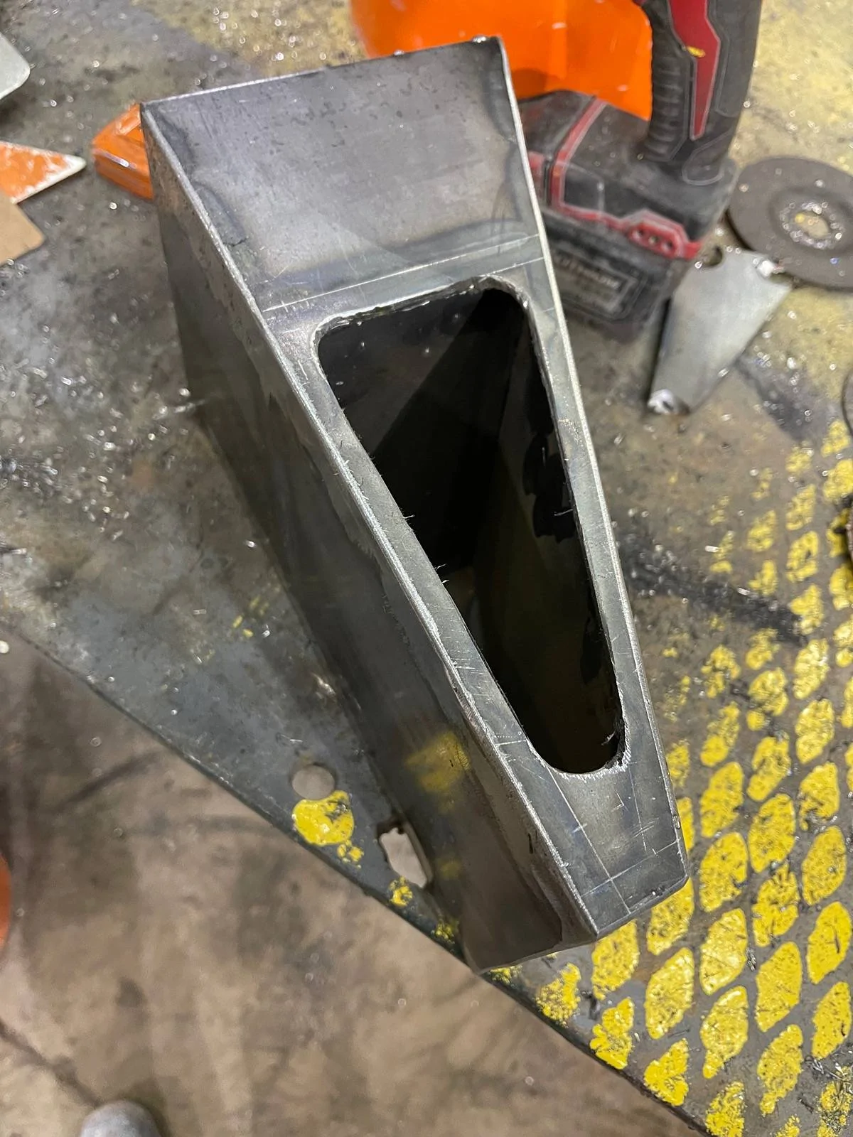

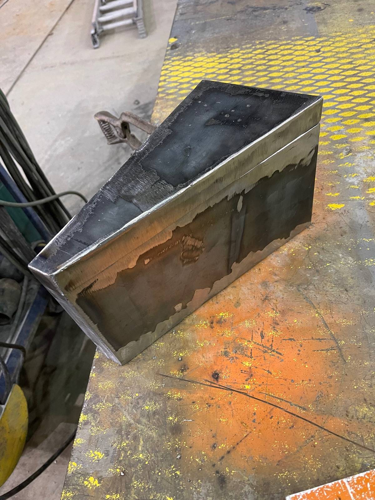

Here is the front of the fuel compartment. I need to clean up the cut out a little more then weld on a flange for the gasket. Yeah it’s not much of a storage compartment but I was mainly going to put the funnel that comes with the truck, some mechanics gloves, and maybe some latex gloves. Who knows. In the upper portion I’m going to make a 65mm hole for the filler neck to slide into. Haven’t fully figured that part out. Once I get this near the truck I’ll figure that out.
Then here is the back side of the fuel compartment. The piece of steel that separates the two compartments is at an angle just for the filler neck. I’m hoping I guessed the correct angle but either way I’ll make it work.

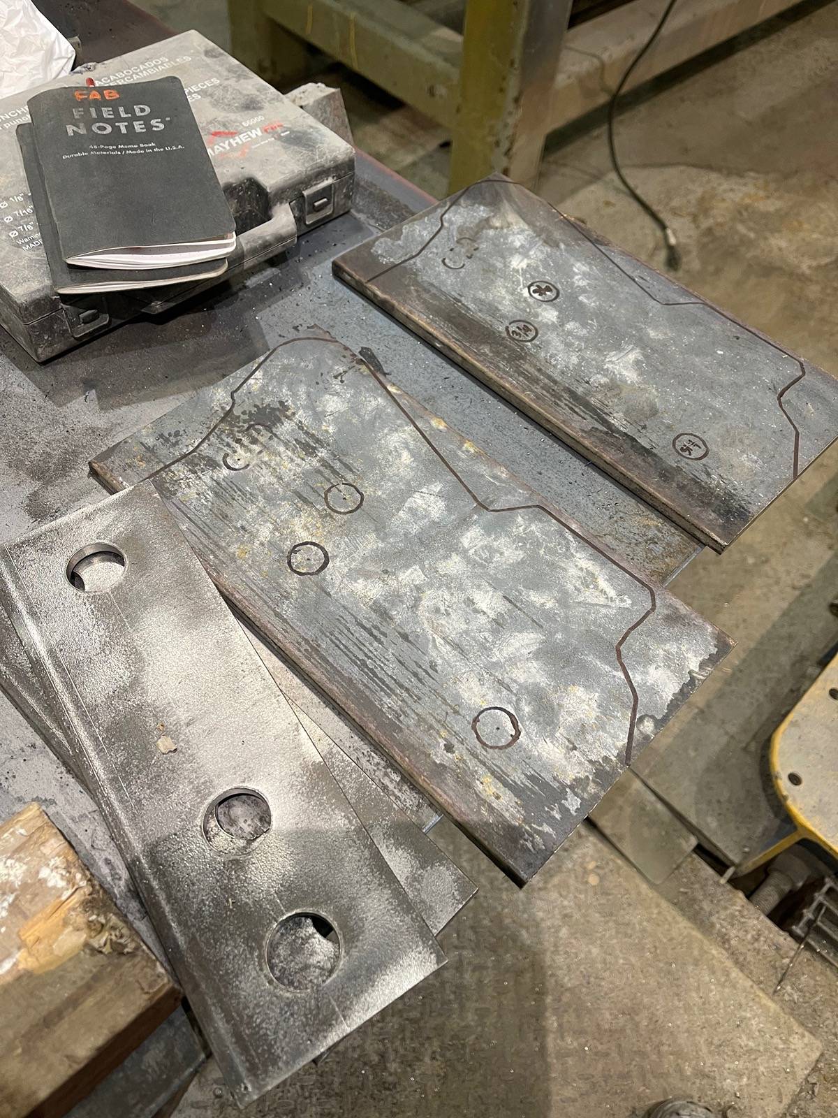

Well I’m at a stand still on the fuel compartment so I started another project for the truck… smh. I’ve got a second winch that was sent from Warn a while back and so I’m deleting my OEM hitch, and building a high clearance hitch/ rear winch mount. Instead of it bolting to the bottom of the frame it will be between the frame rails and the winch will sit just in between the OEM cross member and the new receiver. I started out with a cardboard template for the inboard faces of the frame. They are pretty odd shaped, so I’m still on the fence on how elaborate I’ll get cutting that mess out but there will be a bottom plate that utilizes the OEM hitch bolts. Probably overly bolted down but I just want to make sure. Then for the cross member I’m probably going to use either a 3x3 with a 3/16 wall thickness or a 2x2 1/4 wall thickness. Either way it will be chopped in half and a recessed 2” receiver. I’ll put in some fancy safety chain hoops as well.
The bottom plates are 3/16” and the side plates are 3/8” thick. Again probably over kill but I was thinking about incorporating some shackle tabs into the side plates but most weld on tabs are 7/8 or 1” thick from what I’ve seen and all I have is 1/2” AR plate.

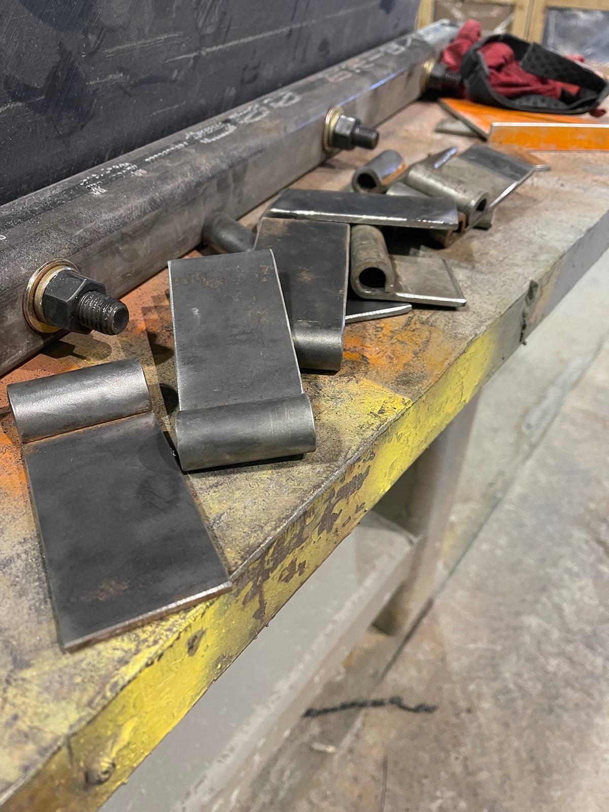

Well I definitely have projects all over the place now. Similar to how my mind works when I’m fabricating haha. All over the place thinking and designing stuff in my head. But I found some heavy duty hinges laying around at work. ? ? so I chopped them down into individual pieces to create hinges for my future drop sides on the flatbed.
there is a 3/8” rod that goes through them. I’m thinking about getting a 3/8” Stainless rod and tapping the end of it for a bolt to hold it in place or keeping the steel rod and welding it in place. Going to bring this stuff home with me and mull it over. I’m hoping to swing by a local metal shop in Missoula to see if they are capable of bending some sheet metal into some drop sides for me then I’ll have a better containment for my camping gear this summer.
