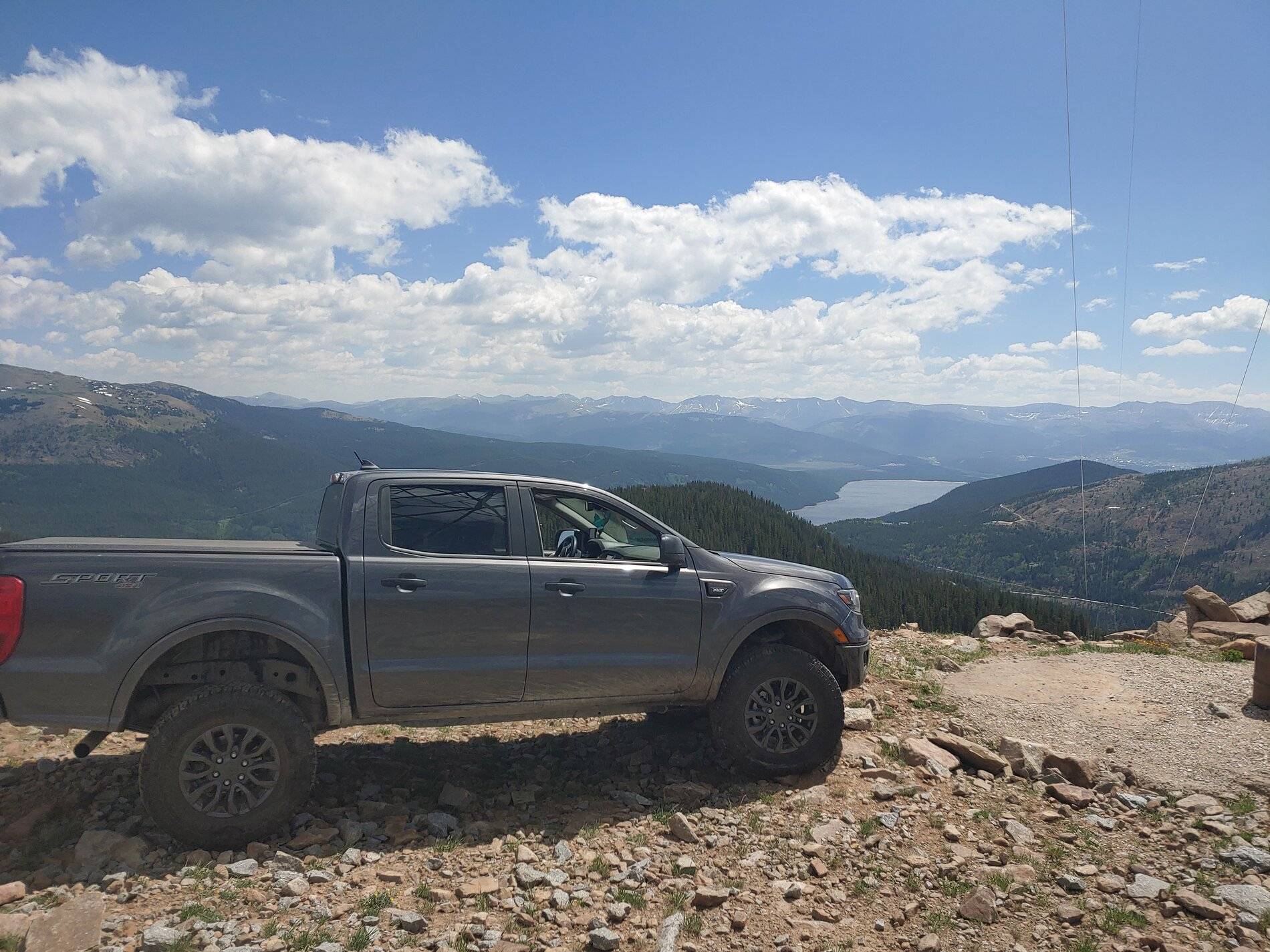

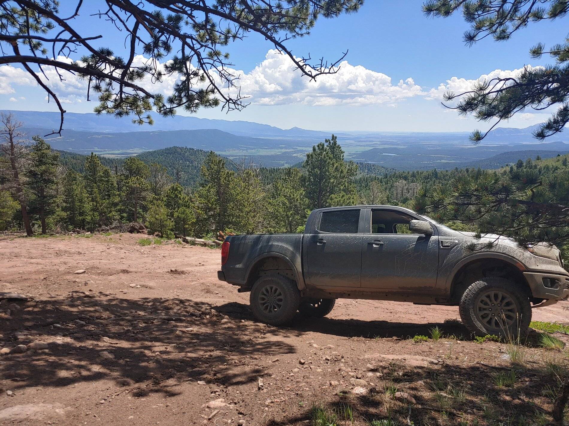

A good set of tire and a Practical Lift kit will do quite a bit!! I myself went with the Old Man EMU lift kit by ARB. I also have 285/70-17 Firestone Destination XT'S on stock wheels with no spacers. The overall handeling has improved with the suspension and the OffRoad capabilities are great!! Want to tow? Well you still can tow at factory towing capacity too!!
Here are some pictures of the truck with the tires and lift

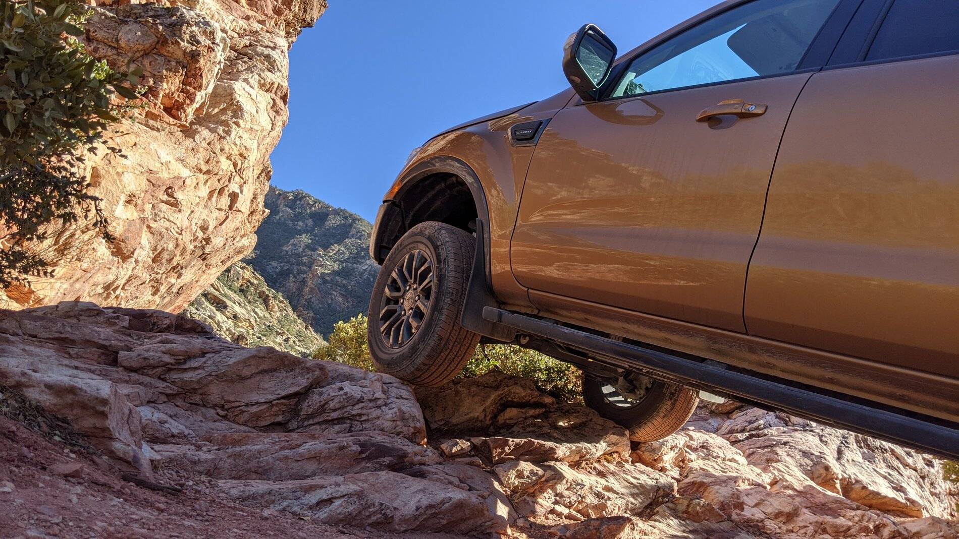

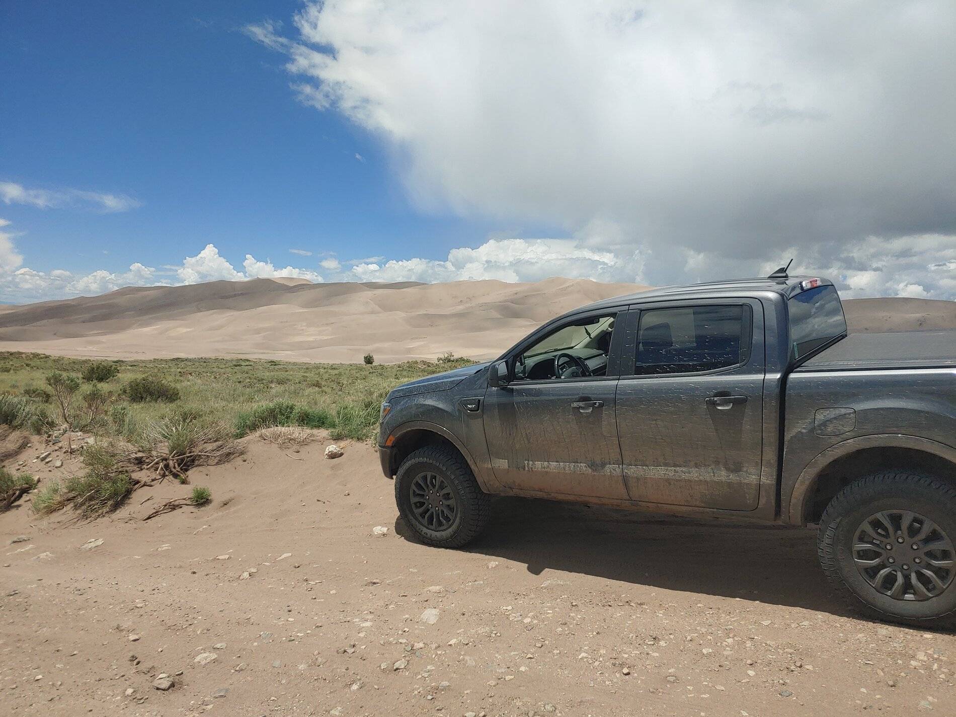

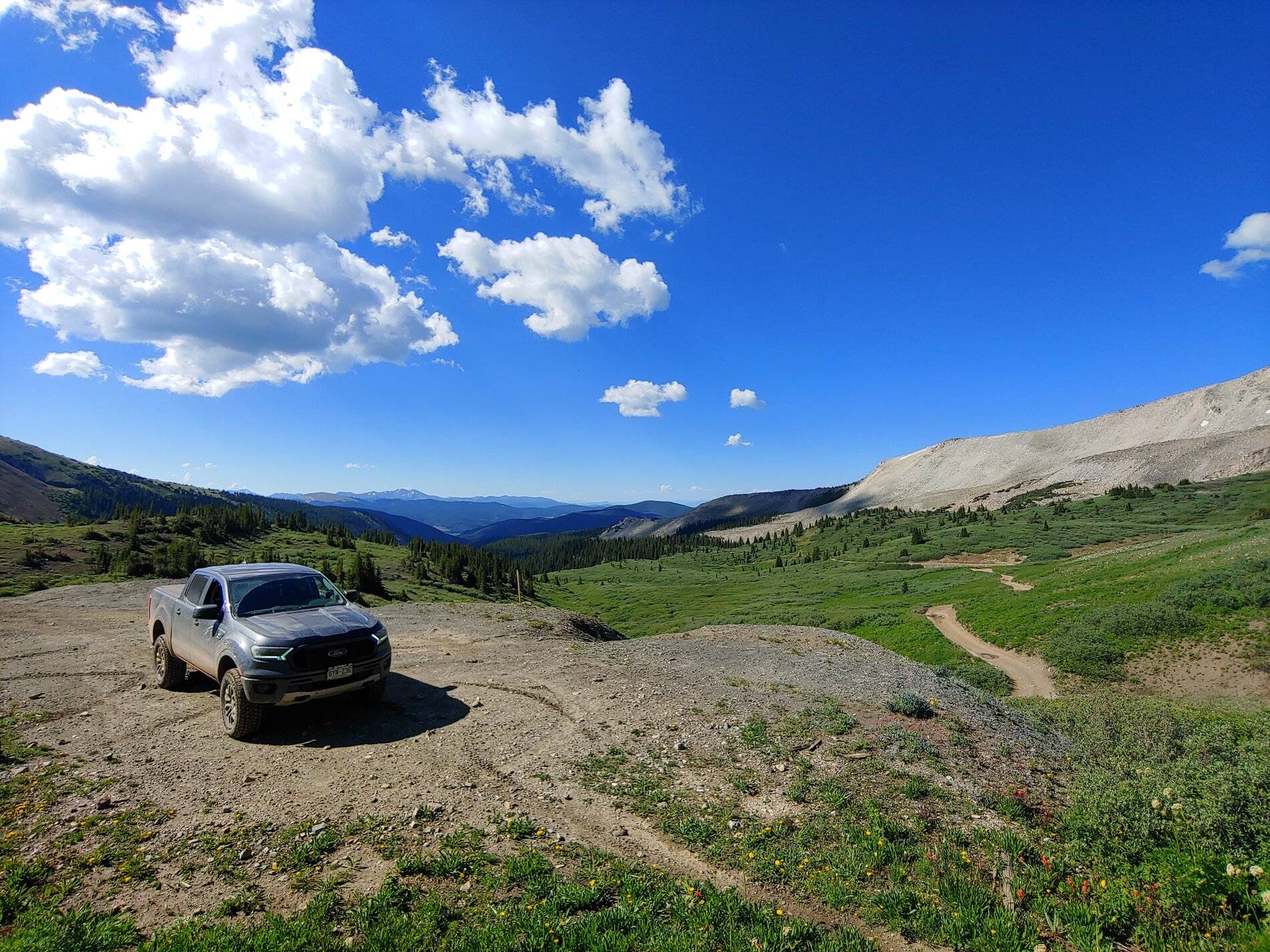

Your pictures show about the extent of what I want to do currently.
allow me to be the contrarian, then.
i think your truck is ready to go as-is. and if you have been getting stuck out there, the best bang for your buck without getting expensive and complicated is tires.
i doubt clearance is what is limiting most occasional offroaders, so much as traction.
we did plenty of offroading full stock pushing this truck far beyond what i think you are describing (see some previous threads that touch on this), and later upgraded our tires only making the truck even more capable (slightly more clearance, slighter better tread pattern, slightly better sidewalls) and haven't looked back.
