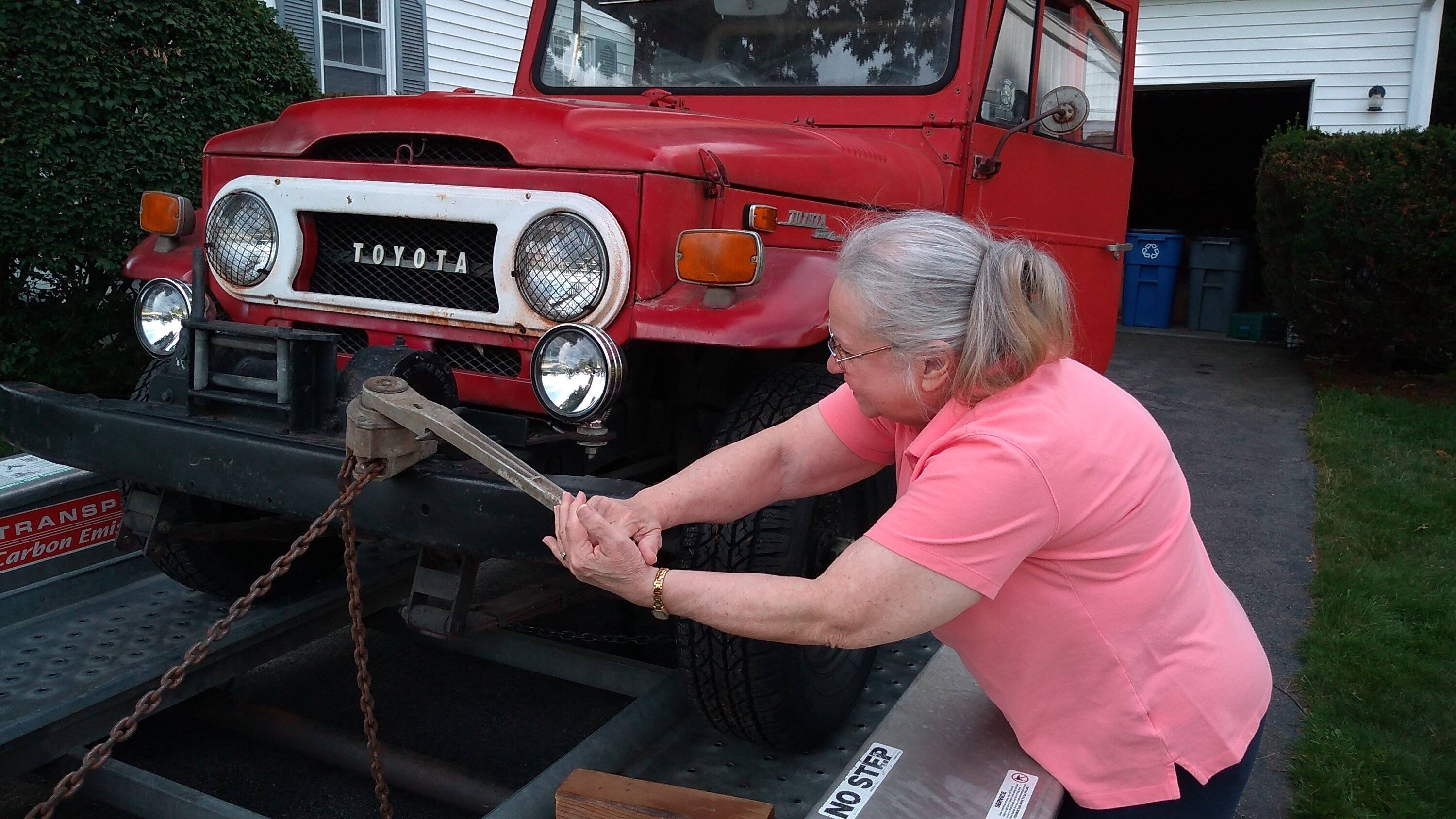

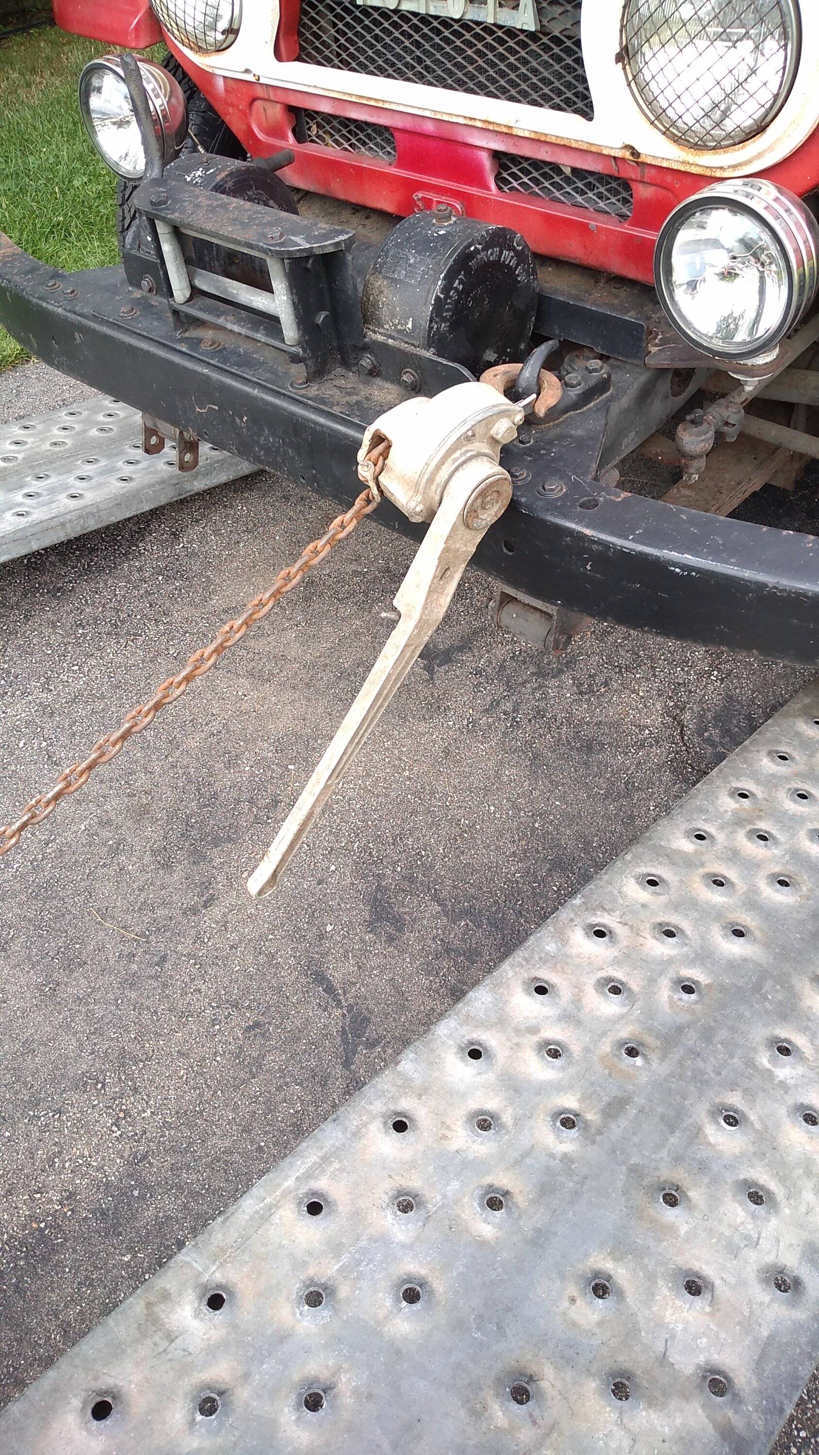

I used a chain come along for 20 years with an FJ40. Pulled it out probably 7 or 8 times. The worst was three days stuck in a swamp up to the frame in Michigan.
I was 16 and my dad said we'd have to wait till winter to get it out. I spent long days digging and sleeping in that Tojo.
Dug out holes for jacks and kept showing saplings in until the jacks stopped sinking. Then started shoving anything and everything under each tire until they were high enough to roll out of their ruts.
Then the real work. Used chains and some anchor line and pulled it a few feet at a time. Come along only has 5 feet of chain and half would go to stretching and rolling back. After I got it maybe 25 feet from where it went down, I started it up and floored the life out of that 3.9 liter straight six in low case 4x4 and mowed down some 4" samplings and didn't let off the gas until I was on the dirt road.
But I was 16 and wasn't going to disappoint my dad. I was beaming and so proud when I drove it home. =)
Years later, I got an old 1962 PTO Ramsey winch.
But I carry that same come along in Soupie and have no doubt I could get it out of anything I foolishly get into. That said, it's a 4X2 and my serious off road days are long behind me. I also carry tire chains and that's a throw back to my days in Quebec way back when.
used it last summer, fittingly to pull the Tojo onto a trailer to bring it to my daughter to restore =)
