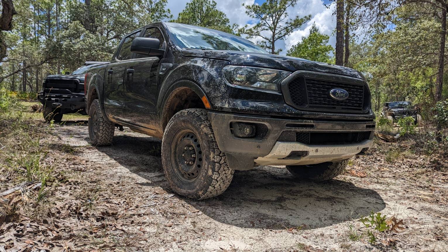

thats where i got my spare rims from the bronco buyers doing all the fluffy pimp wheels and tires leaves lots of stock and steelies for rangers.
Black Diamond steelies look awesome on the Ranger. Trying to get one more to use as my spare now.
