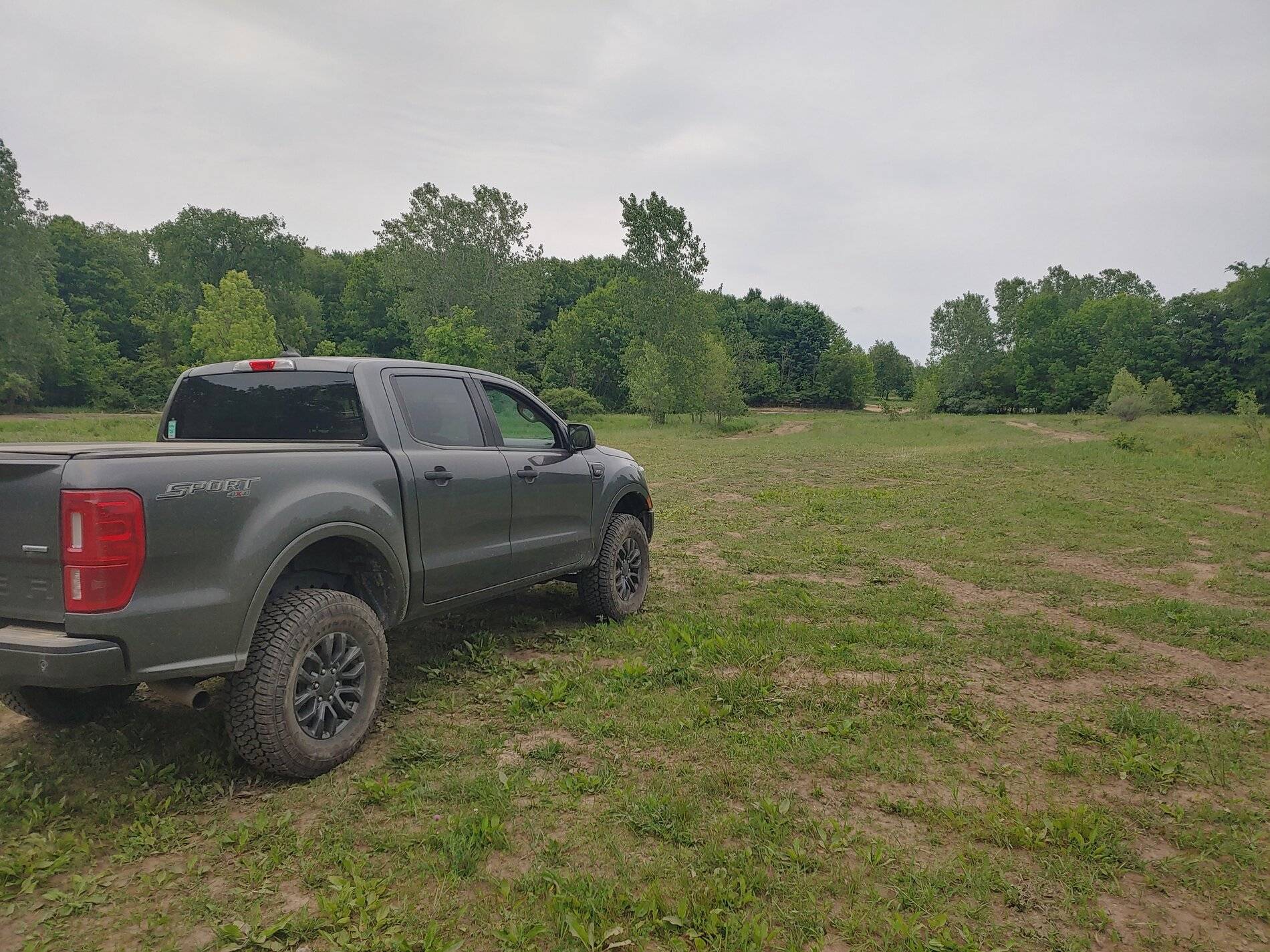

That size has been confirmed to fit the Ranger without a lift or leveling kit. Will it give you a little extra clearance? Yes, about an inch overall. Could you go a little bigger with a lift? Absolutely. My current setup from the last time I mentioned is the Old Man EMU lift(probably had it then) with the Firestone Destination XT in 285/70-17 on factory sport wheels with no spacers and still have the factory crash bars(no they were not modified). Overall my lift is 4 inches front and 3 inches rear. The truck is still practical to use and drivea on the street just fine. I should add that I can still bottom out even with the extra travel but the ride is way more comfortable compared to stock.

Your pictures show about the extent of what I want to do currently. I have done a fair about of traveling by 2wd truck in places I should not have gone before my family. I am looking to do trails with my boys to see what is off the pavement. Maybe some camping as they get older because the boss likes her A/C. I am thinking the Ford fox 2.0. The I will go one size up in tires once these wear out. I picked the truck up used with 7,600 miles at a Subaru Dealership, So the tires will be a minute. I was told to replace the running boards with rock sliders to avoid body damage, that worth it?
