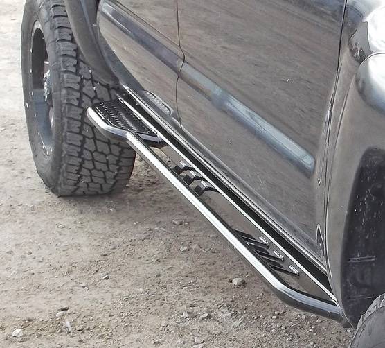

Which one's do you think are worth it? I like the ones with flare out past cab for a step to access my tool box better.

If you are doing any rock crawling, yes absolutely. If not, wont make a difference.

Rock sliders are great for peace of mind on the trail. Not necessary at all, and you can do some pretty rough trails without having to worry about it, but certainly comforting to have when you do get to some rocky sections.

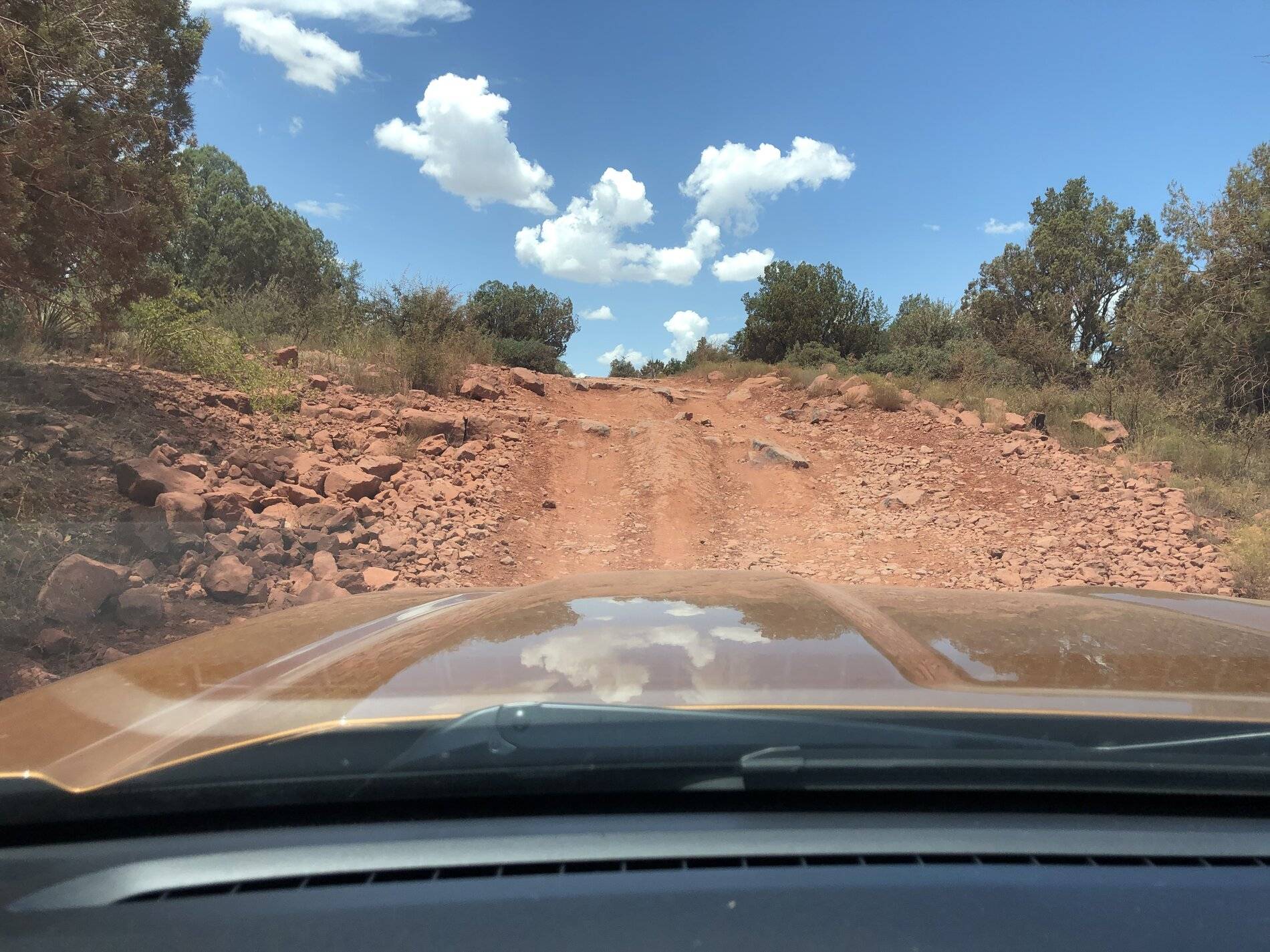

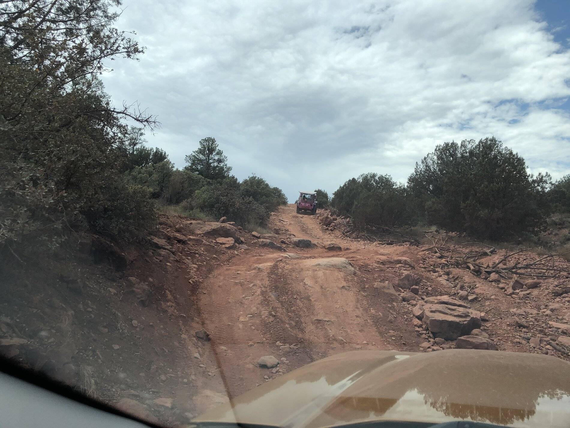

For reference, I did this "difficult" rated trail, with just a 2" spacer level kit and 32" tires (235/85r16) and no rock sliders or traction control. I would definitely not do a spacer level kit again, but at the time there weren't many options.
