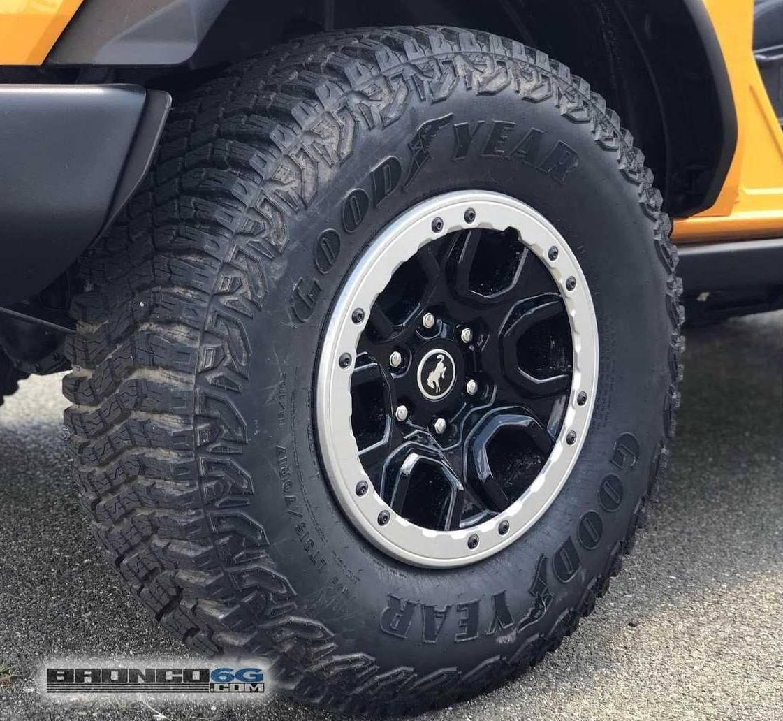

I think these are a great looking wheel. From my understanding, you can remove the beauty rings and powder coat them any color you want. In addition, the +30 offset is ideal and they are hub centric. Only question would be if you could swat center caps.
I'm going to keep my eye on the used wheel market for these. I think once more and more people begin taking these off for aftermarket wheels, they might be had for a good deal.

I'm sure they will fit but be advised that those are not beauty rings. They are functional bead lockers similar to the raptor wheels

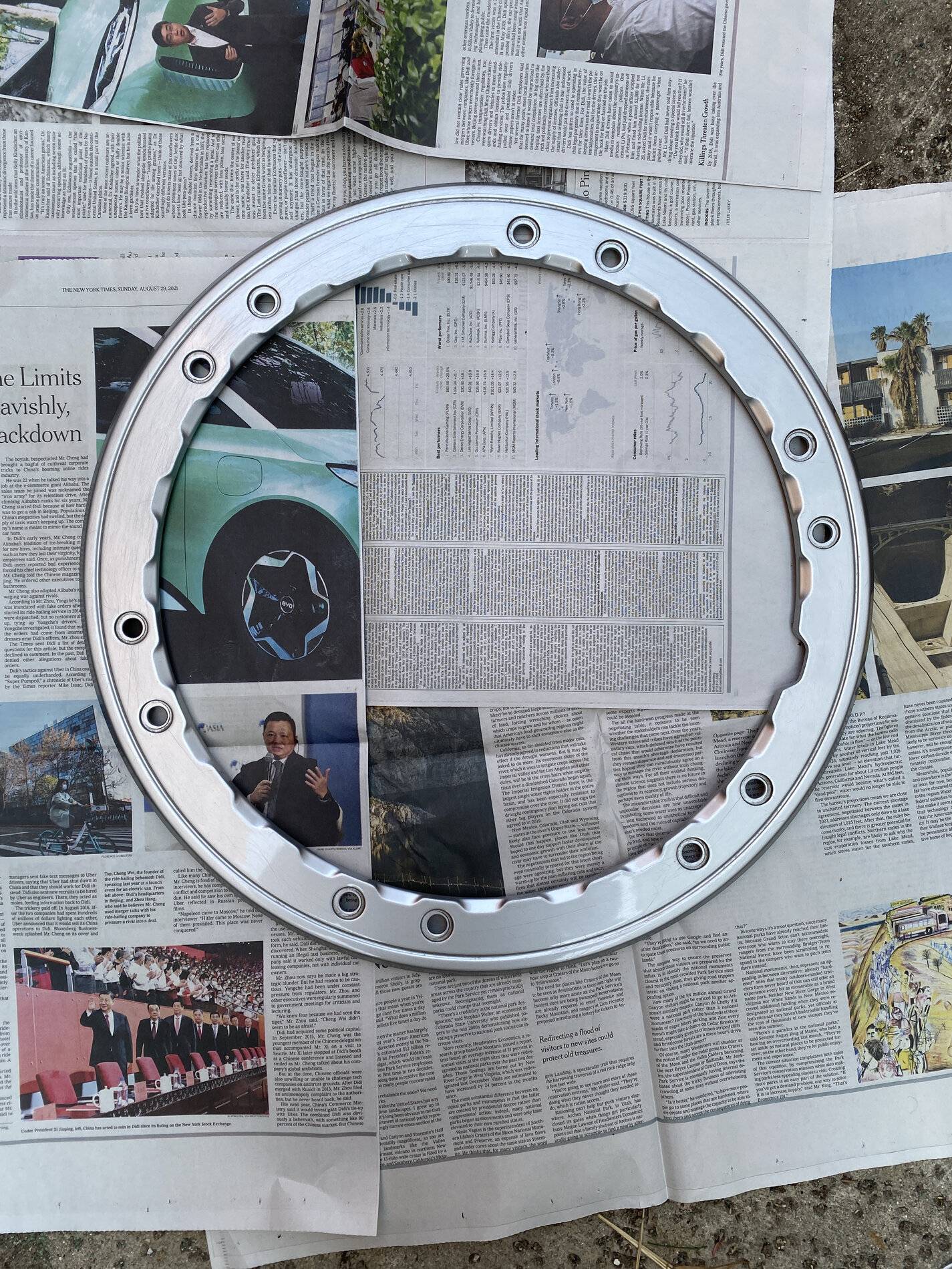

No, those are the beauty rings on the wheel pictured. They need to be removed in order to use Ford's beadlock kit which must be purchased separately. This kit here is an example.

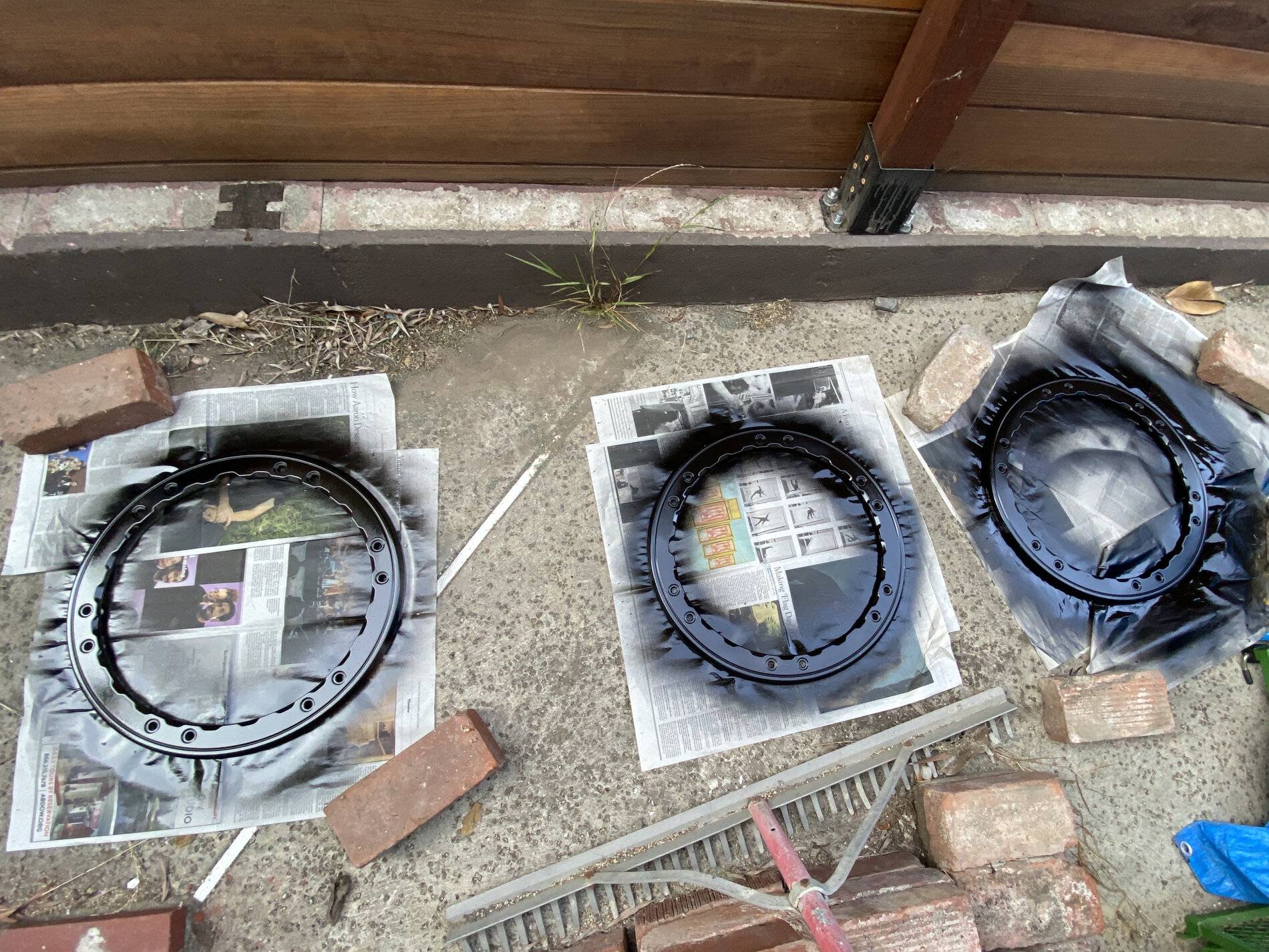

Yup they're Beadlock Capable Wheels. Here's someone who took them off and painted them Black. Ford isn't going to offer 5 of these for only $995.00 being full beadlocks.

No, those are the beauty rings on the wheel pictured. They need to be removed in order to use Ford's beadlock kit which must be purchased separately. This kit here is and example.
Lol apparently you havent changed tires on a raptor yet? You have to remove the factory bead locker ring in order to replace the tires. Not fun but it has to be done. It's the same for the Bronco
Frenchy, I don't think you are comprehending what I'm saying... lol. Those are not beadlocks you see on that wheel. They are beauty rings. Though the Bronco Sasquatch wheel is beadlock capable, you have to purchase those separately. It was pointed out in post #5 of the thread where a Bronco owner changed the color of his beauty rings. No beadlocks were involved.
So Shea, I guess those rings don’t really extend beyond the outer part of the wheel - they’re likely flush with the wheel’s outside edge?

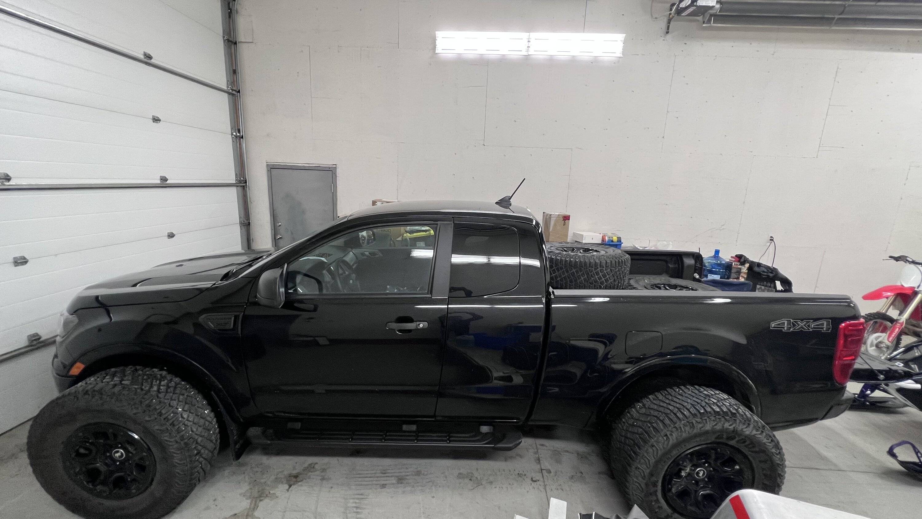

I just recently purchased a new ranger after selling my 2021 bronco badlands. I had bought a set of Sasquatch wheels/tires off a wildtrack and didn’t sell them with the bronco.
will be peeling off the 315s and trying the wheels on in the spring. I don’t want to remove crash bars or lift the truck so we’ll see what the max size of tire I can mount on them.
I’m thinking a 31.6” tire or maybe a 285/70/17 will fit due to the +30 backspacing on these wheels.
here’s a few photos of them placed beside to see the difference vs stock 18s.
