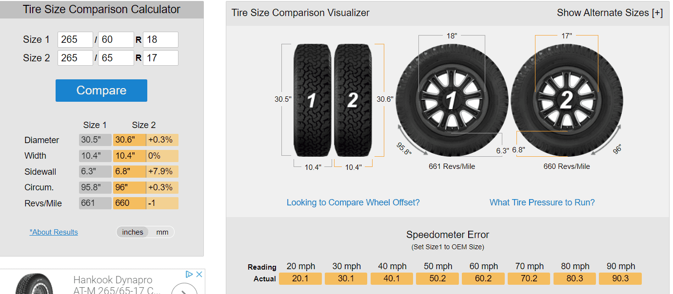

The spare's tire is a taller sidewall (65) than the stock (60). No issues, but heed the warnings on the spare.

They are as close as you can get in 2 different rim sizes. Overall circumference 95.8" vs 96". Not enough to cause harm.

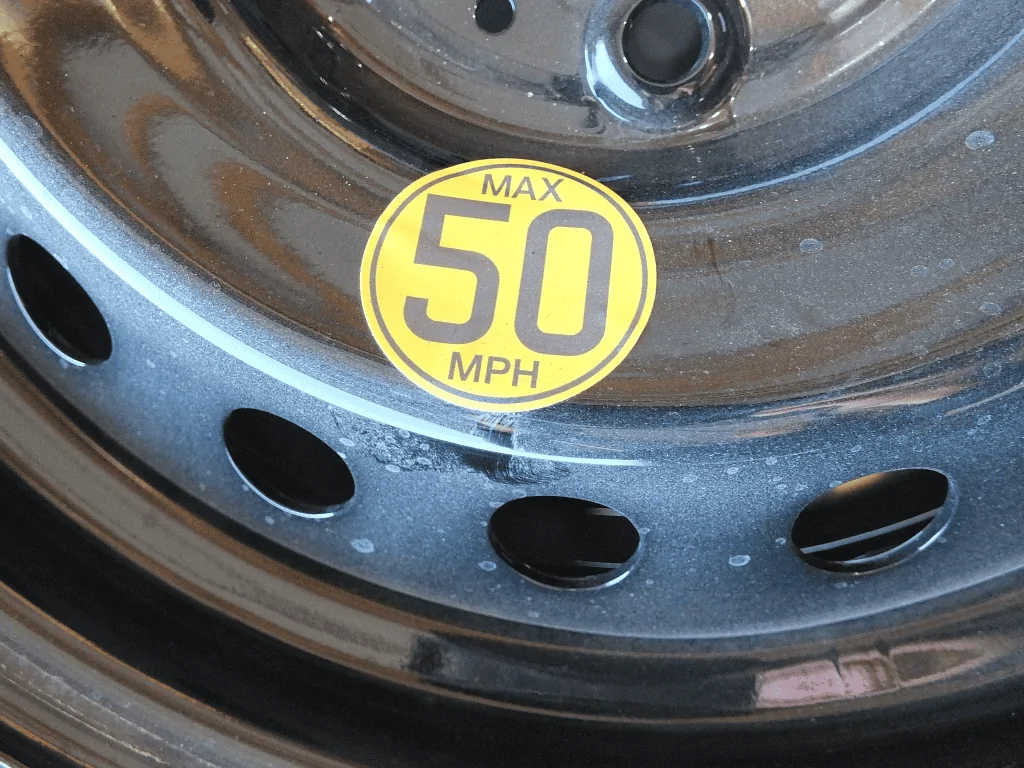

It states right on the spare tire not to run over 50 mph. Also states that in the Owners Manual. But I researched the tire, and the wheel. Both are regular production units. The tire is no different than what you would buy and the wheel is the same that comes on all four corners of a XL Ranger.

That must be a Ford CYA thing.

As others have indicated, wheel diameter is not the big consideration here, overall tire height is. There are plenty of sites to help you with this. Here’s one...https://tiresize.com/chart/
I haven’t looked it up but I‘m pretty sure the height of 17” and 18” Ranger tires are very close, otherwise, they’d be re-calibrating speedometers based on trim level or options. This allows Ford to use the same spare on all Rangers. Sounds odd but it works for them.

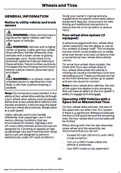

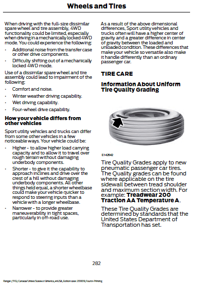

Sure, that's solid advice in the case of a rear wheel drive vehicle, but on a 4x4 both the front and rear have open differentials.
Is there something, mechanically, about the front differential that makes it tolerate the tire height difference "better" than the rear?
If that was the case the Owners Manual would specify this... and it doesn't.
