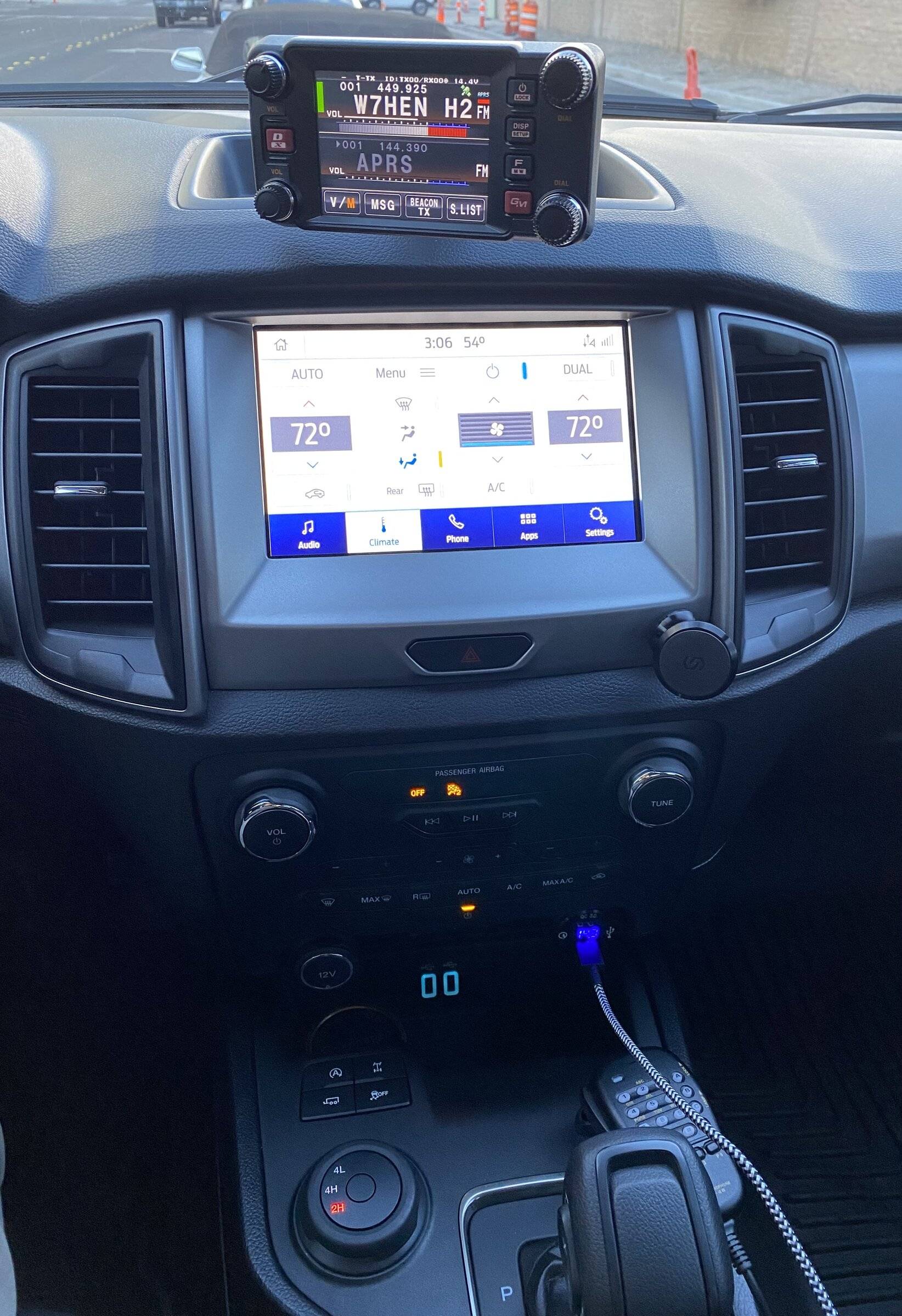

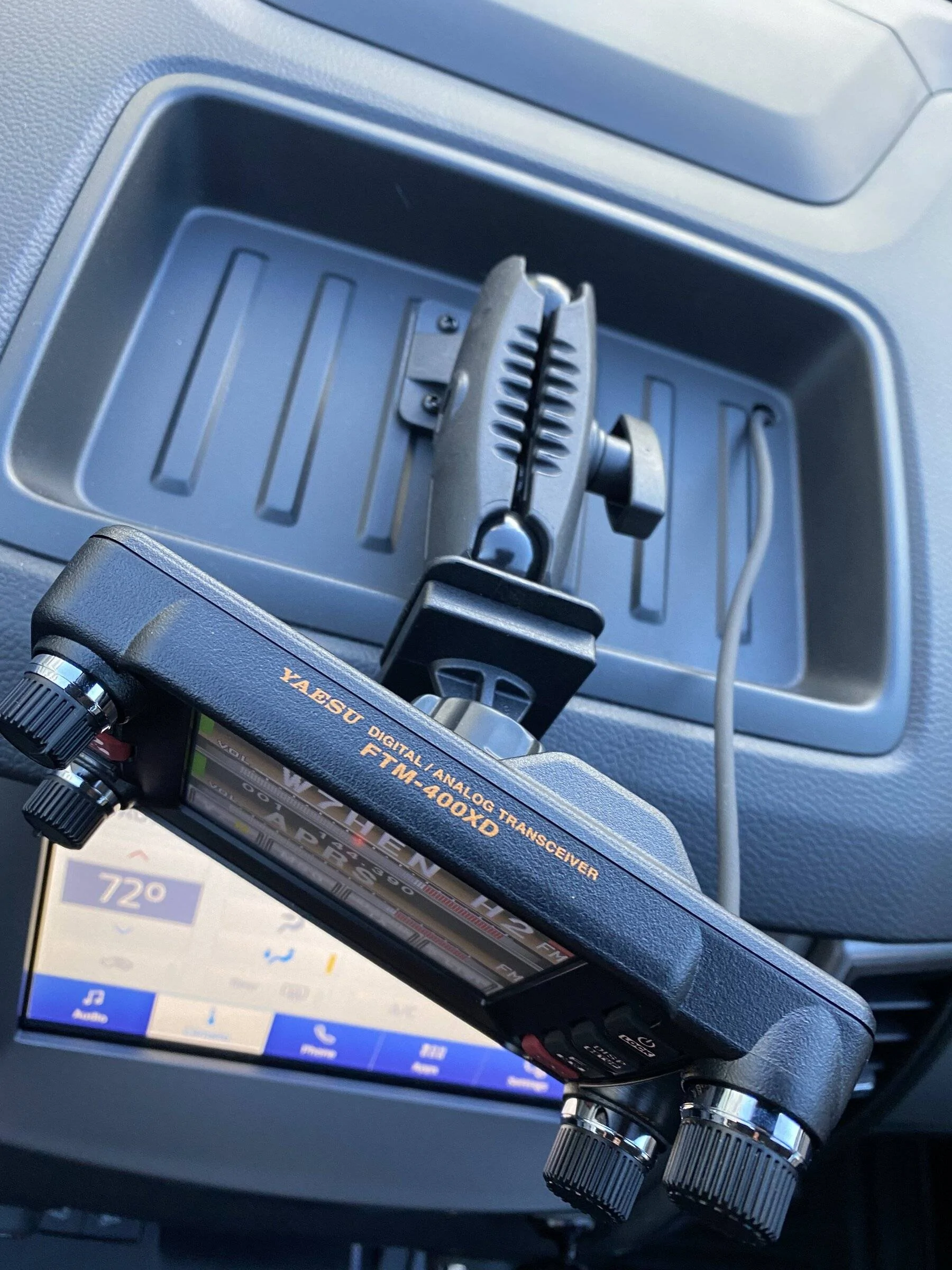

Here’s my FTM400 mounted inside my Ranger
How do you like that FTM-400?
I've been reading the specs and it sounds like an impressive unit.
I love it. I have two of them. One in my truck and one in my shack. Does APRS too and does it really well.
