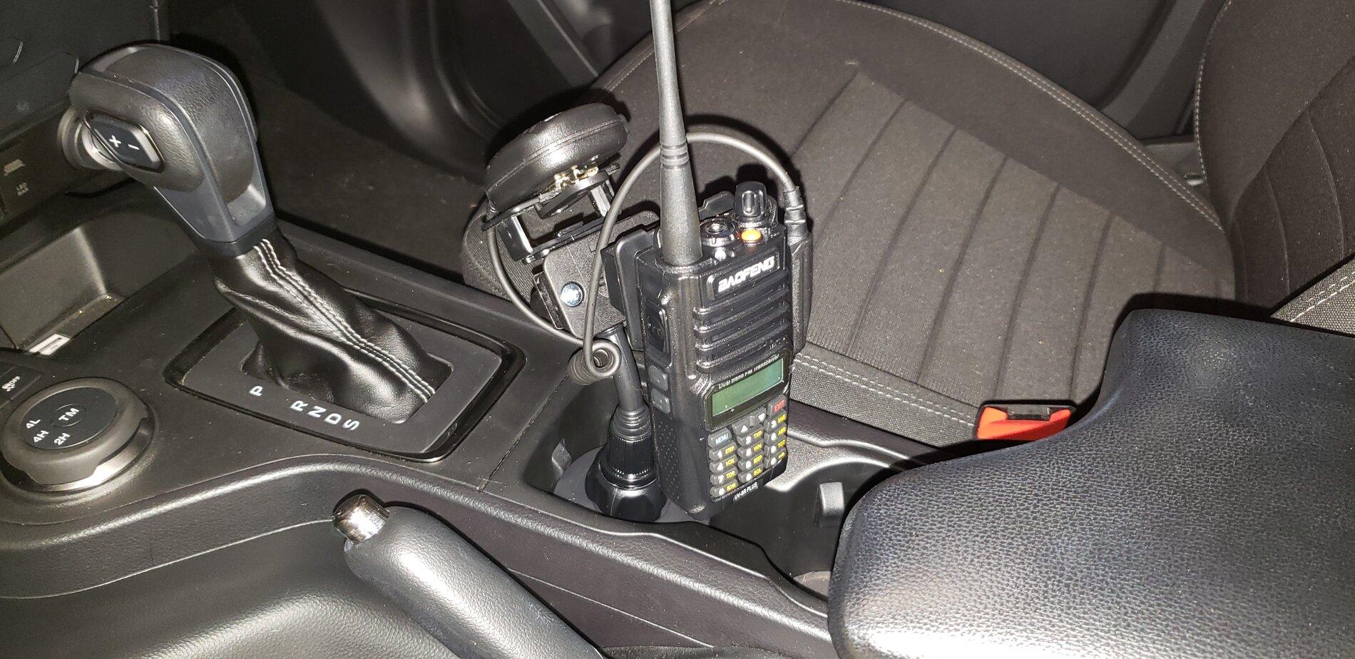

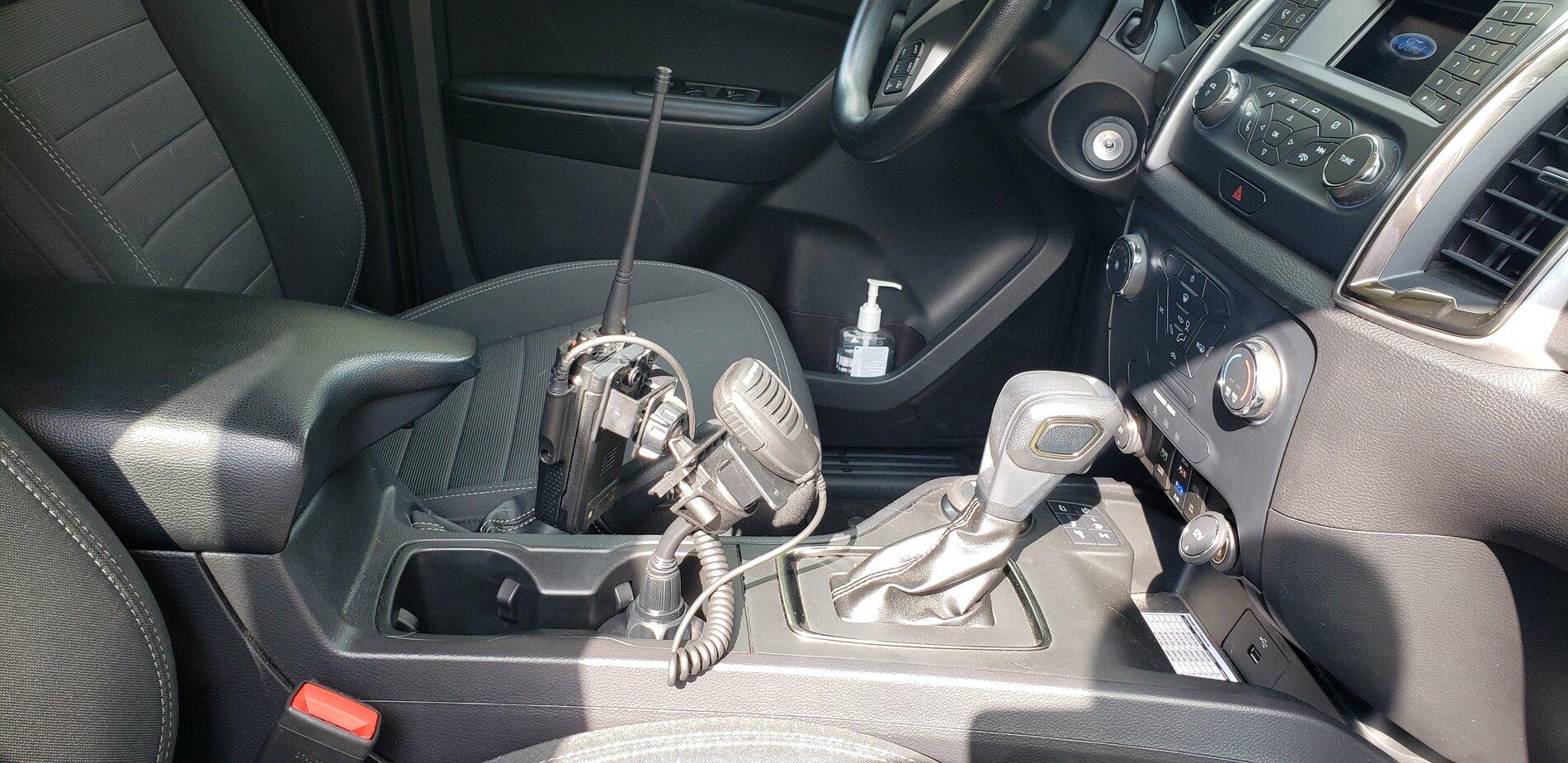

I cut off the PL259 connector and used a wire insertion tool to pierce the rubber boot on the passenger side firewall. Here is what I used for my setup...

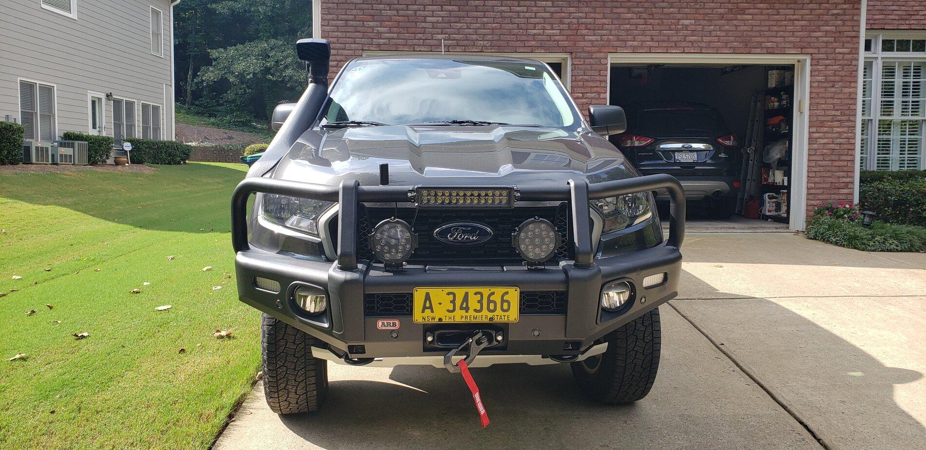

(These pic are from before my antenna cable was run. The antenna is mounted to the push bar and is just a stubby. I ran an additional line this past weekend for a CB radio antenna to be mounted up this week.)

My antennas are mounted on my front push bar. I pierced the rubber boot from inside the cab, and then pushed the RJ58 cable with the PL259 connector cut off through the business end of the tool into the cab. Once you get enough into the cab to pull it through, you can pull the wire insertion tool out, and off the antenna cable, and then route your wire wherever you want in your cab. You'll have to solder on a new PL259 connector though.

Bite the bullet and get the ARB Summit bumper like I did. LOL
Or I think I've seen ditch light brackets with antenna mounts!
