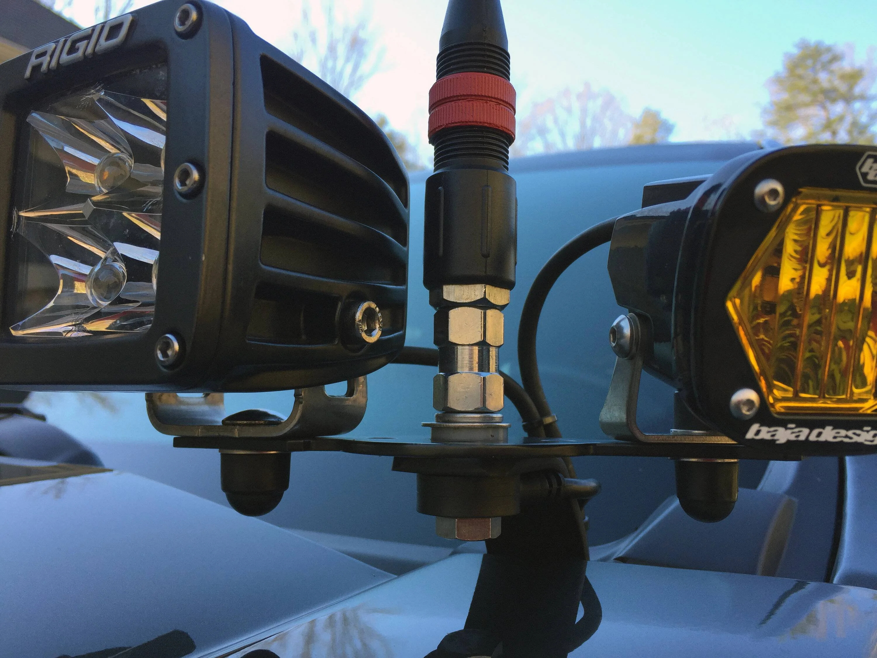

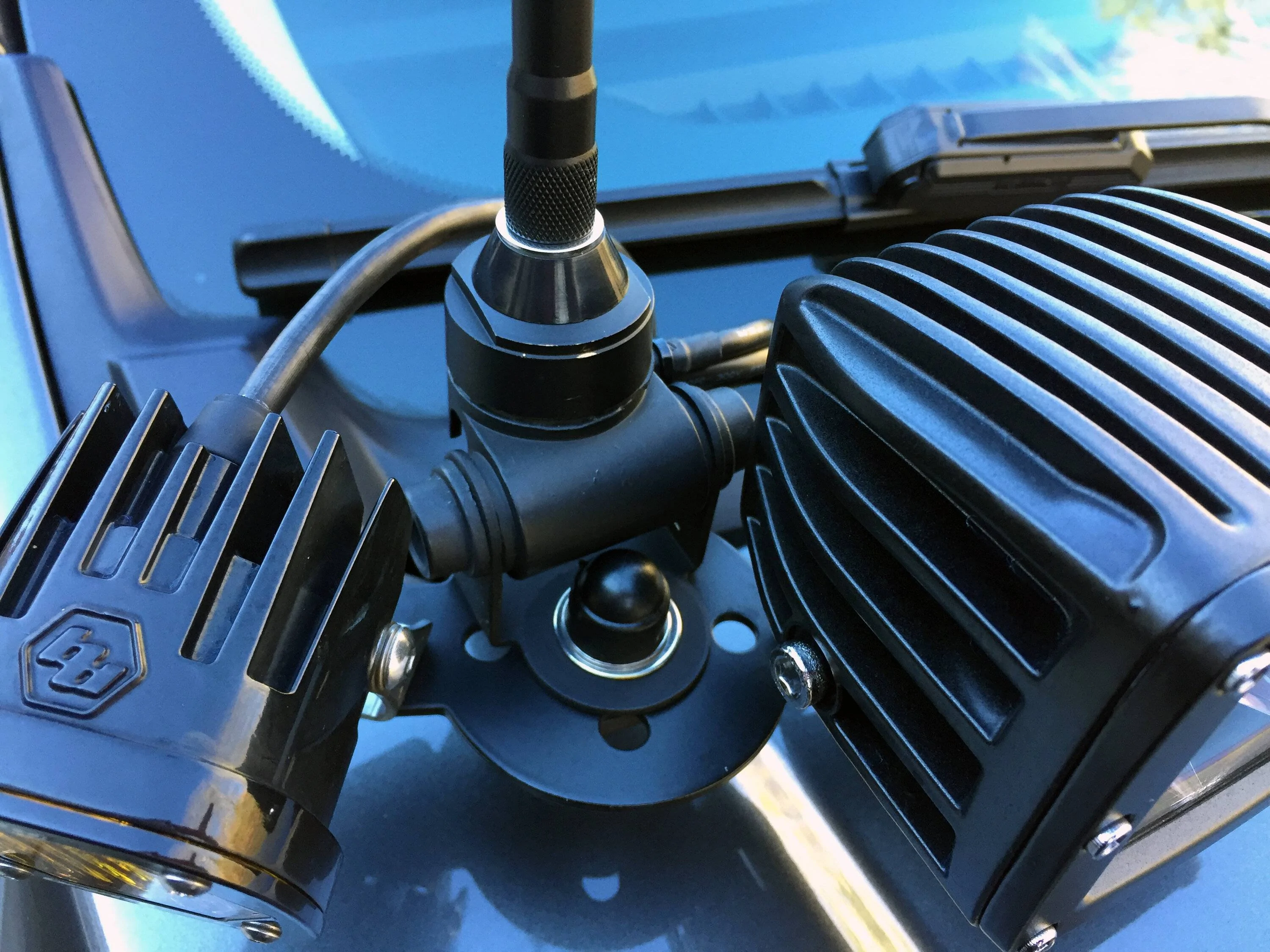

Ended up buying a ditch light mount and mking the hole a little bigger for my antenna mount.
Thanks Misfitoy for the suggestion.

That one serious looking antenna...how does it work and why is it so thick?

It's a Yaesu ATAS-120A antenna that I use with a Yaesu FT-891. It a screwdrive type antenna. Works very well with the FT-891. When changing freq. just hit the tune button on the radio and the antenna adjust the height for good SWR. Just have to make sure the antenna is well grounded.

The antenna goes up and down?!?! Looks like a GIANT vax needle...?

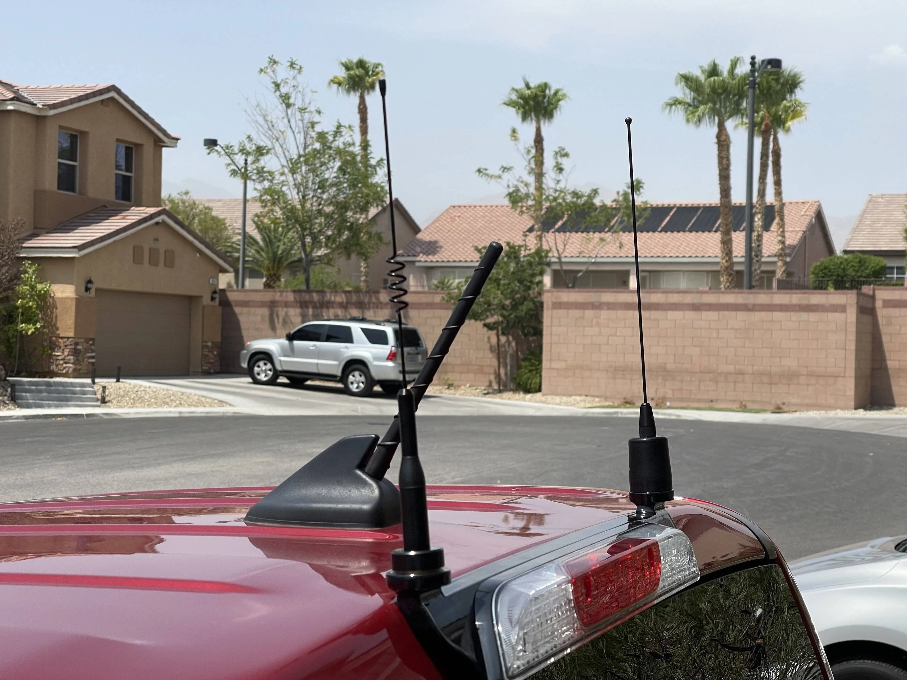

I’m using the Bulletproof Diesel option. One antenna for GMRS, the other for monitoring air traffic.

I'm actually curious why you monitor air traffic

I used to be a pilot, and aviation’s an interest. But the real answer is that I’m a nerd. Why else does anyone do anything with a radio, really?
