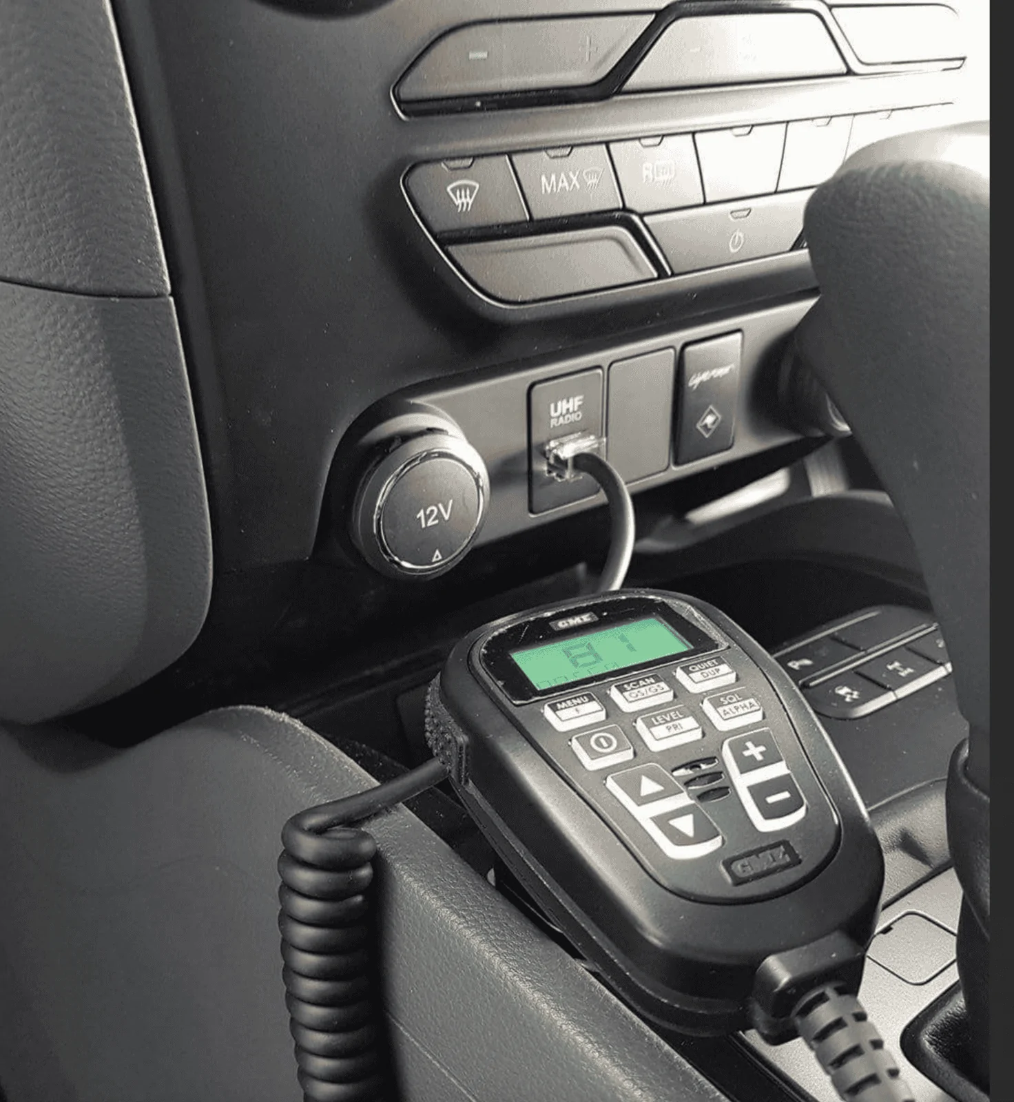

(https://www.ranger5g.com/forum/threads/aftermarket-fascia-bracket-for-auxiliary-switches.1467/)
I e-mailed this co the other day [ the one with the fascia and inserts] and as you surmised it seems that it will work just fine. they sent several pics and one caused me to remember your thread re: CB radio mounting. now I know that your connections are coax but they have switches and blanks that you could work with to make the whole install very neat and clean
