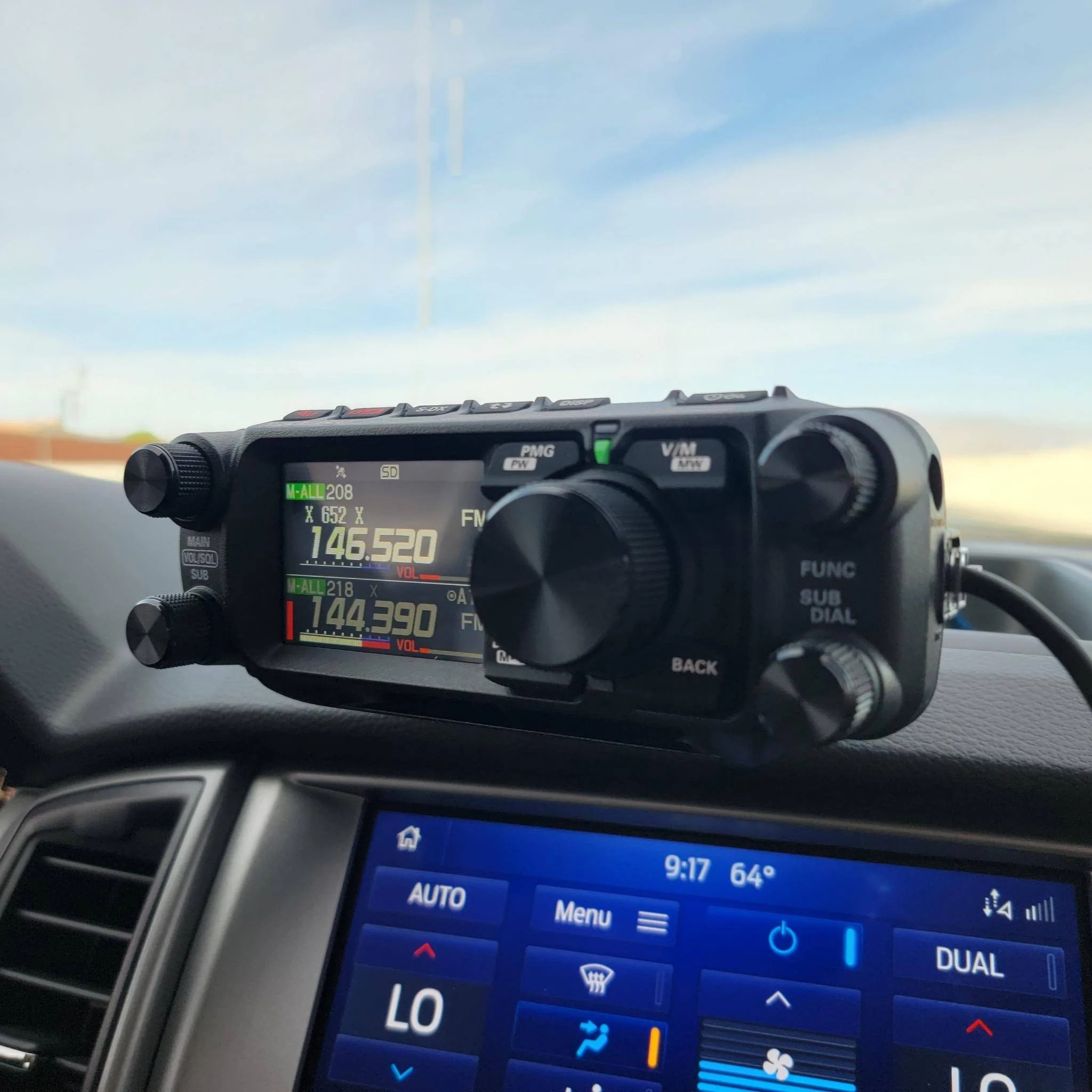

A Yaesu VX-8R will do all four bands. It’s listed as a triband, but it’ll do 220 also at lower power. Have to be specifically the R model, it’s the first generation and the specs were changed when they released other generations. I think they’re about $350 used if you can find one.

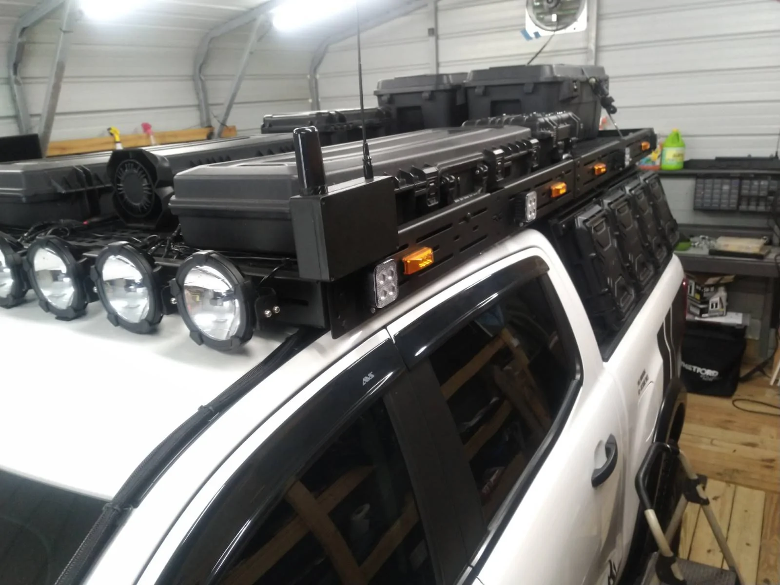

I went full commitment and did a permanent mount. I drilled directly over the second row dome light, so I can access the mount without disturbing the headliner. Going to remote mount the radio behind the rear seat, with the faceplate in the tray on the dash. Also installing a Lightforce fascia with their UHF jack to plug the speaker mic into, and a Magnetic Mic mount. Will update as the install progresses.
Currently running a Larsen NMO 2/70B. Looking for something shorter with a spring for every day use.
-KD1TRE
Was it a PITA to run the coax? Any insight lessons learned would be appreciated.
I’d prefer to do the same as you.

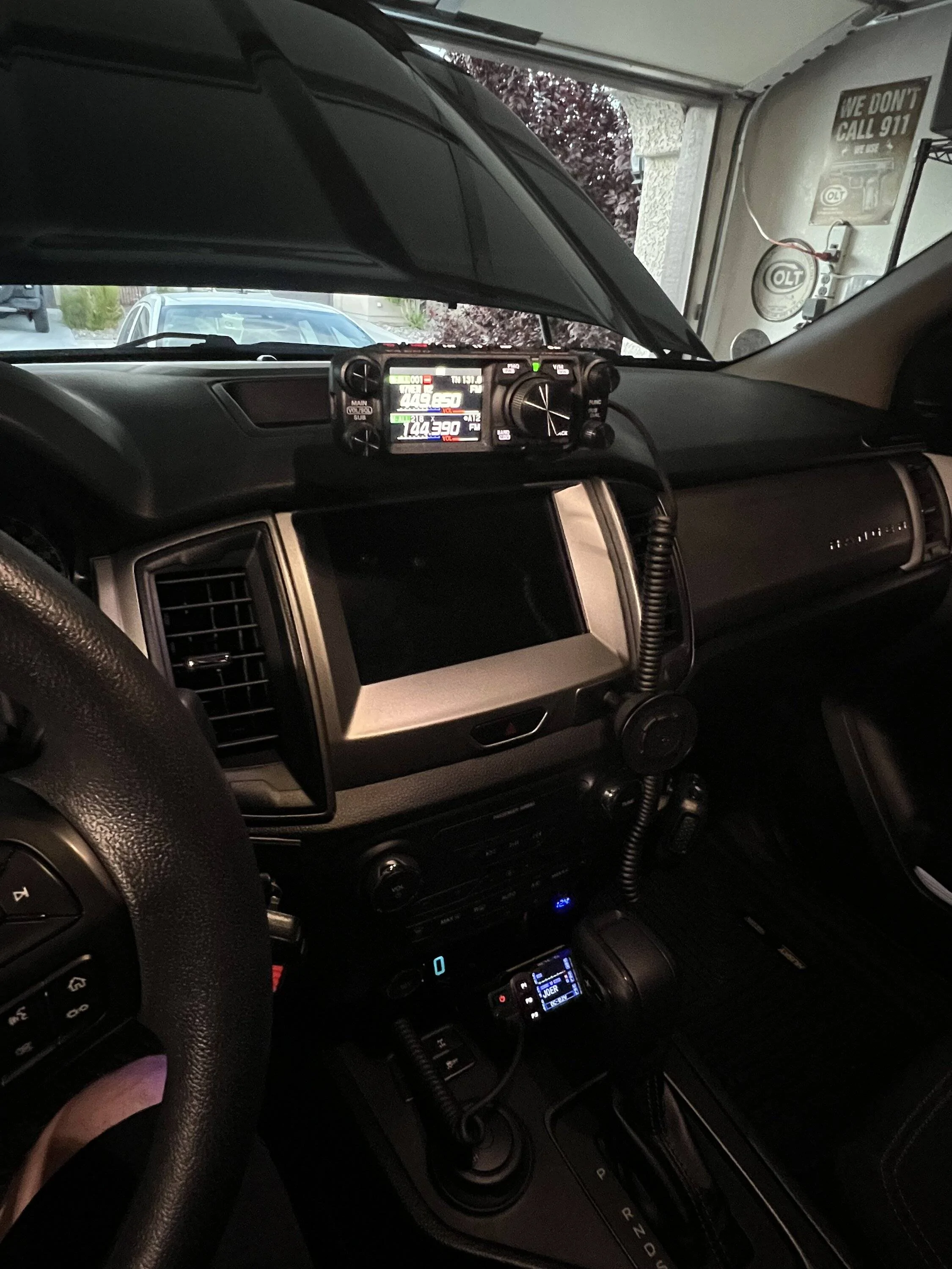

How do you like that FTM-400?
I've been reading the specs and it sounds like an impressive unit.
Who makes that bracket? (and where did you get it?) I have a Yaesu FTM400 that I removed from my Flex that is sitting in a box. I would like to reinstall it in the Ranger and I am starting to look at options.

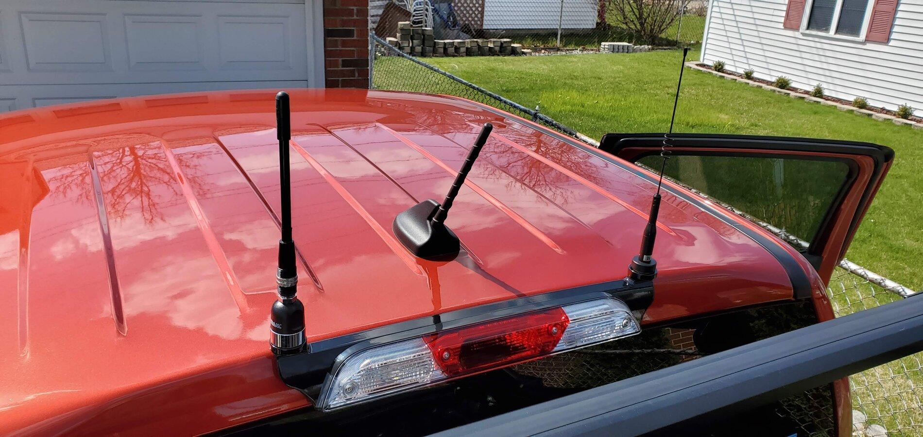

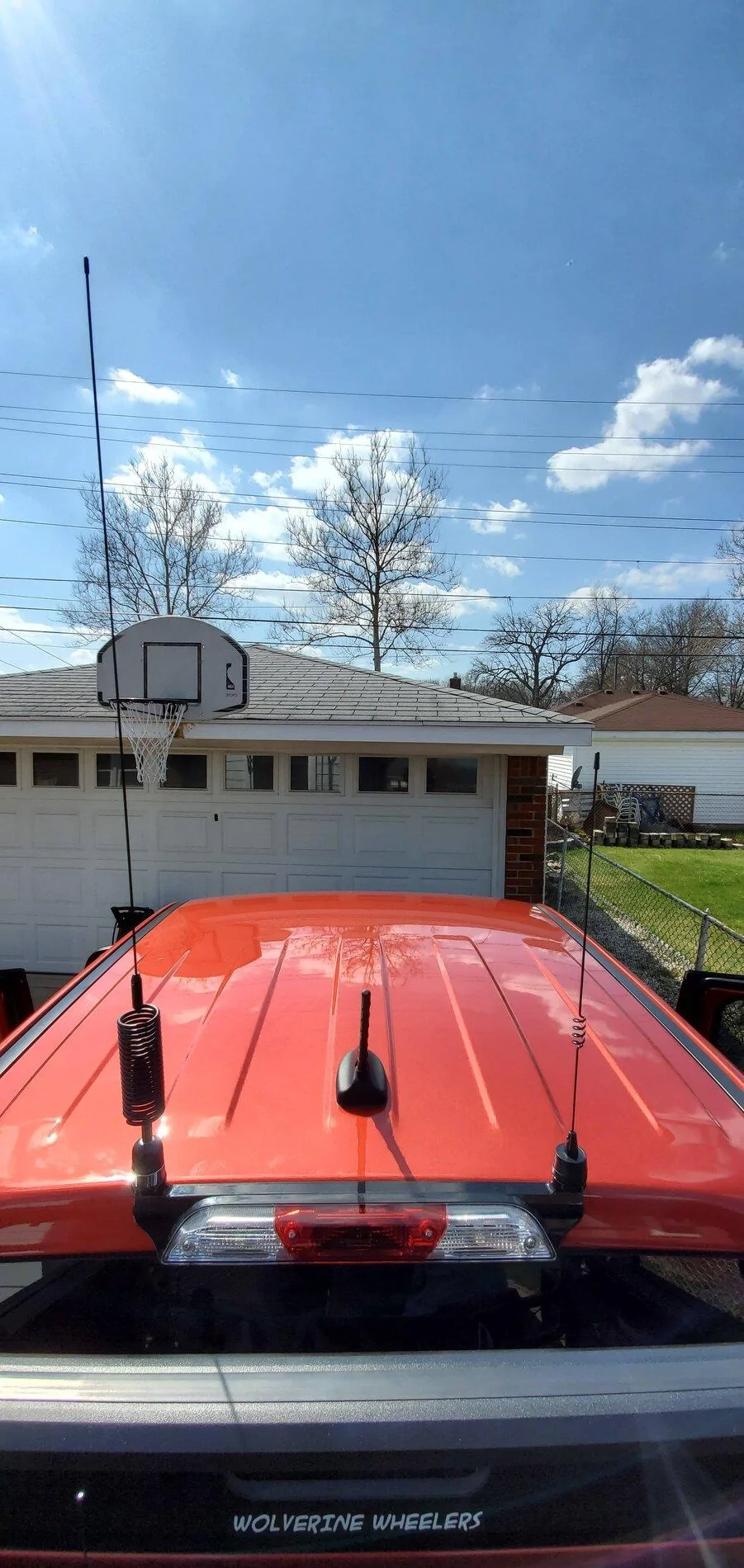

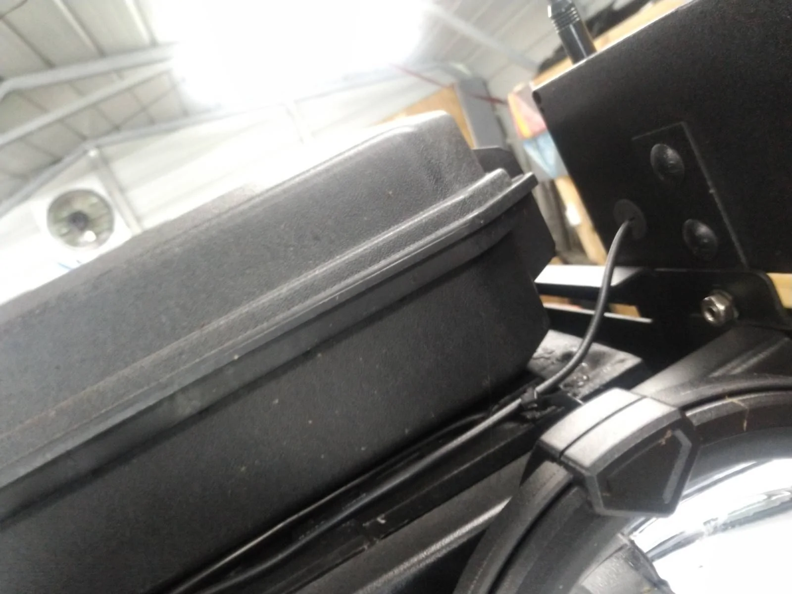

For anyone interested on the CHMSL mount that I installed, I was able to put the SWR meter on the CB radio this weekend to get some readings and do a bit of tuning! In the pics, the CB antenna is the one on the left and that was the one I tested this weekend.
Here are the two antennas (Remember, the antenna on the left in each picture):
The shorter antenna, JBC800, definitely is not the most ideal antenna for this application, but was able to tune to the frequencies that I use the most, and it is mostly used when I am just in listen mode and just to keep the overall height down. But anyways, It is set around a 2.8 SWR reading at channel 1 and a 2.2 SWR reading at channel 40. I did manage to tune the antenna down to almost 1.3 SWR reading for channel 1, but it shot 40 well over 3.0. Best I could get all around was near a 2.5, but I have a tendency to use higher channels, so I skewed the SWR to the higher side. When I checked the channels in the mid range along where I normally run, channels like 10, 19, 20 , 33, etc, the readings were much better and around the 1.4 to 1.8 SWR reading mark. SO as mentioned, this antenna is not ideal for range and transmitting applications, but for the receiving, it does just fine, and for the short height of it, it does ok.
Now for the longer antenna, Mini Stinger Springer. This antenna I will use when I will be more heavily transmitting, longer trips, etc, when I really need to rely on the antenna and radio. This one is also a bit harder to adjust, so I was hoping this one would measure good...and it did! I checked channel 1, and got an SWR reading around 1.4, and then jumped up to channel 40, and got an SWR reading of around 1.5. I did do some quick checks through random channels throughout the entire range also and the readings were very good. I am completely happy with the reading that I got on this antenna, so I would recommend this antenna for this application.
As an additional note as well though, I think something happened to my SWR meter as well which was causing it to skew the numbers a little higher and that is that the resting needle position was around 1.3-1.5. I tried to move the unit around and what not, incase it really just wanted to site perfectly level, however the needle was always skewed high. So this does lead me to question if all of my readings are a little high. I can't say for certain, but I am pretty confident that if anything, the numbers are better than what I received on my meter.
I'm starting to look into reinstalling my Yaesu FTM-400XD. I like this installation option (wow, a lot of $$$ though!). Any concerns with overloading the front end of the AM/FM, Sirius or GPS? It's in close proximity to the ham antenna(s). I'm more concerned about permanent damage, I wouldn't be having the AM/FM on during TX. Thanks, and 73's Greg KE8DAF.
Thx,
Greg
That's not my setup.
@VegasRanger can give you the details but it looks like a Ram mount.
