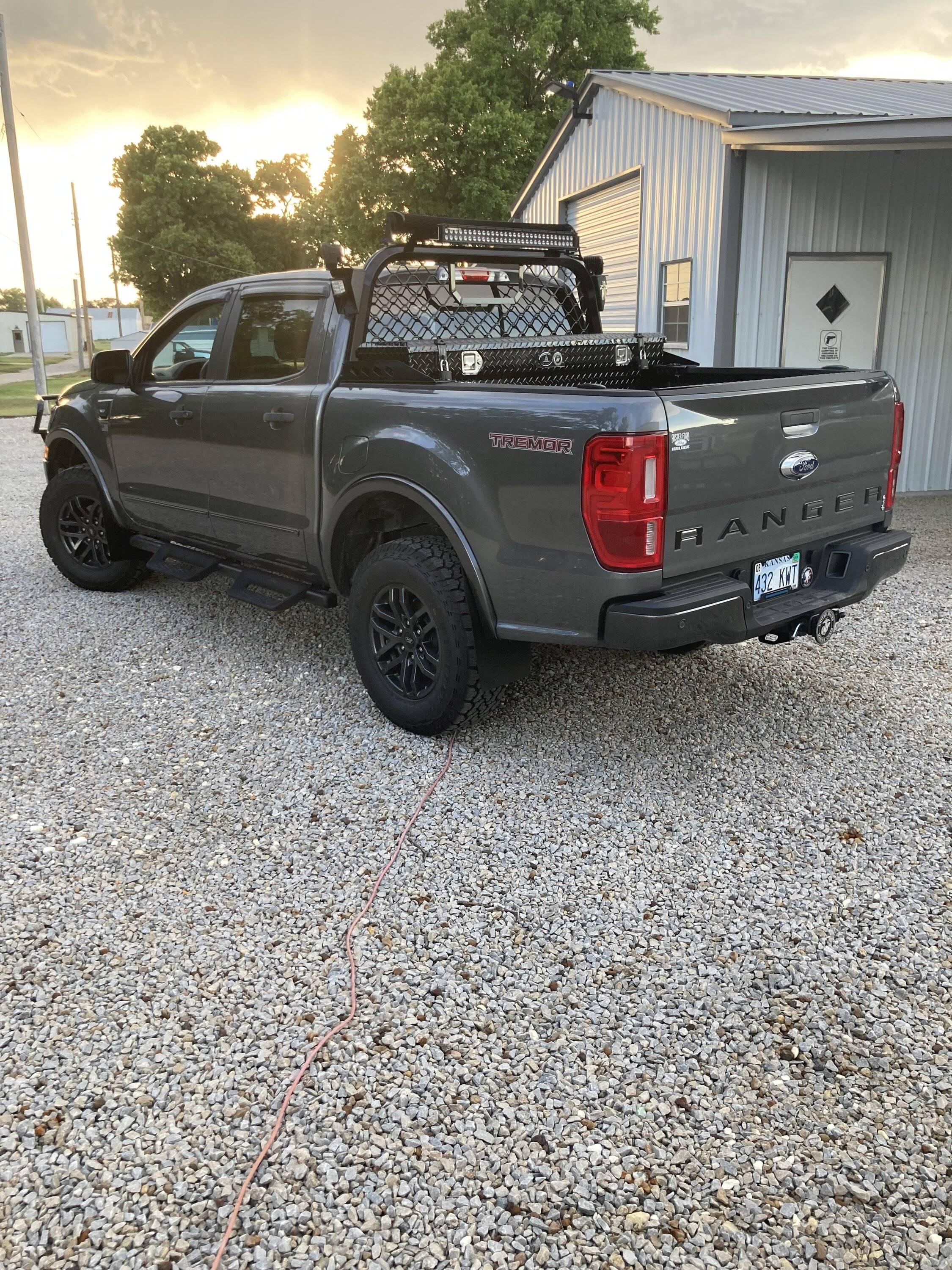

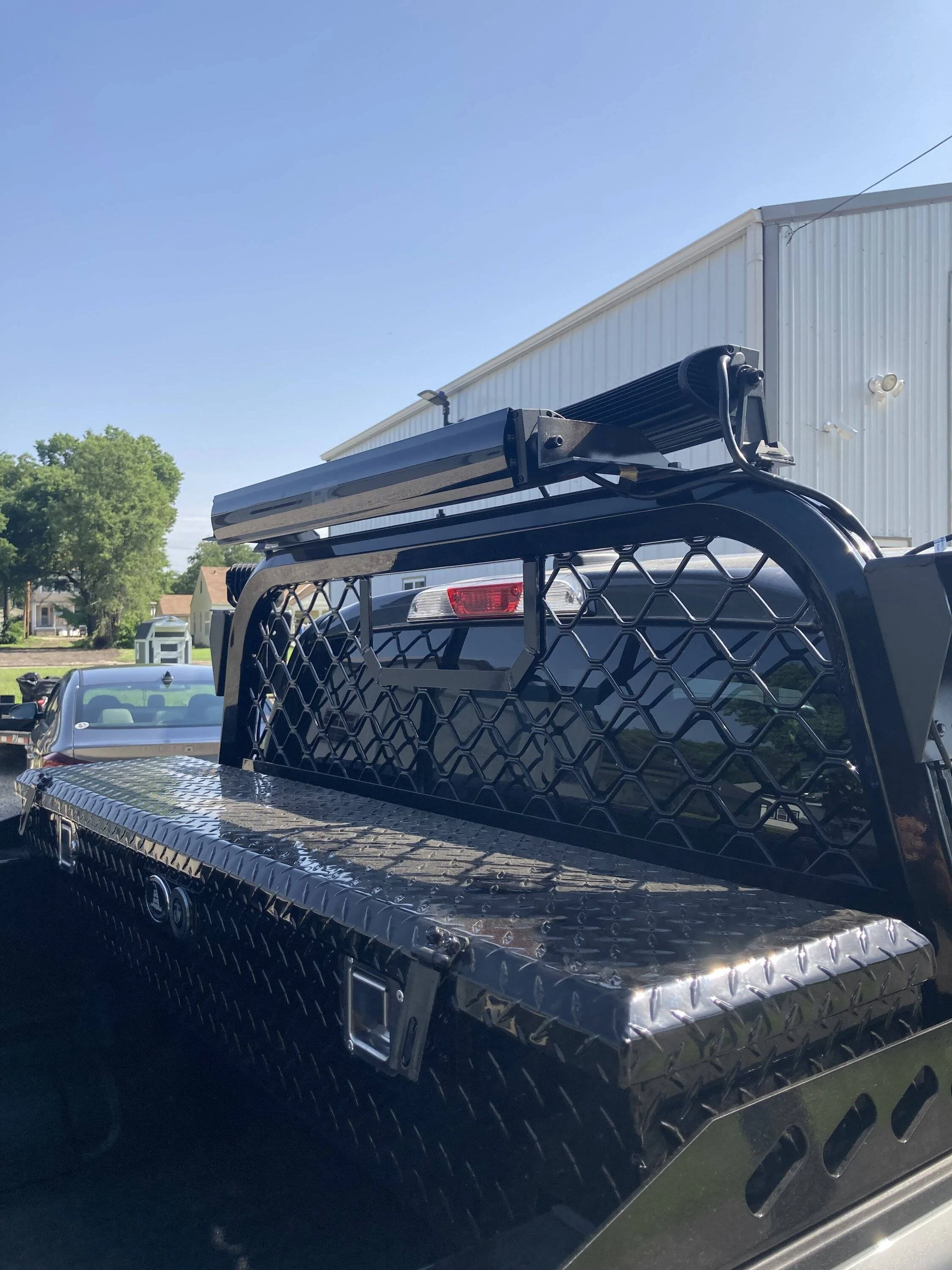

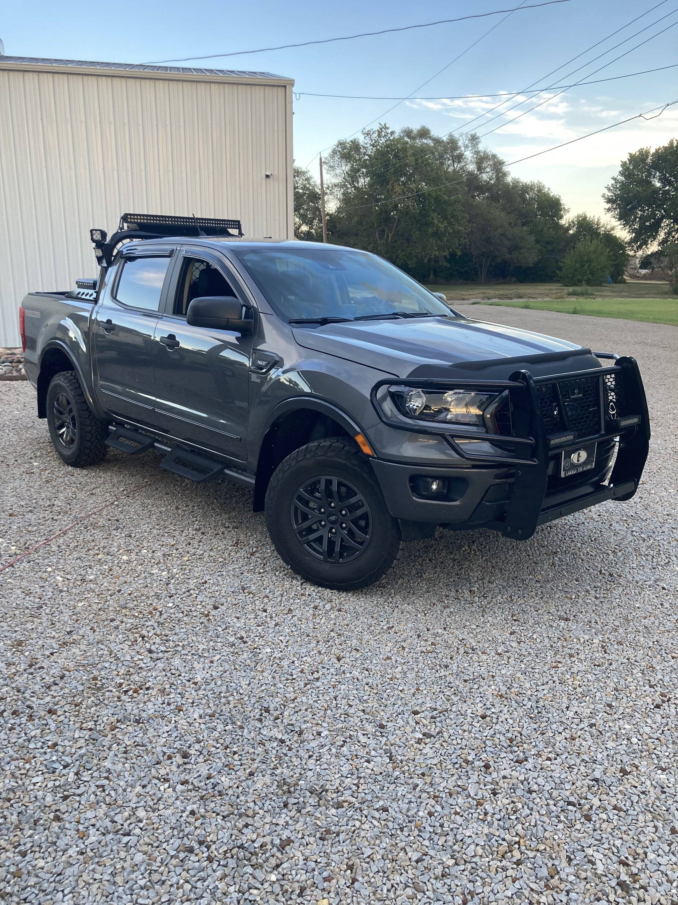

Does anyone know if I can wire the 40 inch Rough Country LED light bar to the fog light harness and use the fog light switch to operate it? If so anyone know the best way? Thanks in advance 🖐

Thanks I just ended up wiring it with the included rough country switch through the firewall.
