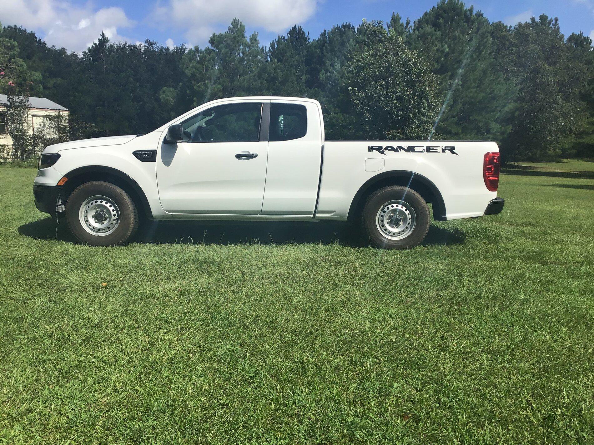

@Doc Please tell us your ride height measured at the top of the wheel arches when you post your ride test.
Both front and rear 35” to the top of the arch..I can go lower but I live on a dirt road and have to be able to get a garden hose into the wheel wells ...
