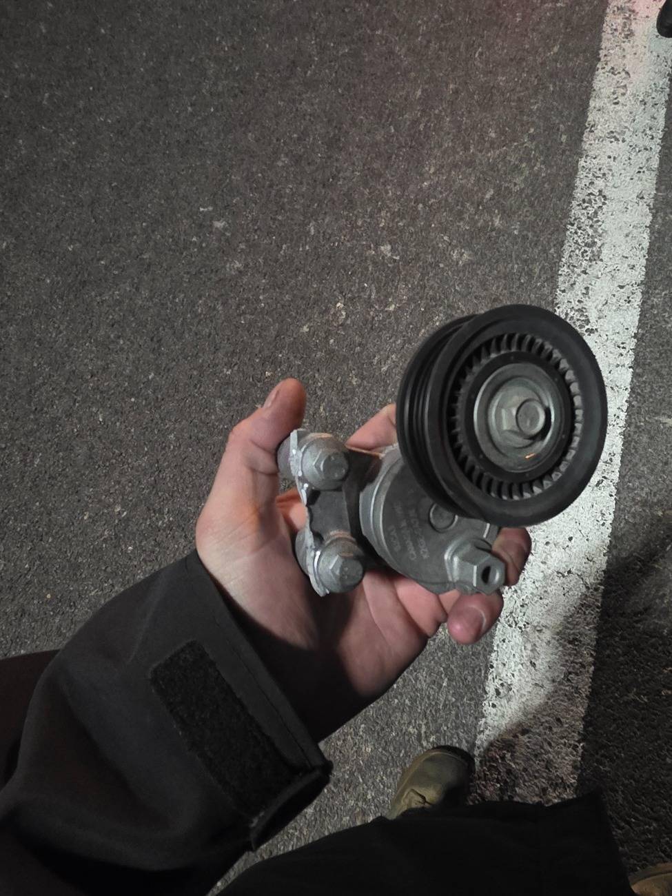

70k, tensioner belt literally broke off from the engine block...the belt was fine, the water pump was fine, Ford Extended Warranty...says...NORMAL!!!

I still think he described this failure where the tensioner actually breaks off a chunk of the front cover. And there’s nothing wrong with the tensioner. It’s happened quite a few times and all have been 2020’s. It has been and should be covered by the 5/60 powertrain warranty. Probably could get it covered if OP had this information and a bit of perseverance as you described.

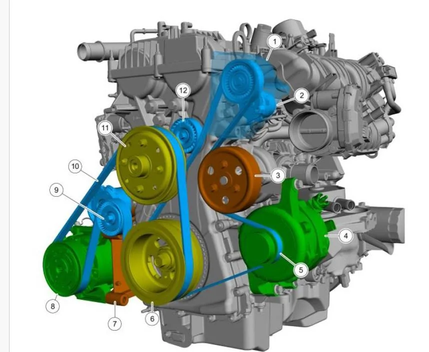

I think the ROOT issue is a bad pulley bearing causing the tensioner to flex (rock).
Most likely either the Idler Pulley (#12) or the Tensioner Pulley (#2), so far the Water Pump (#3) and Alternator (#4) have been reliable and not many reported issues with them.
So the constant flexing (rocking) of the Tensioner stresses out the mounting points, be it poor design or manufacturing mold issues - it eventually lets go.
Poor Design is for sure, there needs to be a stronger support bracket to absorb the stress on those mounting ears.
Yes - Belt Tensioner = Normal Wear Item
No - Breaking off at the mounting points is NOT NORMAL, and is a design flaw and or manufacturing flaw
