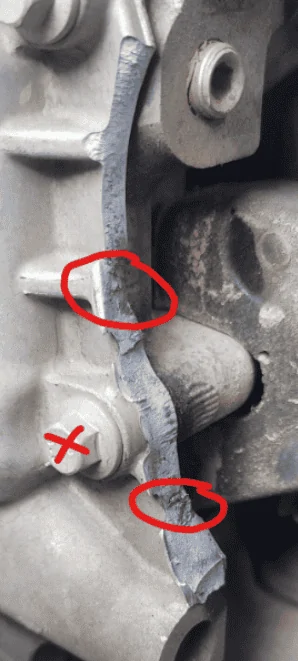

I got to thinking about this timing chain cover failure again, and I have to ask, when these failures occurred, why hasn't Ford simply installed the alternate tensioners used on the iterations of the 2.3L in other Ford platforms. Replacing that cover is far more expensive then replacing the tensioner. A poorly designed ear broke off that did nothing except to support a tensioner. And right there on the head is an ideal location already designed and used in countless other 2.3L ecoboost engines with ZERO failures reported over nearly a decade of real world use.
It is there. It has a proven reliability record. It is far less expensive repair.
Bureaucratic inertia? We can't do that, it the wrong part number! We didn't make it for the Ford Ranger, you must use the part we designated for this vehicle. If we do that, we'll have chaos! Think of the lawsuits! Our supplier will be unhappy.
What's the real reason?
Whatever it is.... somewhere, common sense got flushed.
