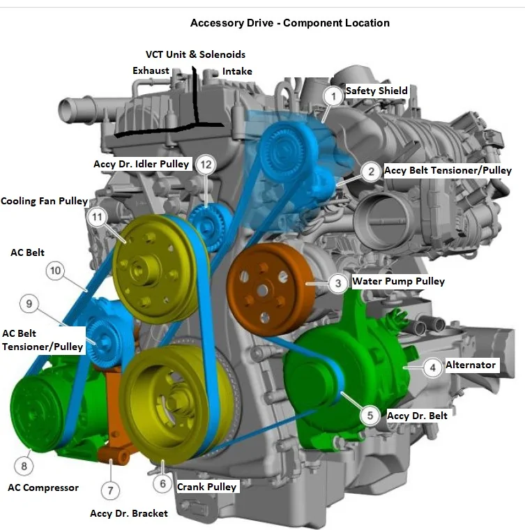

Probably the best way to answer the (Spring Load) question is to compare the 2.
I would be interested in - Spring Rate (Belt Installed)
a. How much force does it take to begin moving the tensioner (Pre-Load)
b. Force at Half-Way Point
c. Force at Full Rotation
Test would be easiest with old school (Beam Style) T-Wrench as you can view the full travel torque.
You can do the same (bench test) but I feel the actual installed test would be the most accurate as you are actually measuring (Operating) position and what the tensioner forces are as it absorbs the belt rotation (flex)
May not be the most accurate way to check the difference, but it will at least get a close approximate difference (if any)
So far it (APPEARS) they are an exact match and the only difference is the way they mount, but we should at least check if there is a difference, no one is reporting any issues - (Belt Walking etc) so this tells me the pulley alignment is still (In-Line) for me this is the most important and the tension load a secondary concern and with no one having issues with belt slipping or squealing etc - they must be close or the same.
With the install - I would not install spacers (washers) at the new mount points and I would not grind away on the (Timing Cover) - slight modifications to the new tensioner (body) only, this is an expendable part and much easier to replace over the timing cover or mounting lugs for the new tensioner.

AI - will squawk it - as it is not a (Ford Approved) swap and is basically an experimental swap at this point
So as long as - belt tracking (alignment) stays true, no belt walking or shredding and the new attach points (are unaltered) shear loads then it boils down to the belt tension as the only factor (is it stronger - weaker or the same) as in the overall operation this affects the other associated pulleys and the constant load applied to them
So are we adding extra stress (tension) to the other pulleys?
This would be the (Unknown) at the moment, yes its most likely ok, but it would be a great test to find the answer so we have a known difference if any.
