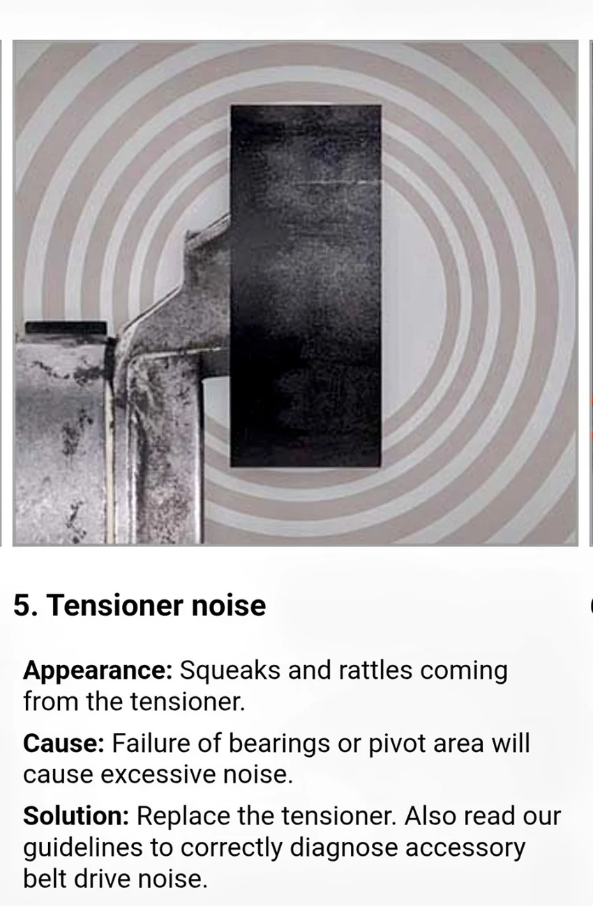

An interesting link showing what to look for.
Signs of Belt Tensioner Failure (Rock Auto)
This was not a tensioner pully issue, but a poor quality bracket issue. The pully, even after being snapped off, spun freely and no binding. The belts had zero wear on them and neither the serpentine or alternator belt were broke. The serpentine belt was kinked from being wrapped around the fan, but other than that it was fine. There was no vibration or noise prior to the tensioner snapping. I was lucky in the fact that others had far more damage from the snapped off bracket and pully slapping around and cutting other parts.
