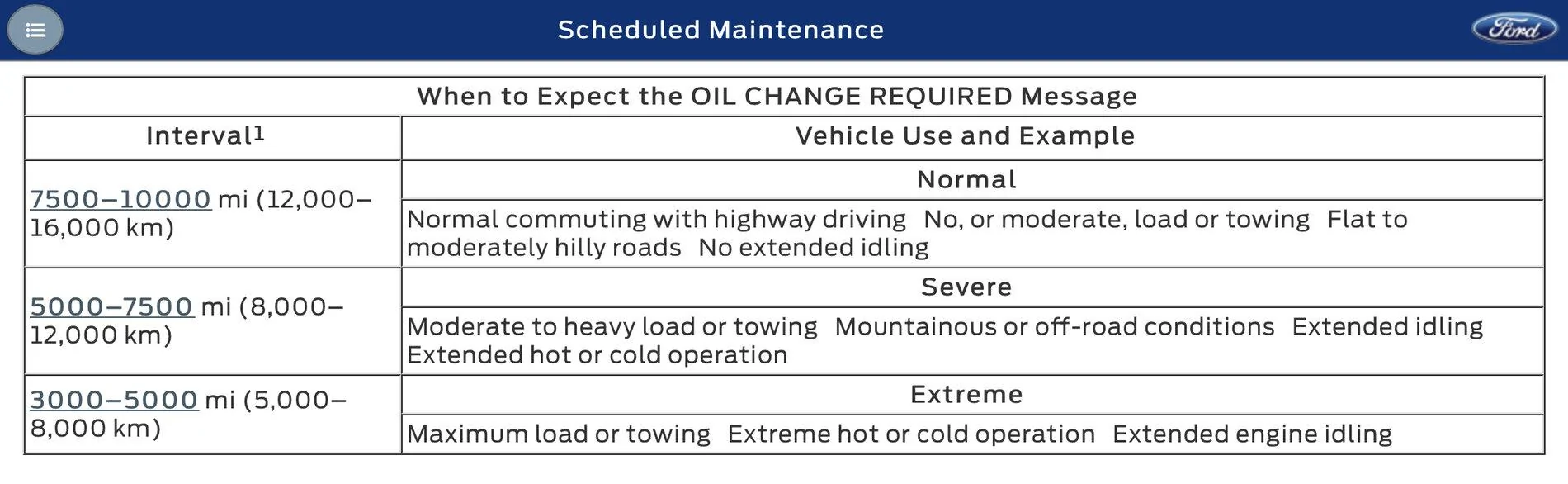

again, I'm not disputing that there is schedules for severe and extreme usage.
the thread was started based on a 5000mile normal use criteria.
Did you look at what constitutes severe usage according to Ford?
3 of my 4 vehicles most certainly meet the standard.
I don't purport to know the driving habits of all, but I'd venture to guess that many drivers who wouldn't even imagine it do as well.

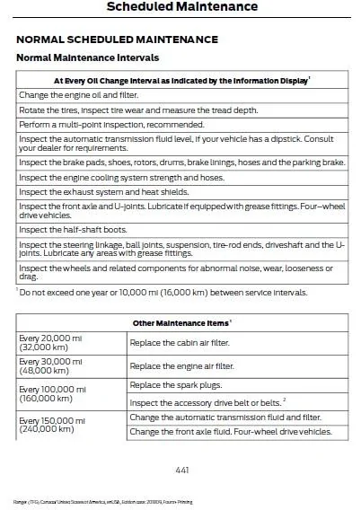

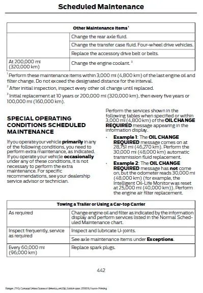

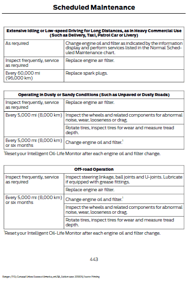

Yes...under “Scheduled Maintenance” then “Normal Maintenance”
Thanks. The 2019 Owners Manual presents the information in a different manner, not a singular chart.
