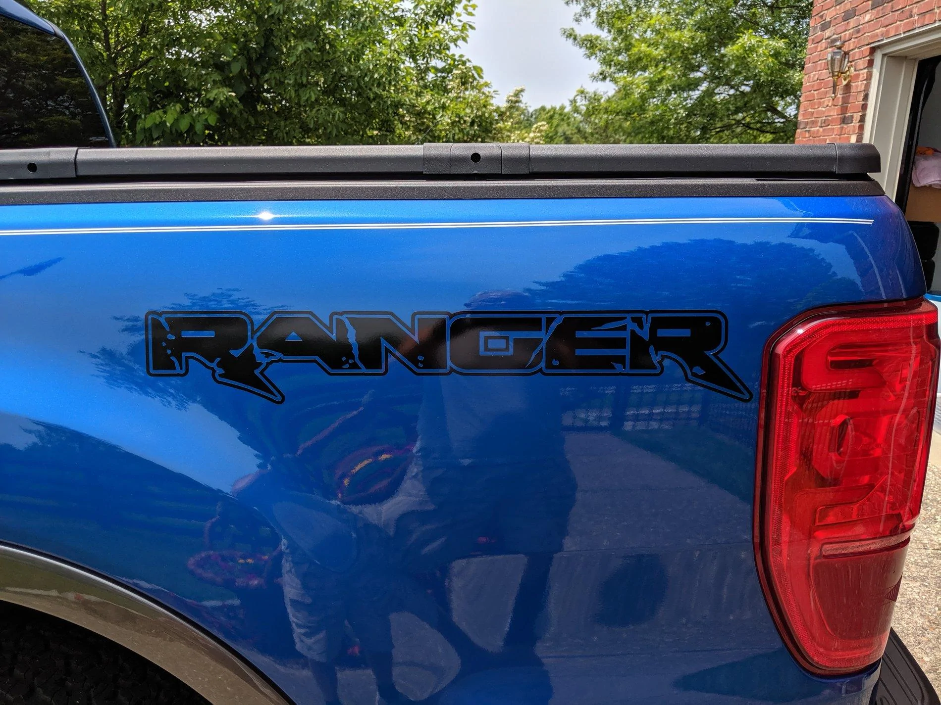

It was worth it to me. Even though I didn't like the red sticker on my blue truck. I pulled it off and replaced it.
That sticker is great! Where'd you get it?
That looks great! Not fond of the FX4 decal either. Typically I debadge all my vehicles.
