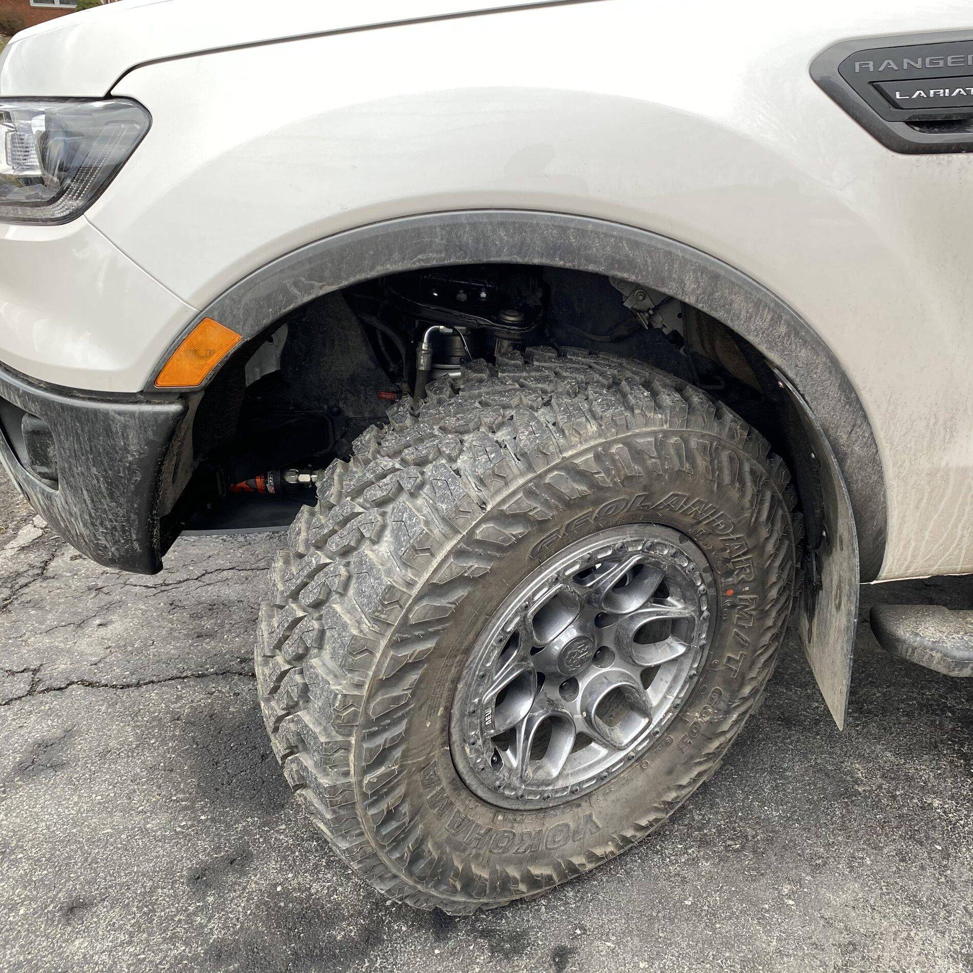

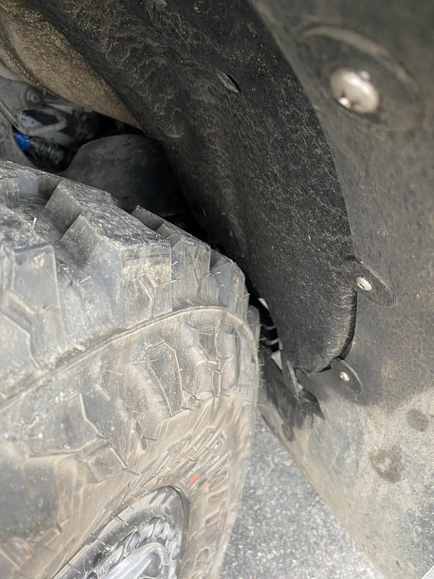

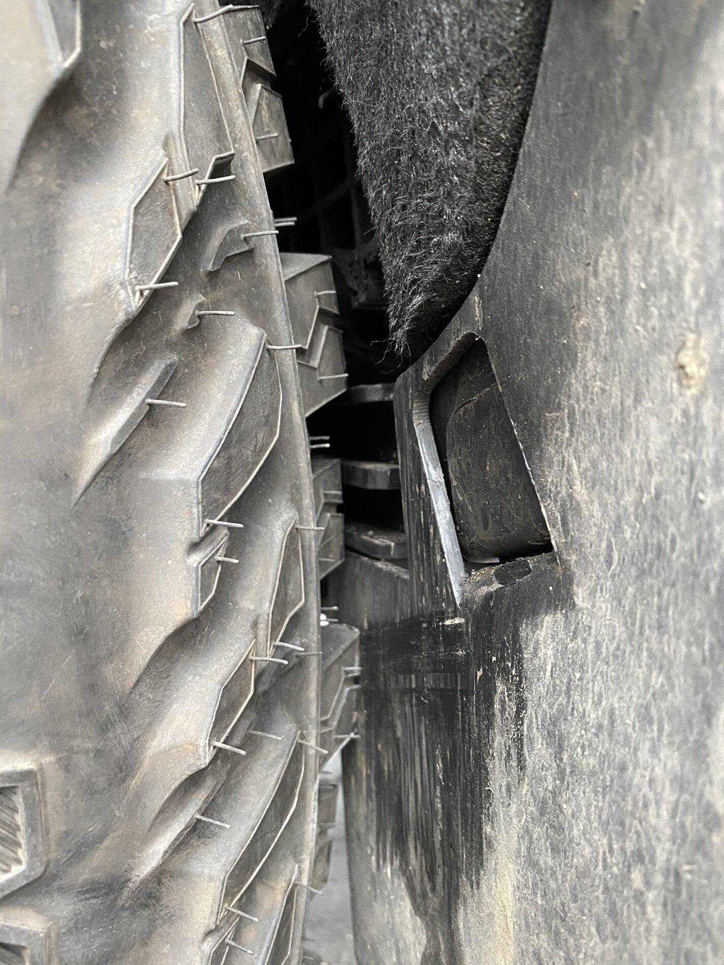

Goodluck, I'm running a 295/70R17 which measures 33.6x12.0" and its has a good bit of trimming and still rubs 3/4-full lock. My wheel is a 17x8+5mm, I have Fox 2.5 Race coil-overs, and I'm going to have to trim even more and turn the preload up some.
With +20 offset and the tire being 11.3” wide I suspect I’ll have much less of an issue. I have tons of room with the 33” KO2s I currently run, even fully flexed. Your 5mm offsets aren’t doing you any favors. 20-30 is ideal for the Ranger. I also have extra clearance up front with my warn bumper.
Not many wheels offer that offset and even so, its still less than half an inch (0.5") less than what I'm running... Also the front isn't the issue its the rear. Also what's your complete wheel spec?

I’m talking specifically the front tires will rub in the rear of the front wheel wells.
