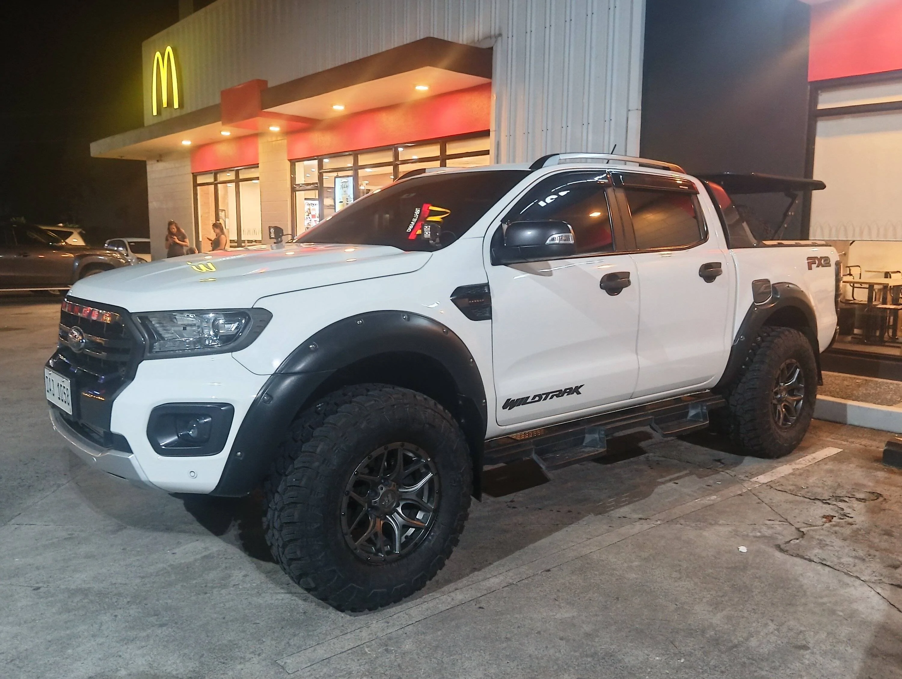

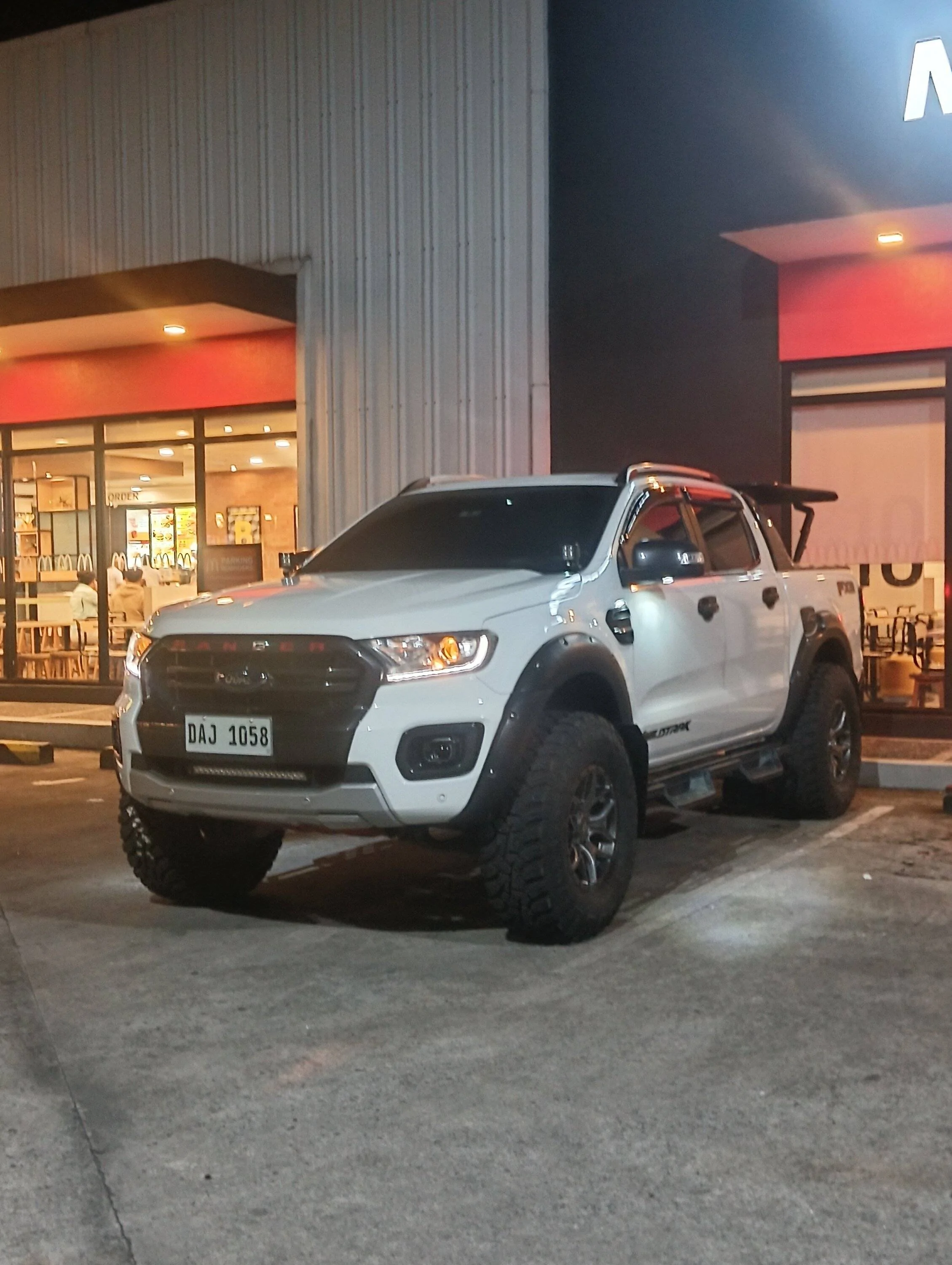

I was able to fit General grabber X3 315 70 17 on my 2019 ford ranger. Using spc adjustable upper arms that i adjusted to configuration E to clear rubbing issue (move tire forward) shocks are stock ... I just put a 3 inch label lift from fordrangerlifts.com.
9,728
46,547
Looks great Arnold - that rear platform rack looks interesting - seems you folks in Asia/Pac get some pretty cool aftermarket goodies. The integrated bumper design also allows for a proper transition on the front fender flares - unlike in USA and Canada…
A couple of flare manufacturers make a bumper extension but it’s certainly not as clean as the look on your Wildtrak. Very nice!
Yeah bro, that is an awesome Ranger wildtrack.

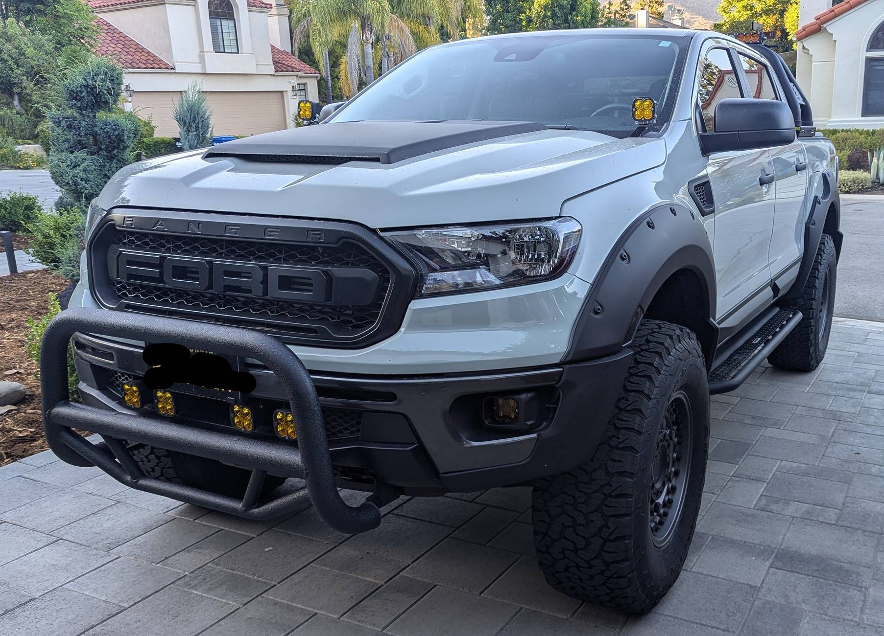

I know this is an old thread, but wanted to post that I bit bullet and replaced 285/70/17 ko2s for 315/70/17 ko2s and it seemingly fits! Crash bars had to go (even my readylift ones from before wouldnt work), waffle thing behind fender liner, and some minor cutting of the front bumper. Running eibach pro lift kit 3" front with 1" block in rear and icon delta UCAs. Wheels are BL armory 17x9.5 +6 offset for anyone wondering.
Will post pics later and still need to beat it up more to see if it will rub, but shop seemed confident it was good to go.

Here is a picture, couldn't be happier :) yes, I know mpg will get clobbered and I'll prob regret it in other ways but here we are hah.
