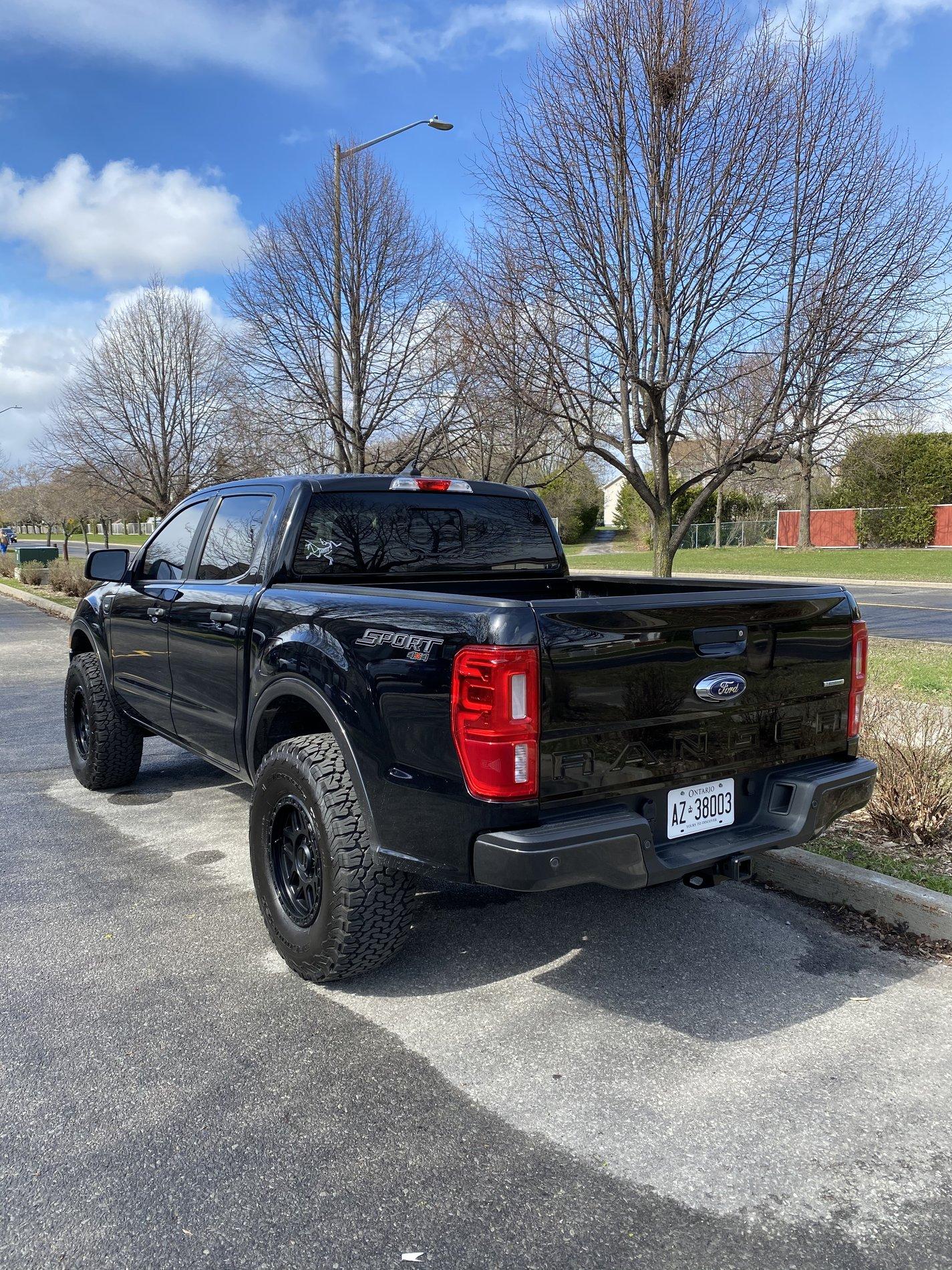

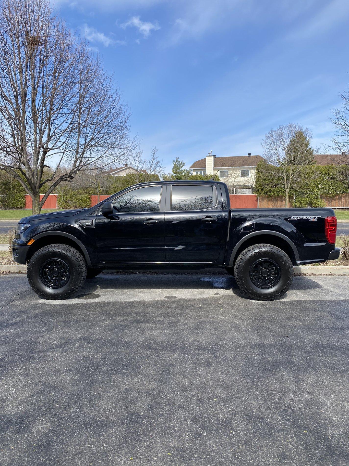

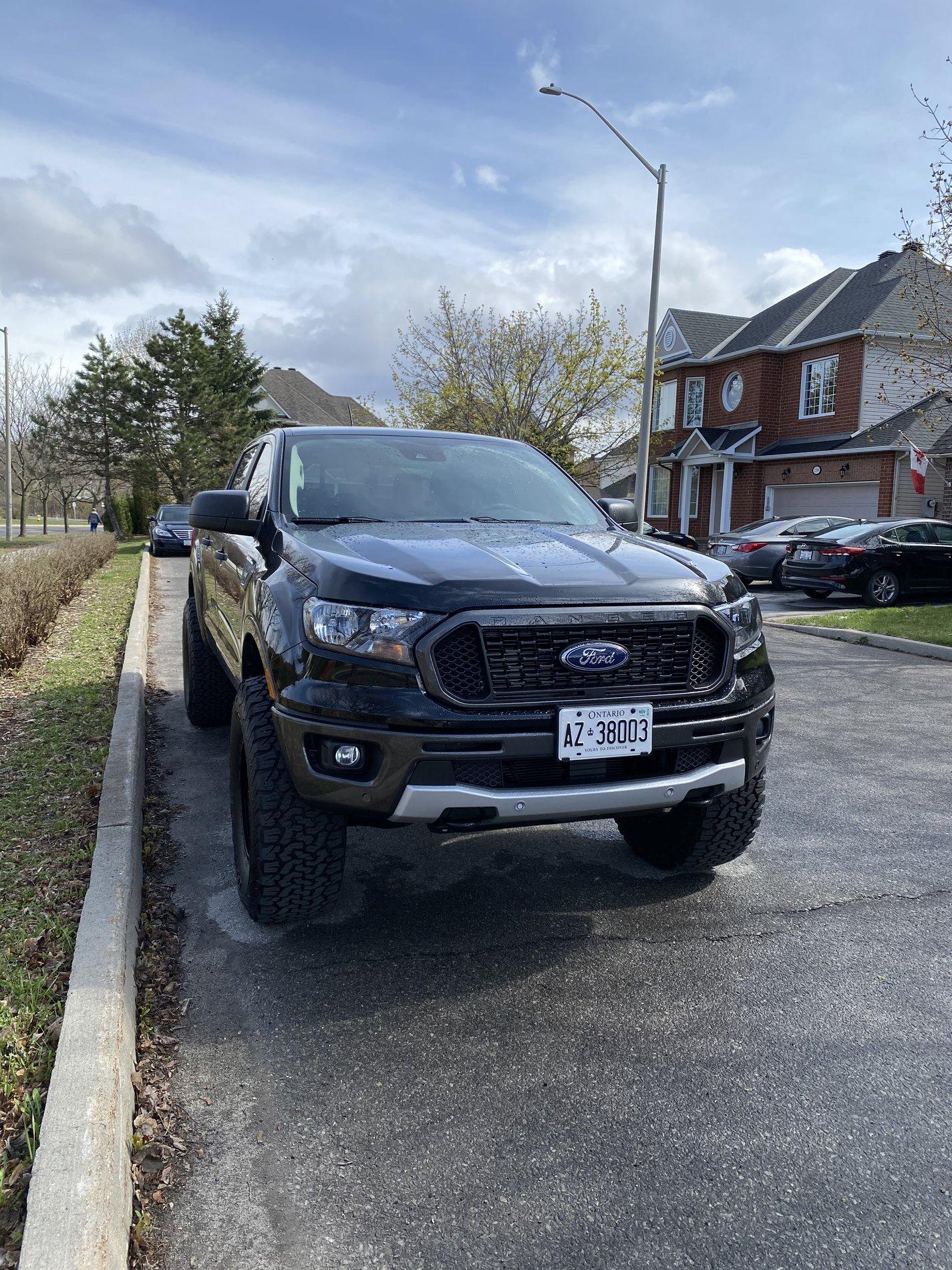

Here she is in all her glory. I will get better pictures when the snow melts. Really happy with this build! I feel like I could have pushed for 35s but the 315/70/R17 KO2s equate to 34.4" in diameter so close enough I suppose ĀÆ\_(惄)_/ĀÆ. Required a crash bar delete but that was it for now. I plan to trim the wheel well liner since there is some minor rubbing going on when the wheels are fully turned. Does anyone have suggestions for caloborating the odometer? It would be great to have my mileage calculated properly.
most manufacturer labeled 35" tires usually measure 34.5" anyway, so I wouldn't take that 34.4" into too much consideration.
but very cool they fit with so little extra work!

Thanks! The KO2s are pretty quiet considering their size, so that's definitely a plus. Probably going to invest in some lighting upgrades and some Fox 2.0s in the near future.

Can we get more pics of this sweet machine? I want to see front tire clearance, it will help me decide on size for mine.
Thanks!
