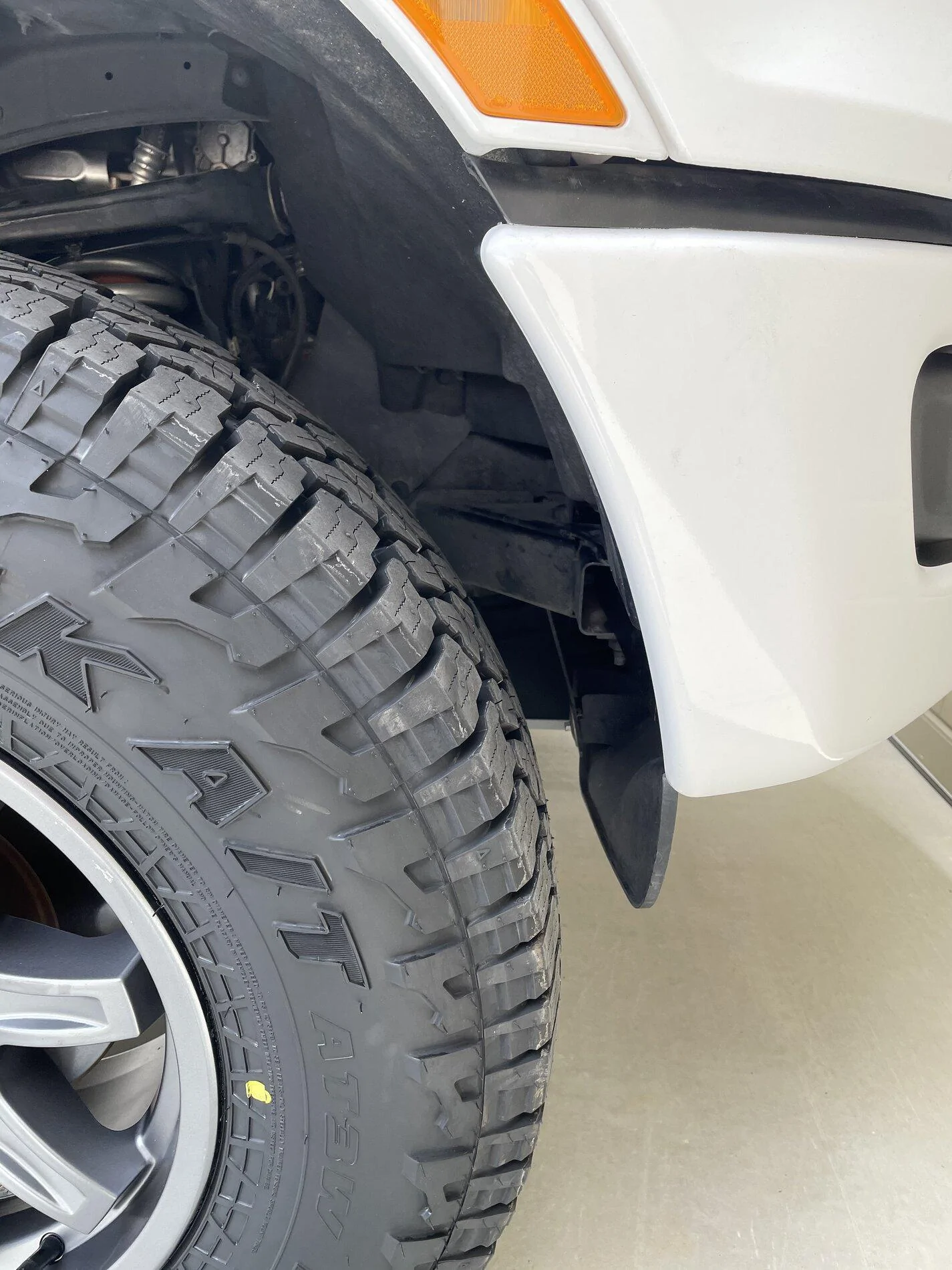

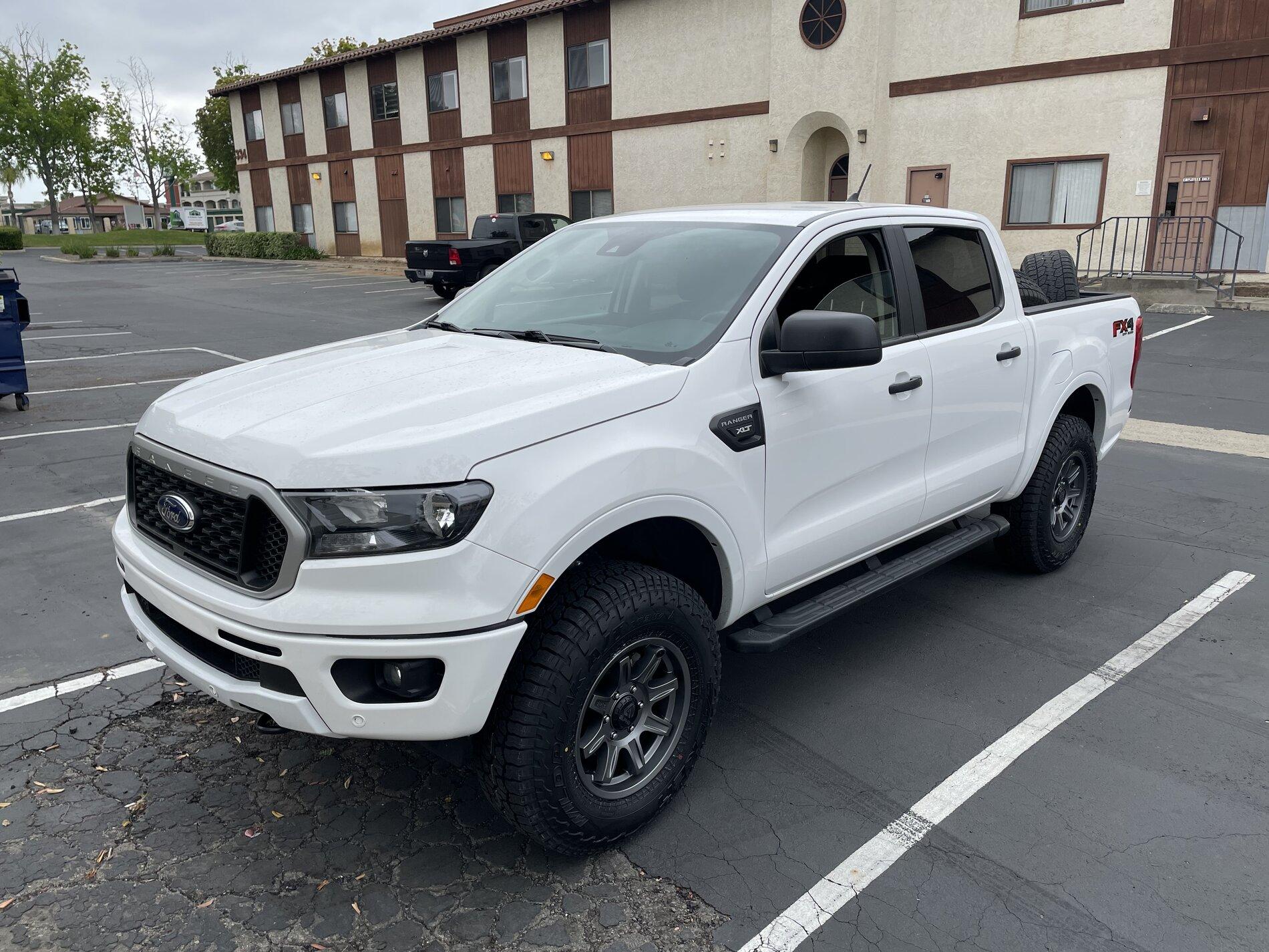

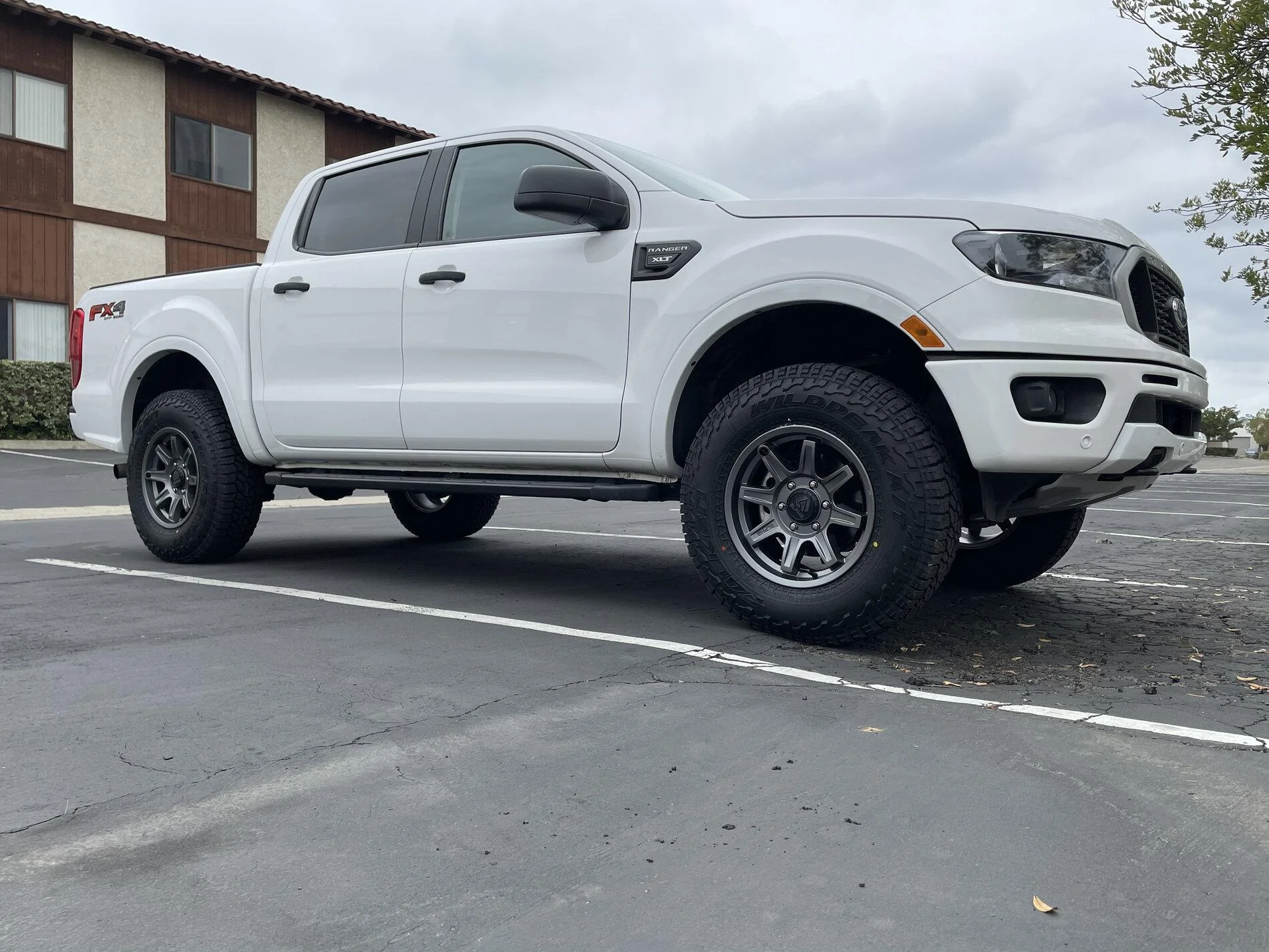

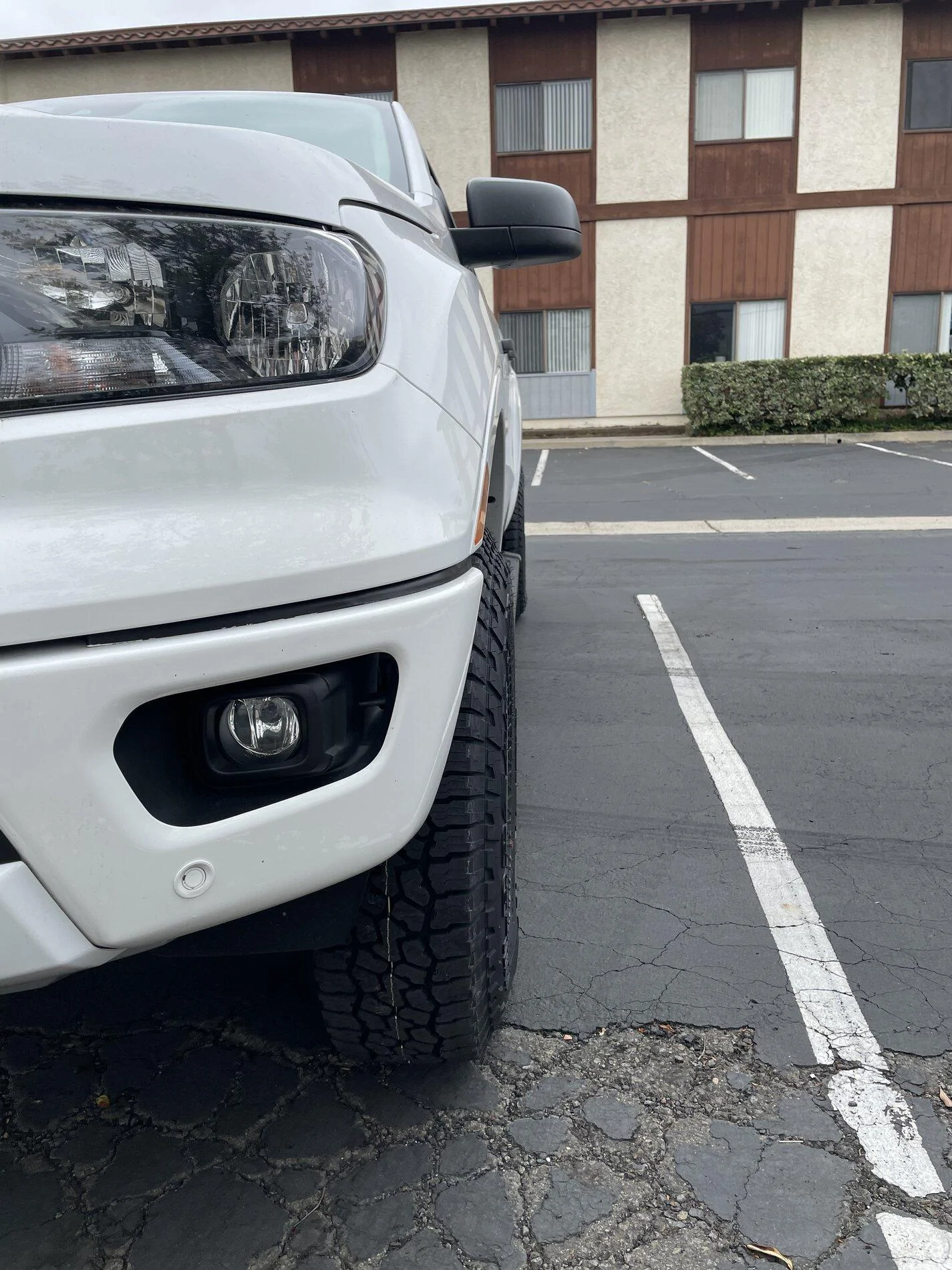

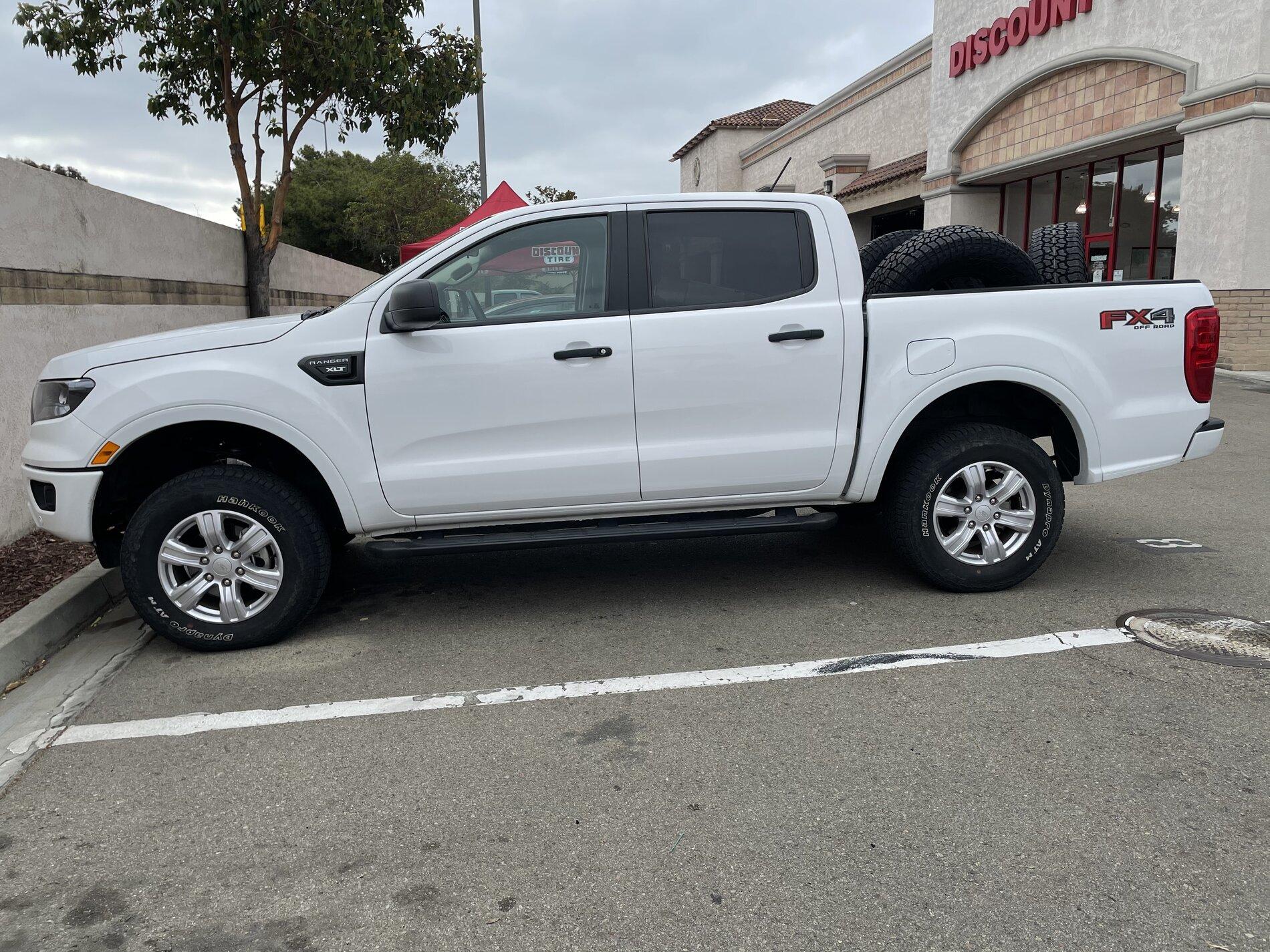

Whats going on everyone, I‘d like to share my setup. Looking through the forum I couldn’t find the setup I am running, 255/80/17 +35 offset. I know people have ran 255/80/17 tires and +35 offset but not together, that I could find.
Tires: Falken Wildpeak at3w 255/80/17 - on bathroom scale they weigh 51 lbs
Wheels: ALPHequipt Command, color is Light Grey, 17x8.5 +35 offset - on bathroom scale, 26.2 lbs

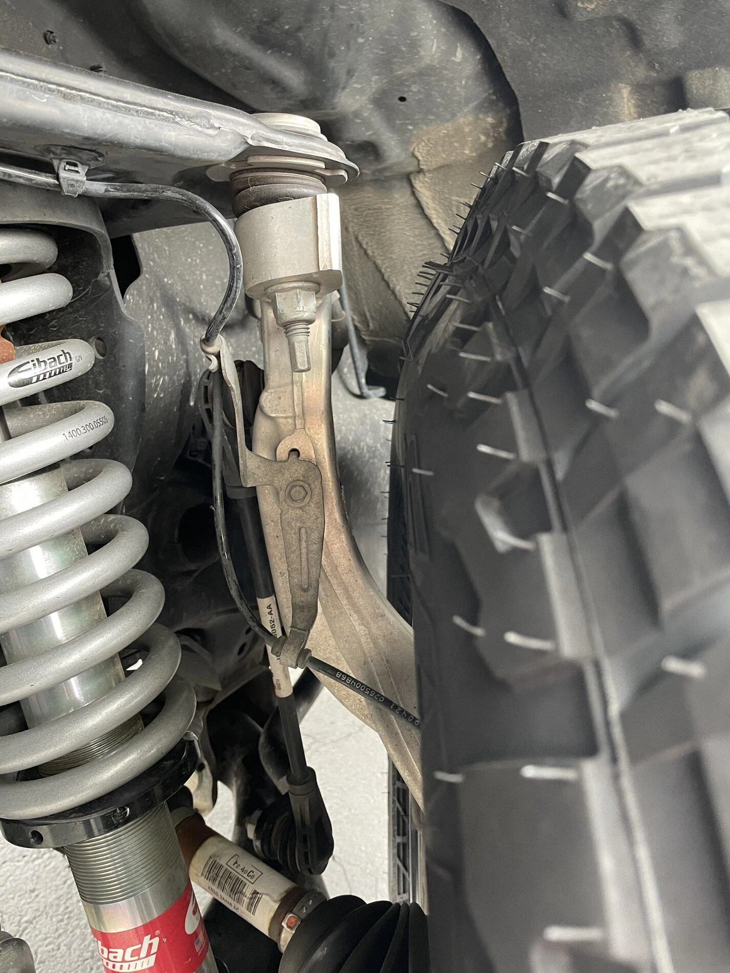

Front shocks - Eibach 2.0 coil overs, I didn’t adjust them from factory, not sure if it’s 2.5 or 3 inch lift.
Rear - waiting on the Eibach rear reservoir shocks. ETA summer.

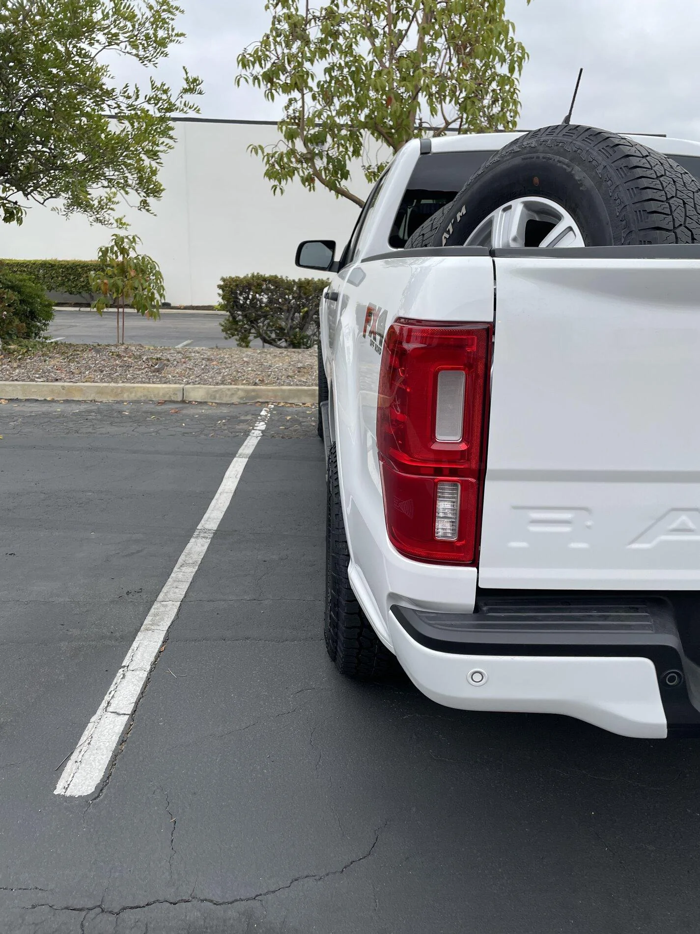

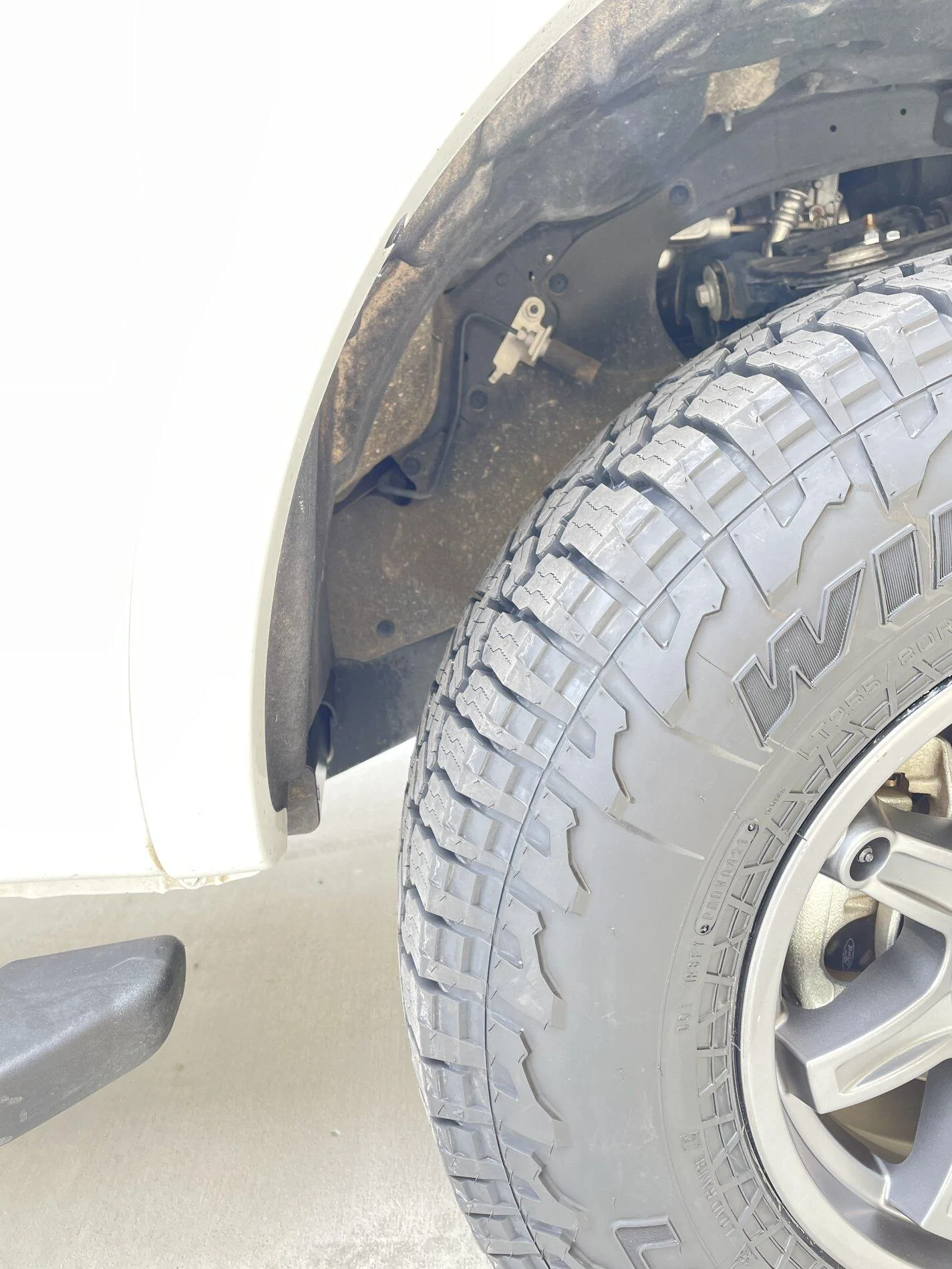

Also have BDS intrusion bars installed in the front. The rears, I loosened and moved them back. I might need to remove the little air damn in the front, it’s kinda close. No rubbing at full lock.

Looks good! You are braver than me on that front clearance..with suspension flex I'd be worried it was gonna rub.

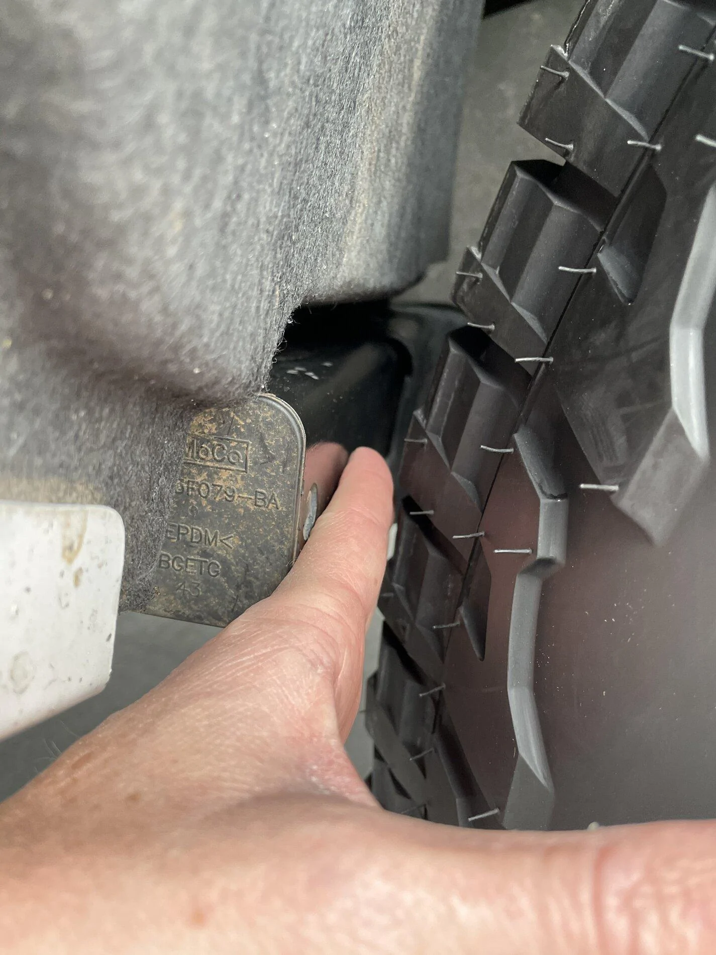

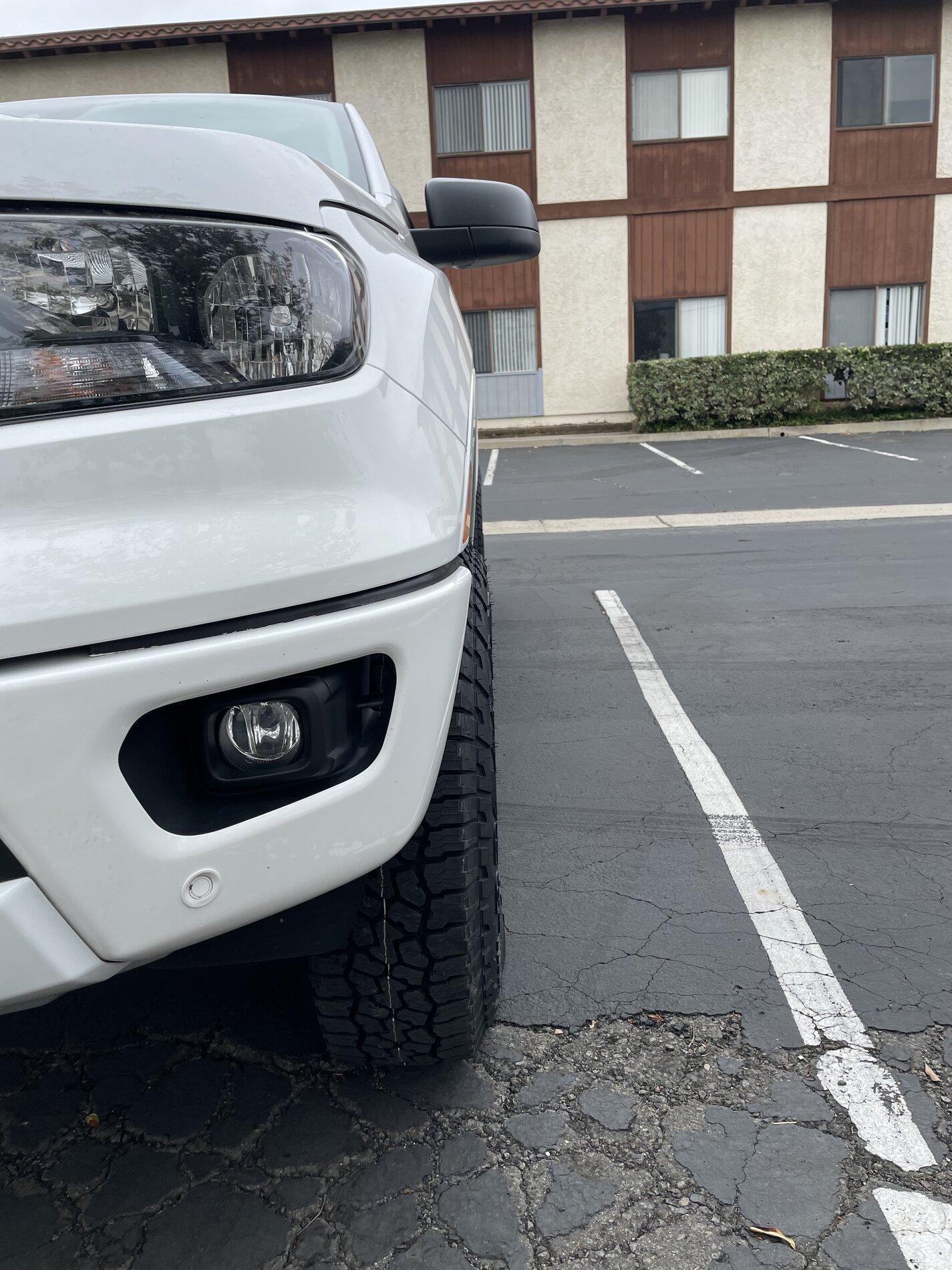

Thanks, yeah the picture is kinda skewed. Here is another picture with the tires facing forward. Those other picks were at full lock.

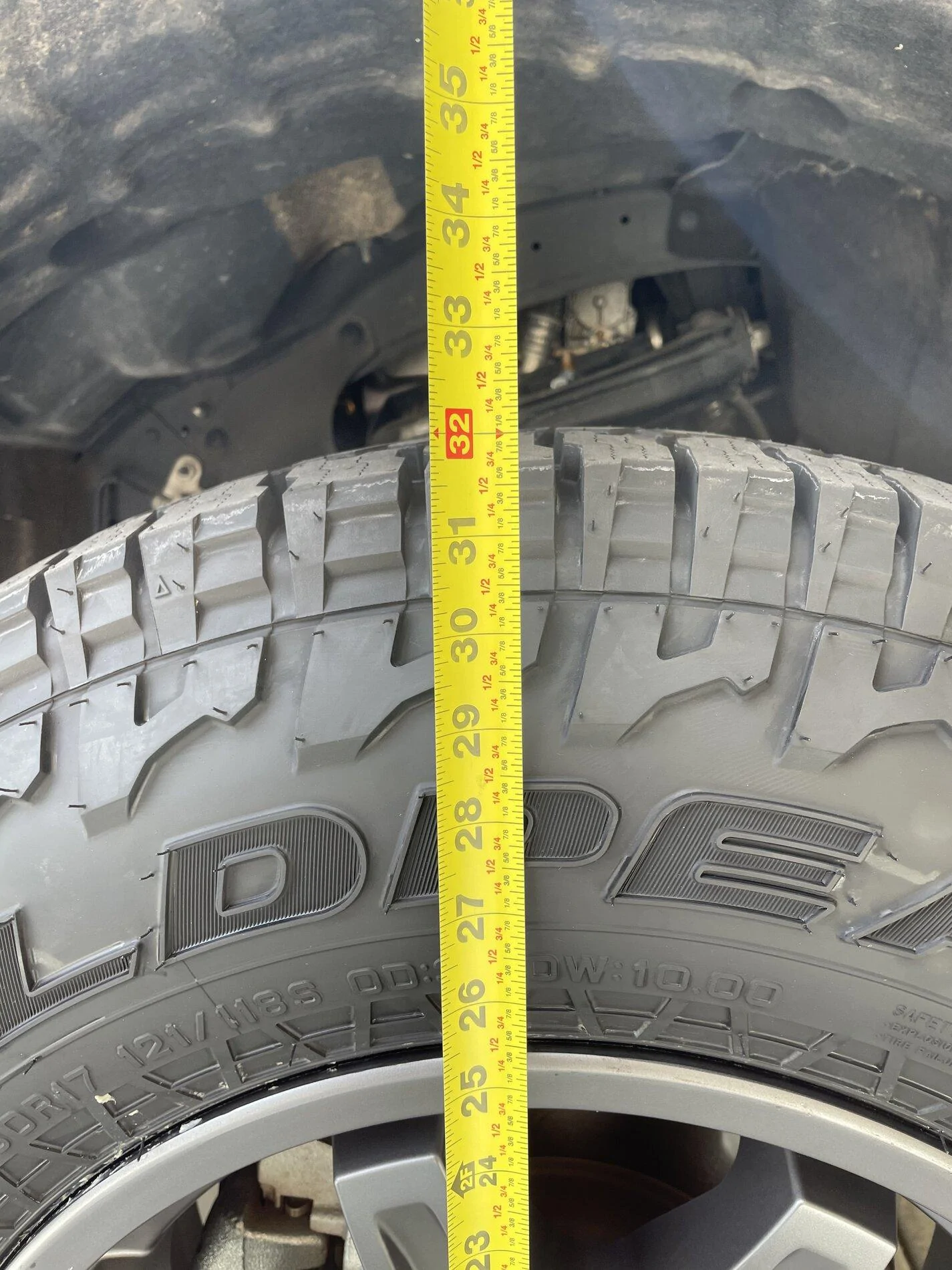

I also measured the tire and it sits at 32” from the ground.

That represents the clearance better!

255/80 gang! I removed the front air dam and it definitely looks/functions better. Great choice in tire; my Falkens are a welcomed upgrade over the stock Hankooks. Enjoy!
