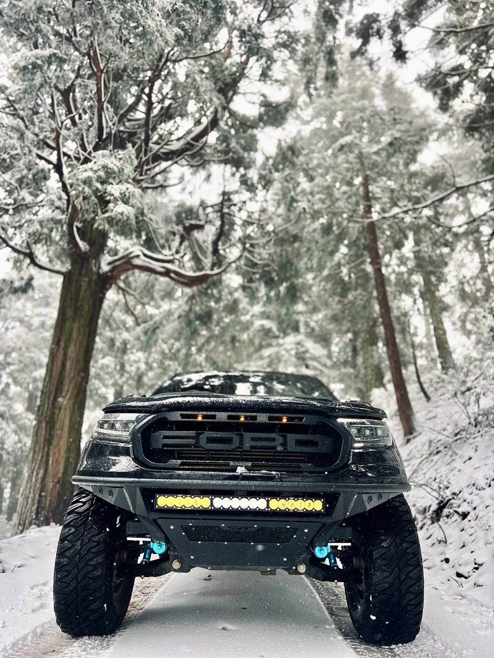

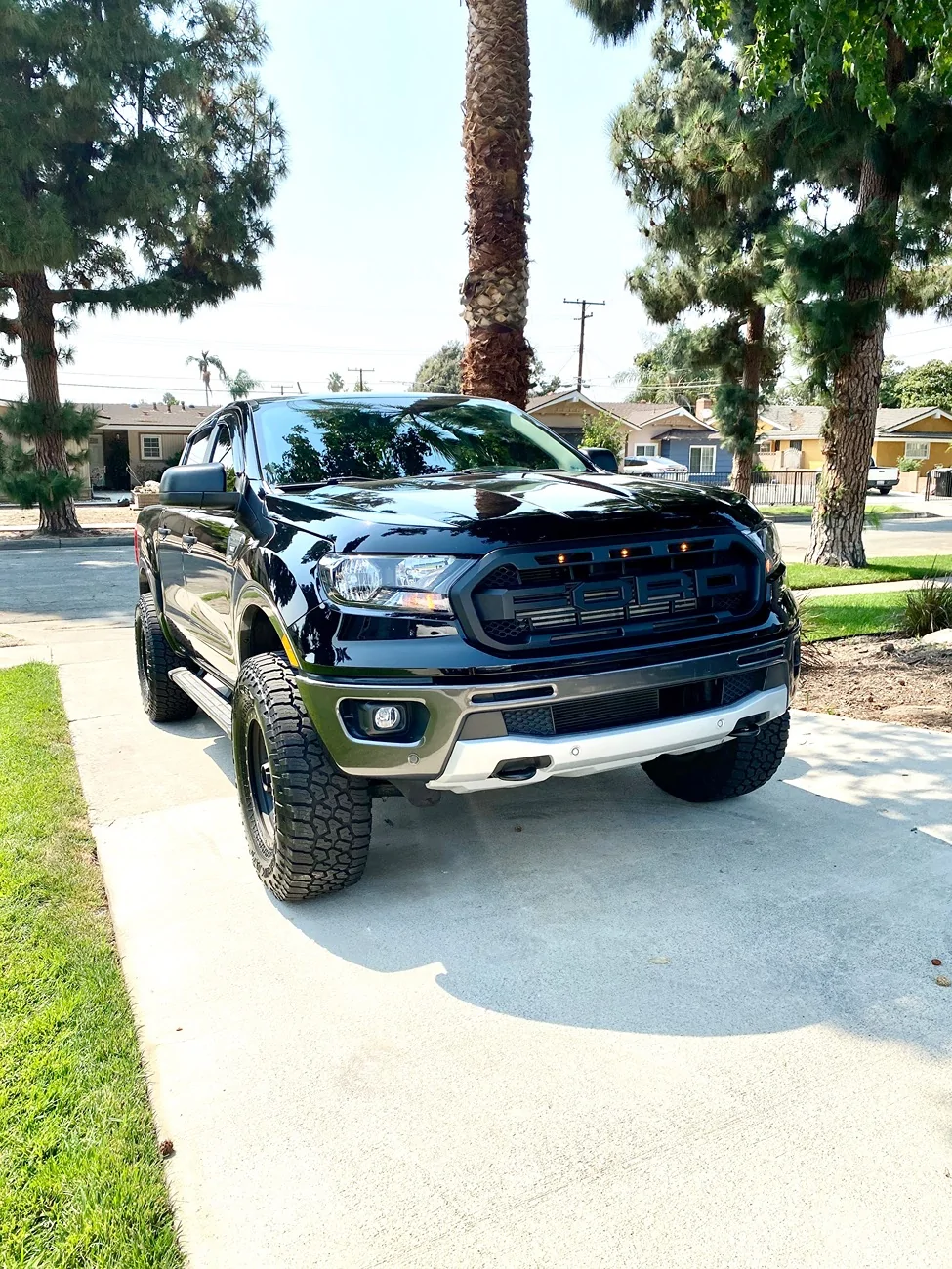

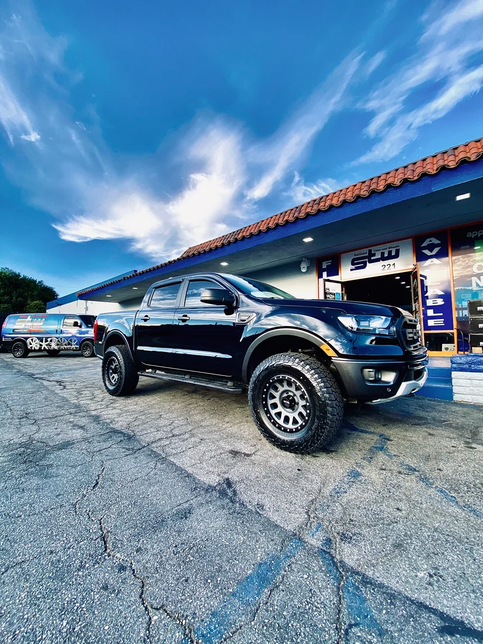

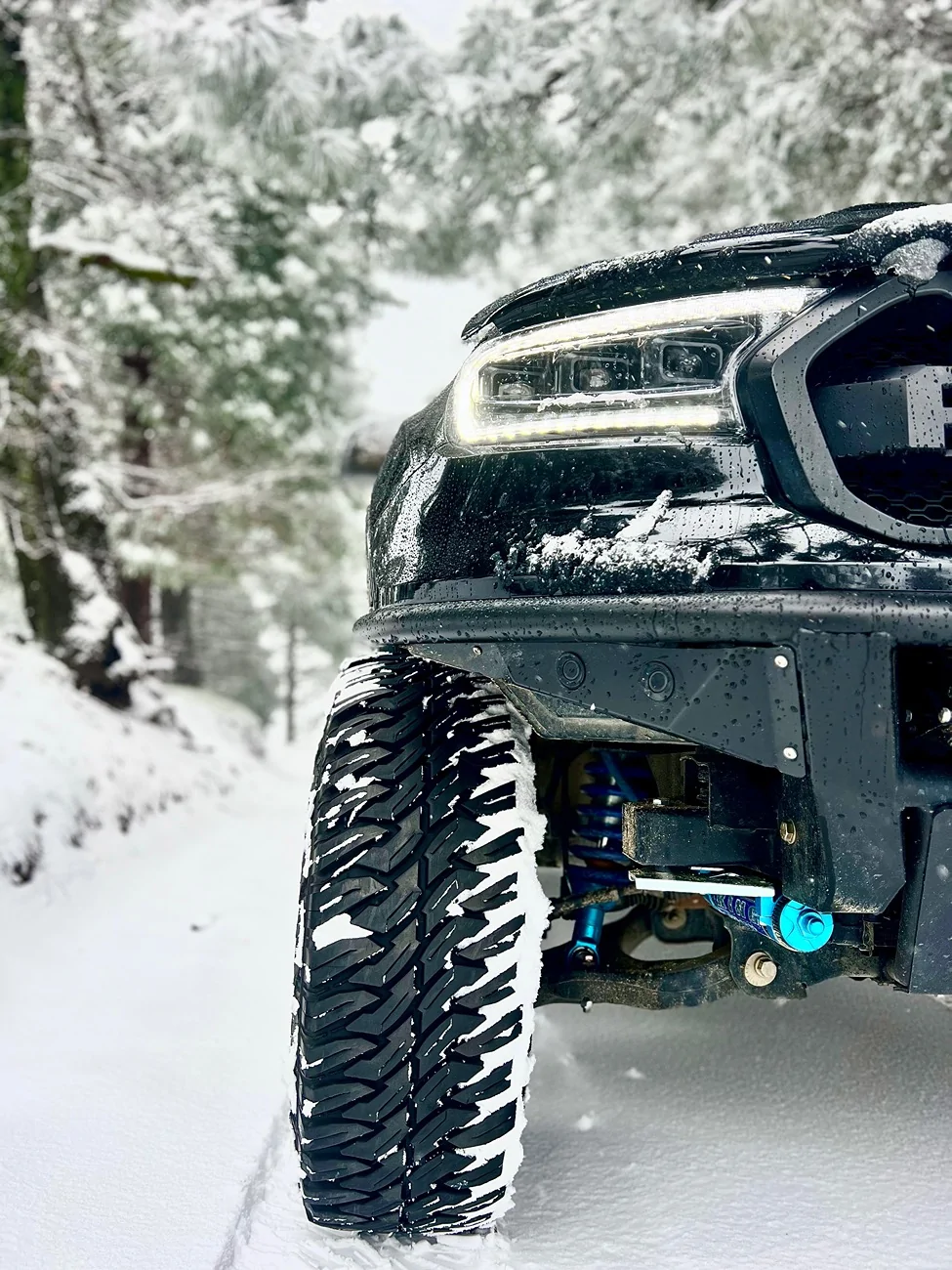

Nice. What lift kit did you go with? Depending on your budget you have lots of options for offroad wheel/tires. I’m biased and like Method race wheels. It’s probably the most popular offroad race wheel for its price point. There’s also KMC, Icon, Lock-Offroad to name a few. First picture (prior to bumpers) are when I first got the wheels/tires and went with 285/70r/17 which are 32.8” diameter tires rather than true 33” tires as that’s what fit without trimming a noticeable amount. I went with Method Race Wheel 309 Grid in Titanium with Falken Wildpeaks. Once I moved up to Eibach’s and then adjustable King 2.5s I cut crash bars and welded plates to cover that up and trimmed all the plastics front/behind tire to accommodate 35” tires.
