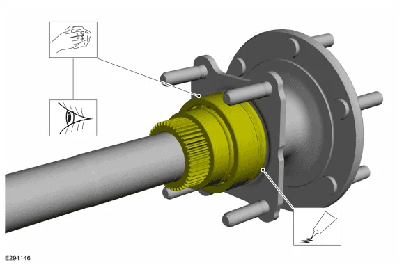

It comes as an assembly.
Axle Shaft / Bearing / Seal
The colored area is pressed on
Geeze, back in the day we used to press these on and off at a "mom and pop" auto parts store. I guess that's no longer a thing? Well that and the seal for a Ford 9" was lightly pressed into the housing and not on the axle shaft itself.
