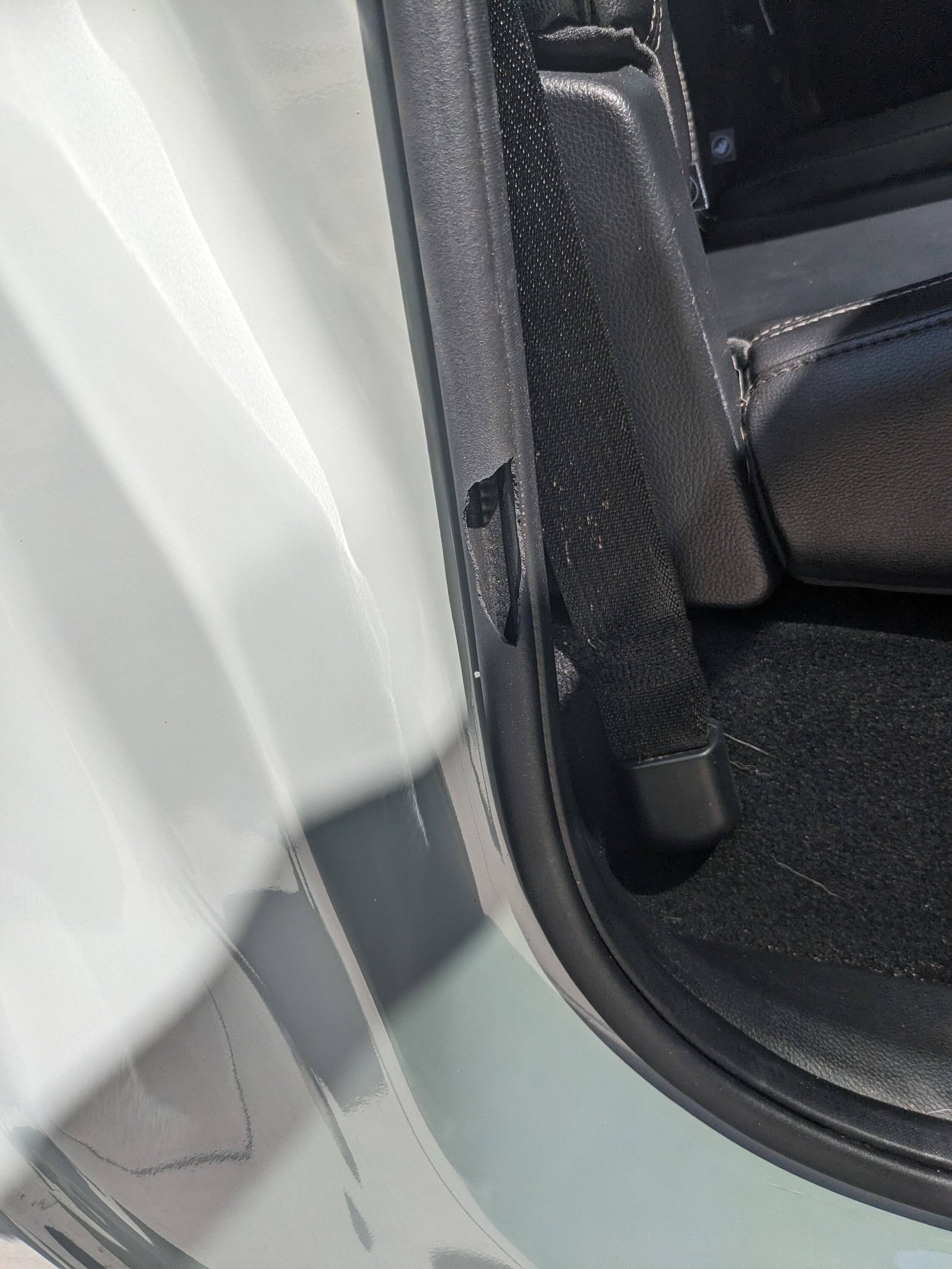

Has anyone replaced their rear passenger door seal on their crew? The weather strip that's attached to the body, not the seals on the door.
The dog took a chunk out while getting in ours and need to replace.
Should be part #: EB3Z2620708A
If I am reading the parts diagram correctly? Also no adhesive, just rip out and replace?
Definitely appreciate any help,
Thanks!

Hi Jason...they're not glued...just pull off push on...I do this every time I'm hiding cables in/around these seals...

Awesome, thank you!!!

18 months ago, I had a Hitch World outlet install the Ford OEM trailer brake controller. They had to run wires along the path of the left side door seals. I noticed after they were done that the left rear door seal was hanging and took it back. They 'fixed' it, but it never stayed in place. I finally bought some Permatex weather strip sealer and ran a line of glue, pressed the seal in place and slammed the door. Months later, problem gone.
