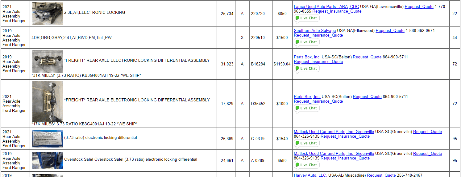

Personally, if I were out of warranty I'd look for a used unit from a wrecked truck.
Swap your brake hardware over and change the fluid and roll on.

Wow $580 for a locking rear axle with 24K on it ?

Guess I should have linked the site:
https://www.car-part.com/
Keep in mind, you are dealing with salvage places directly, so be prepared for a lot of unreturned emails, and other BS you need to jump through, but if you have the time to jump through the hoops, it can be worth it, especially if you find one locally for a good price.
IMO, axles are a lot of black magic when it comes to setup. I know it really isn't that difficult, but a lot of times, the best unit is a factory assembled one. Once you open them up and start replacing parts, they're never the same again.
