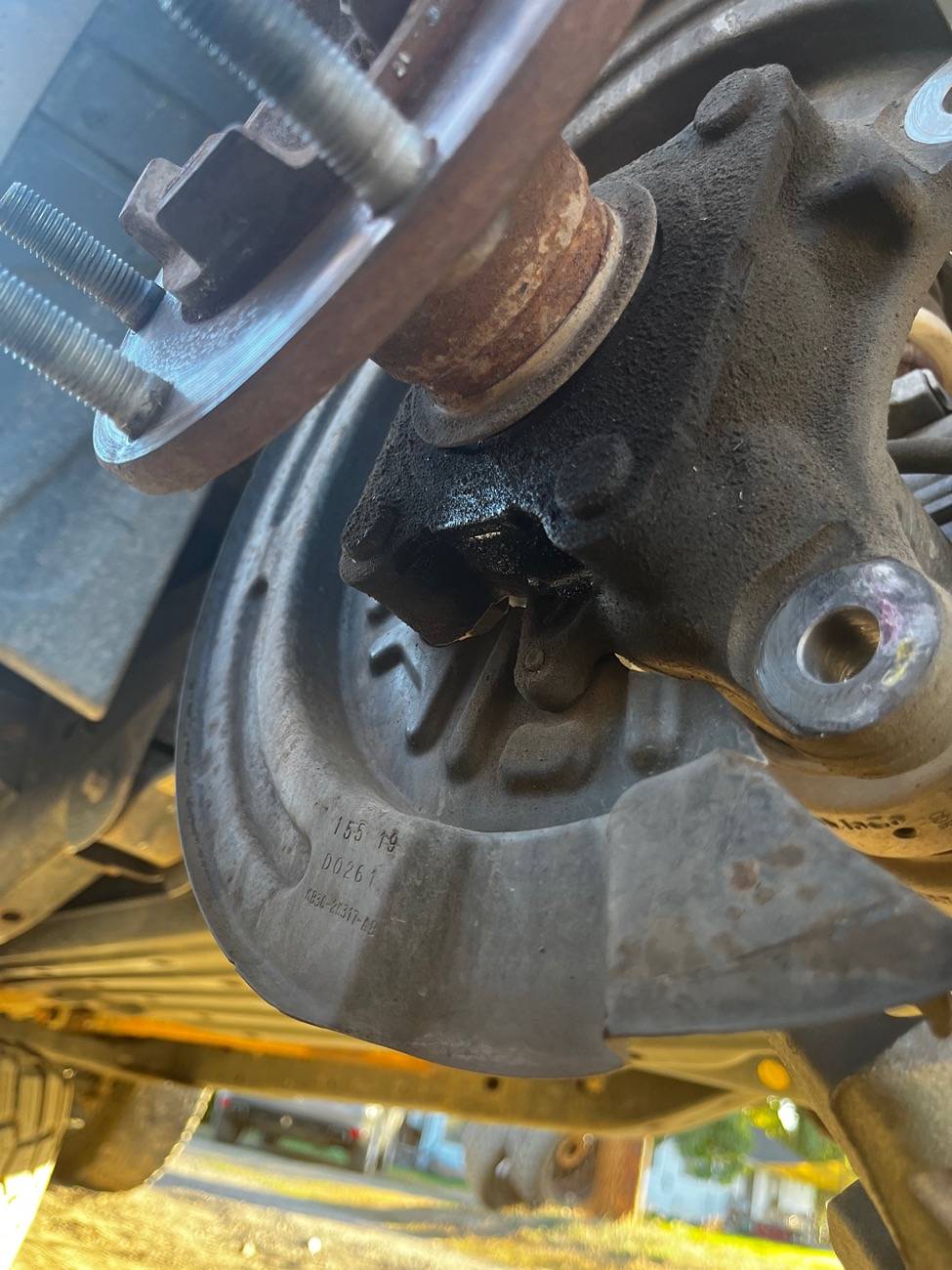

Well add my 21 to the leaking rear axle list. Between it and the 10 speed problems, I quit. Traded it on a 22 edge st. Best of luck to all of you.

Update on this, left it at the dealer while I was on my first trip (sad leaving the ranger behind...), they were able to get parts and turn it around by the time I got back. As others have reported, required replacing the whole rear axle assembly just to replace a seal.
Happy the dealer fixed it so fast, bummed out something as basic as an axle seal is still a failure point in a modern vehicle at only 6k miles.
