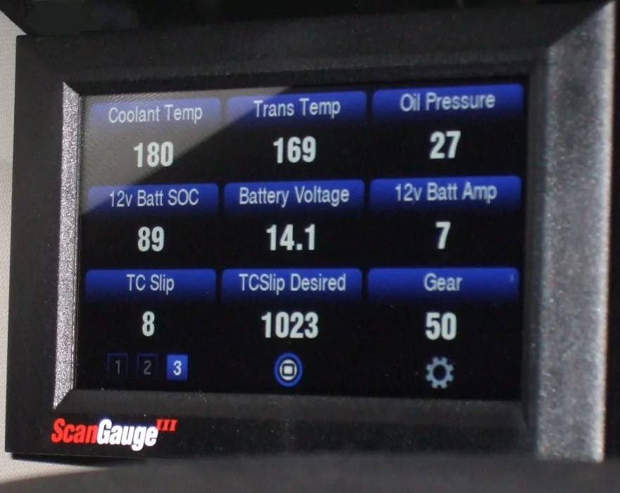

I have since purchased a ScanGauge which allows me to monitor Tranmission temperature, and Actual and Desired Torque Converter slip. I see and hear patterns, and look to prevent future issue before they arise.
Cooling the fluid increases fluid life substantially, adding LubeGard Platinum adds the missing ingredients that the Ford Engineer mentioned in his report. Changing the shift points and patterns reduces clutch wear.

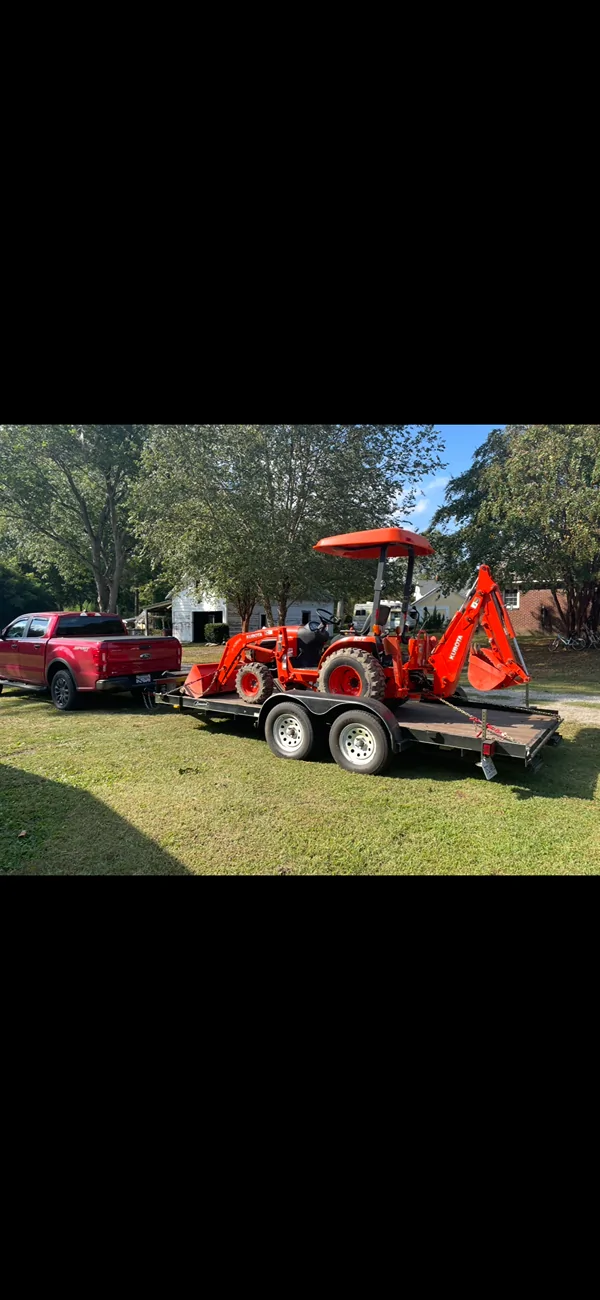

Off topic, but how does it tow with the tractor, I have an l2501 with loader and am hesitant to try to tow it with the ranger. Someone also mentioned it wouldn’t be a good idea to tow it with the ranger on the kubota forum but I know some of those guys are old school and are under the opinion of anything less than a f250 shouldn’t be towing anything.
Like it’s not even back there. I just put it in trailer mode and it does very well.

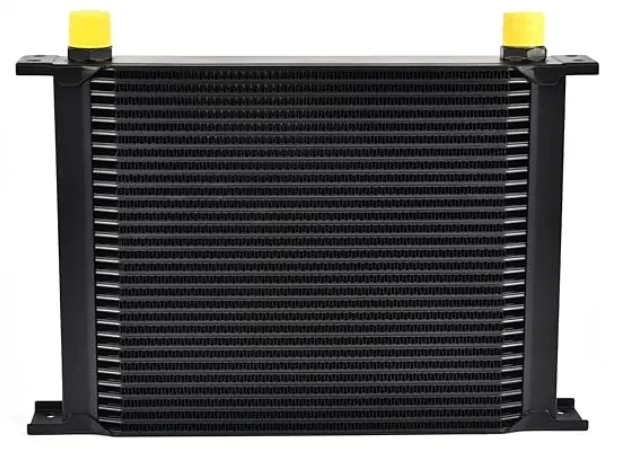

I monitor the transmission with a ScanGauge 3
I'm going to cool the transmission by adding an external pancake style 30 row cooler in the front of the truck.

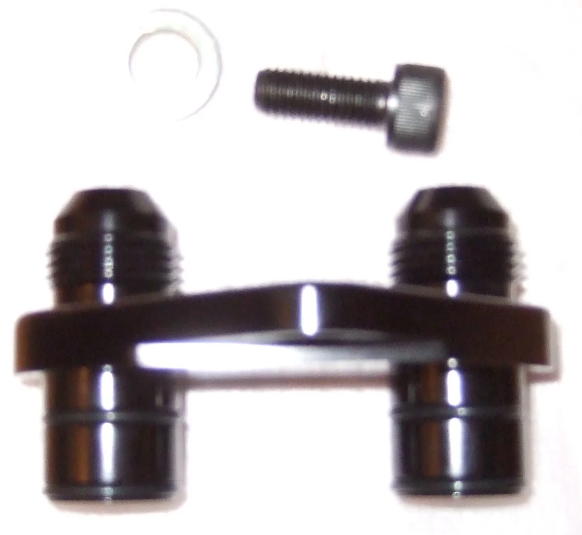

It will be connected to the transmission via PTFE hose with AN-8 fittings at the transmission and cooler. This is industrlal quality hose with a stainless steel loom embedded in the hose.

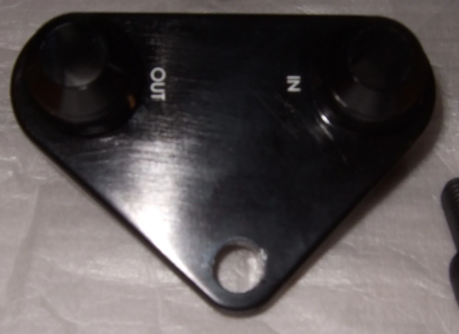

Transmission adapter plate
There is a little Southern engineering involved as well, as I need to remove the Ford heat exchanger from the fluid circuits, but leave it electrically connected to prevent an error code. Swapping out the design is easy enough but a little thought will be needed to figure out where to mount the heat exchanger nearby.
When I am under the truck I'll see what is possible. This will cetainly invalidate the warranty for the transmission, but I trust myself more than I trust Ford.
There are a lot more bits and pieces, but this covers the big picture.
