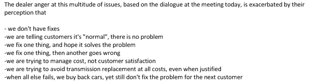

I'm sure Ford and pretty much everyone else has, maybe not to the same level now, but somewhere along the line, similar skeletons in the closet.
--Edit--
I went down the rabbit hole of re-reading some of the unsealed lawsuit documents.
This sound familiar?
GM Circa 2016
