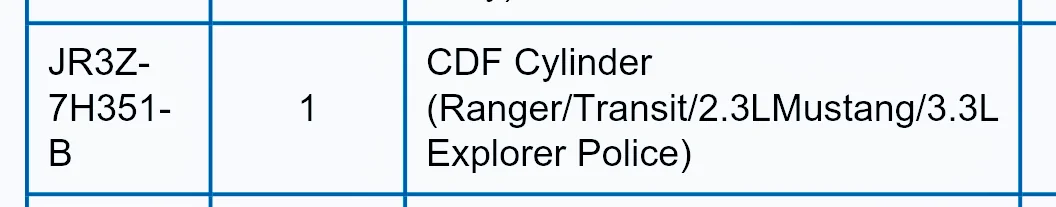

In the 3222-2428 TSB the CDF part number listed as the replacement is here: (wonder if the original one is different #?)
Note JR3Z-7J351-B replaces JR3Z-7H351-A so if you get a replacement /rebuild make sure the old A design doesn't get stuck in there or you'll just do it all again. ??

I think it took mileage before a CDF would fail. I do think something must have changed in the valve body but haven't found any published evidence of that other than TSBs saying to replace and reprogram. That's way cheaper than pulling the transmission and rebuilding it.
At this point after so many failures across Ford/Lincoln vehicles it's likely the newer versions are sorted out. If mine fails and is rebuilt with the new parts I'd have confidence in it. I'd like the Raybestos upgraded GPZ clutch packs since Suncoast puts them in even their entry-level transmission and possibly their specific valve body but that would be completely out of pocket.
