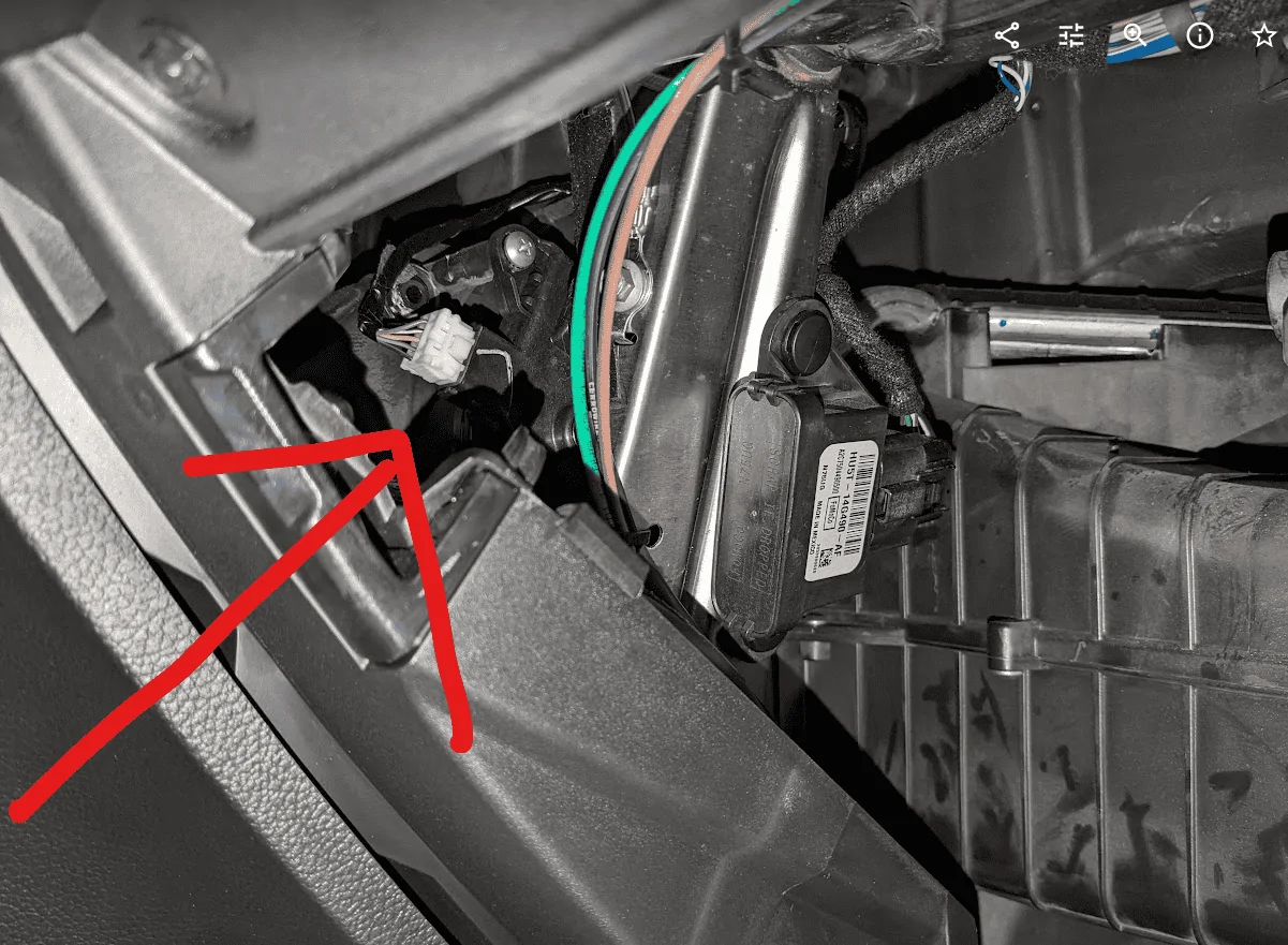

Thanks for the reply. I think I am on the same page as you.
My 2021 should have the newer heater box, I don't think the blend door is binding. I think it is just the crap actuators. I removed the glove box and the clicking is dead on where the passenger actuator is (see pic - note the three colored wires are for an aux light switch I have).
Now, do I wait until failure to have the dealer do it, or just replace it myself? I would need to remove more trim or something to have better access.
I'm assuming my dealer won't do anything with it just clicking, when the HVAC temps work ok. Having to wait for a failure is annoying.
Thanks again @airline tech, your info on this forum is fantastic.
