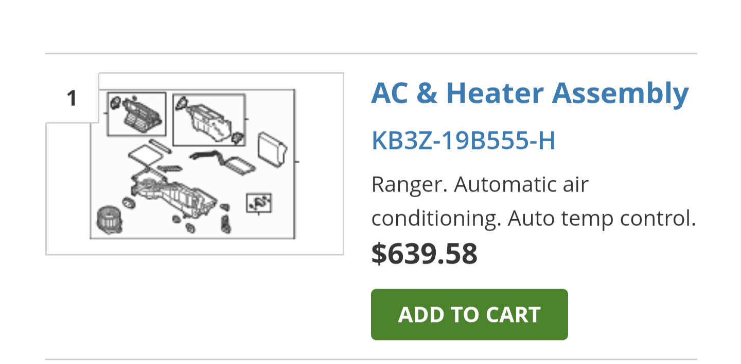

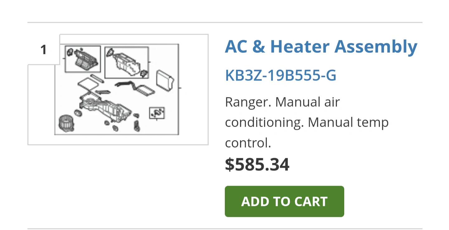

Well don't quote me exactly on every part...but for me and even as mentioned in the YouTube video link I provided...the only component really replaced is 1 HVAC assembly.
The entire assembly replaces your old one that has become warped and causes the failure of your blend doors (opening and or closing)
The question about which assembly part you need depends on your truck....do you have manually controlled heat and air conditioning? Or do you have automatic temp control heating and air system.
Levittown Ford Parts has the pricing on the 2 different assemblies depending on your needs....there is a thread for Levittown parts on this forum and you *may* be even able to get at a lower cost possibly.
I've attached screenshots.
I have the automatic dual zone... yeah those prices are pretty shocking. I'll have to look it up.
