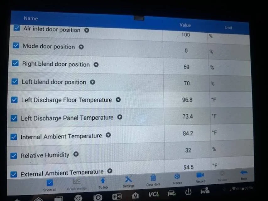

I have a problem where the air is flowing out of all vents and I can’t change it. OBD2 error shows code B1086:11 “damper motor short to ground”.
Based on what you have shown me, I am presuming the mode door actuator is not working, and this looks like a mission to replace.
Do you have any thoughts on how else to fix this error? Could it be some wiring that is more easily accessible?

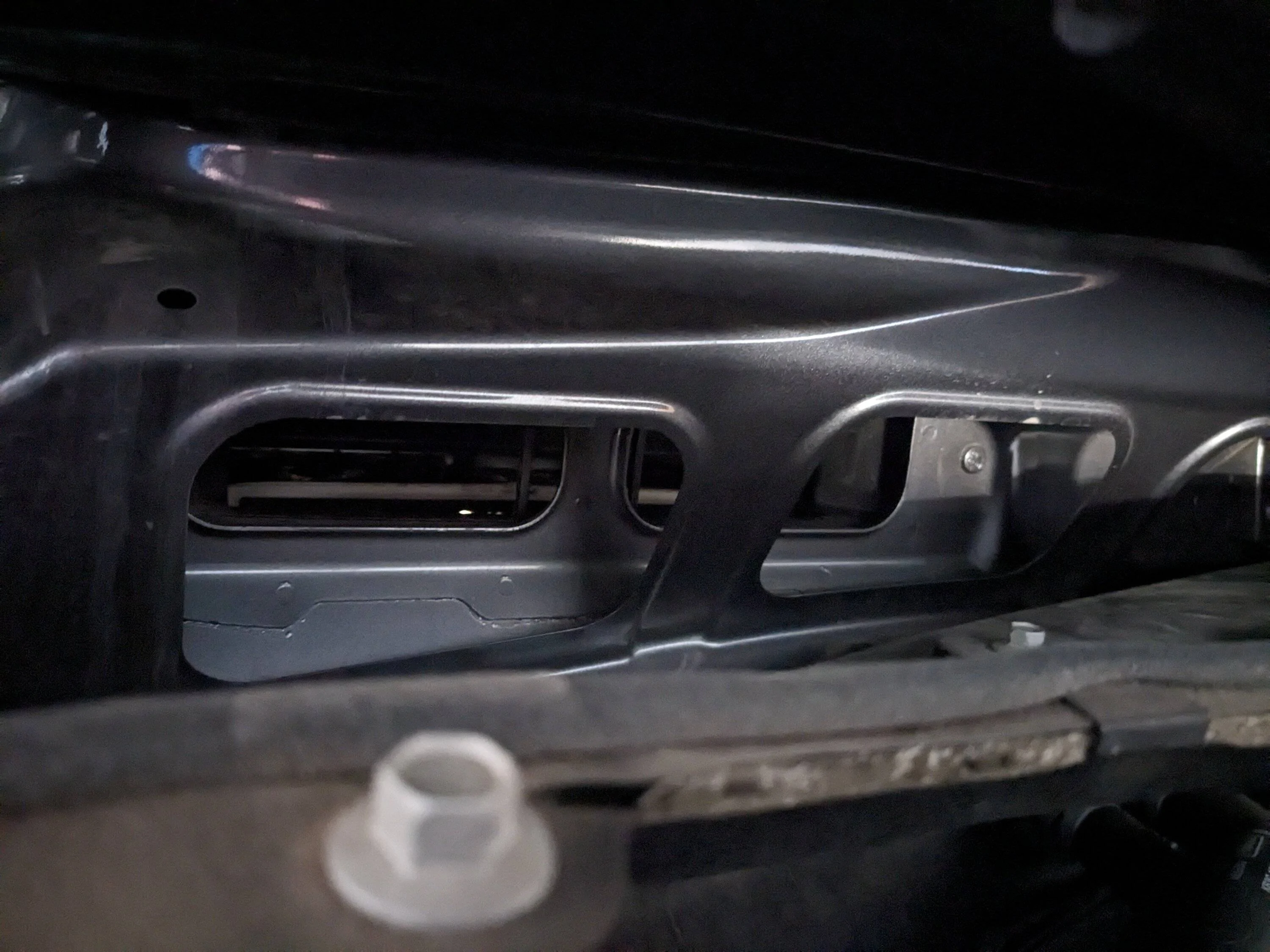

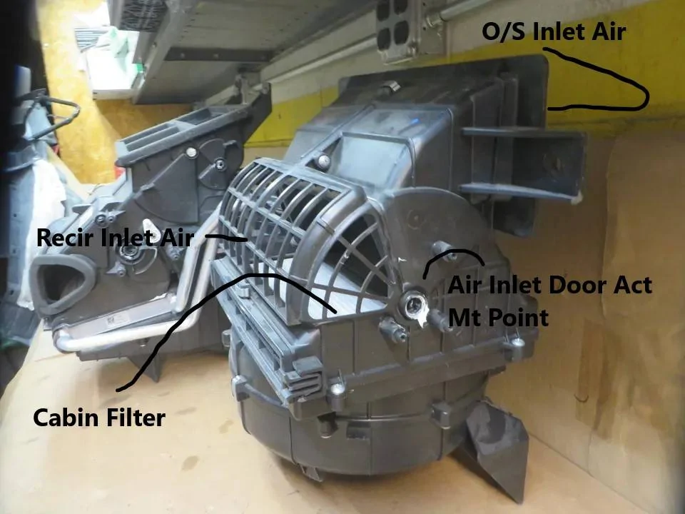

AIR INLET:
Let's start with the Air Inlet Door
This is mounted just behind the Glovebox just above the cabin filter.
This door is an annoying design for some, and it also allows an easy point of entry for mice into the cab.
NOTE: Even when in Recirculation Mode, the door is NEVER 100 % Closed, it is designed to remain 10% OPEN even when it is closed.
The system is designed to operate mostly with the Door Opened to allow maximum outside air to be introduced into the cab, even with the system off you still have outside fresh air entering the cab through the open vents in the pic.
Note: When the HVAC is OFF - You do not have any airflow from the cab vents, but you do have - Fresh Air Intake coming into the cab from the Recirculation Air -(Open) vents - since the Air Inlet Door closes when off, since the Blower Motor is not running to suck this air into the HVAC, it just pushes it out of this opening.
and uses this as Fresh Air (Intake) and the air Exhaust out of the (Rear Cab - Exhaust Vents)
Note: HVAC Off = System Turned Off
The Air Inlet Door Moves to Partially Open - When the Truck is turned off.
The issue with the design of it not going 100 % closed, it will always remain at least 10 % open (in recirculation mode) is that the design of the air inlet being so large that any (skunk smell, smelly exhaust or SMOKE from Wildfires can easily be sucked into the cab.
Even if you place the system in recirculation mode to lower the amount of Outside Air (Input) the system has an internal Timer that only allows the door to be in recirculation mode for (5-Minutes) then it automatically opens back up.
While I cannot state how this is annoying for SMOKE areas of the country, I have noticed that this truck will inhale every obscure smell it gets driven through.
Much GREATER than any vehicle I have ever owned.
When you turn the truck off, this door powers to the partially open position - reason to vent the HVAC Box (mainly the Evap Core) to eliminate musty stale odors from the EVAP core and to assist in drying and or evaporating any moisture in the Condensate Drain and Evap core area.
The issue with this (needed) design is the size of the vent openings and also the engineering design leaving out an important need and that is a screen on the outside inlet air end.
Mice can find their way down under the plastic cowling (below the windshield) and crawl into the inner (metal cowling) and then enter this inlet port and down on top of the Cabin Air Filter and then able to fit through the vent openings as viewed in the pic.
They now have full access to the cab and the tasty dash wiring.
I cover more details on how and when this door operates later.
Edit: Added Info and Pic
Pic Showing how the door moves to partially open with truck shut off.
Note the opening and entry point for mice.
This is the reason to add a screen under the cowl, to block this access off for mice.
To understand operation of the door:
Rotates CW - Recirculation (ON) - Closing the Outside Air but does not actually fully close 100% it only closes about 90%, leaving roughly about 10% of an opening for Outside Air to enter the cab.
Rotates CCW - Recirculation (OFF)

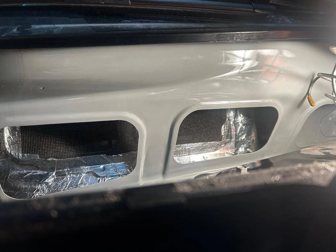

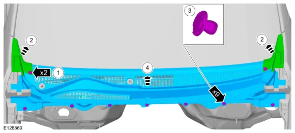

If you remove the Plastic Cowling under the Windshield, you will see this opening. This is the inlet to for the Outside Air into the HVAC Box. (Passenger Side)
You can cover this opening with a screen (I used Drywall Sanding Screen) 120 Grit.
This prevents mice and debris entry into the Cab.
This also helps slow down the Air Intake by providing (SOME) blockage but still allows airflow. Lessens the Fowl Odors be sucked in so quickly.
This has no effect on the Blower Motor - Operation.

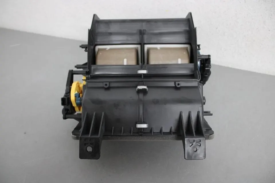

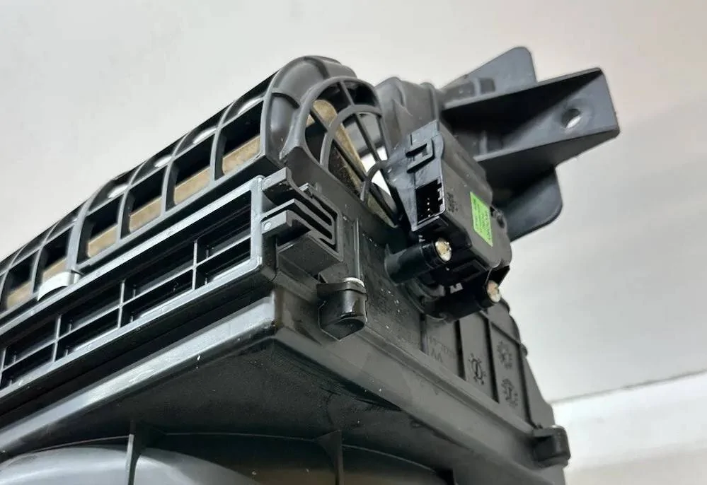

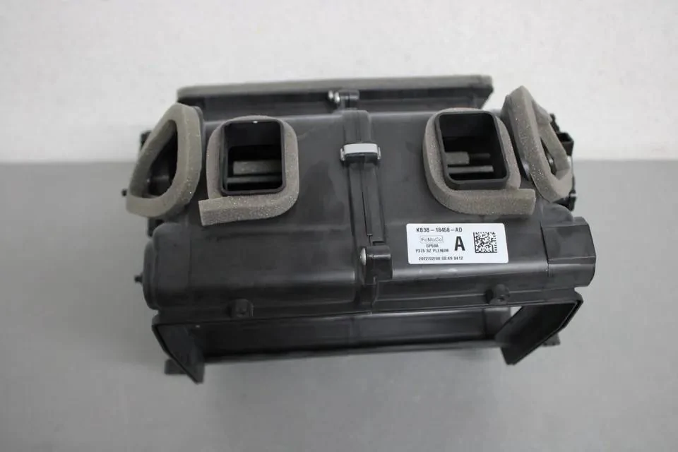

AIR DISTRUBUTION:
To help visualize how the system operates let's take a look at the air distribution.

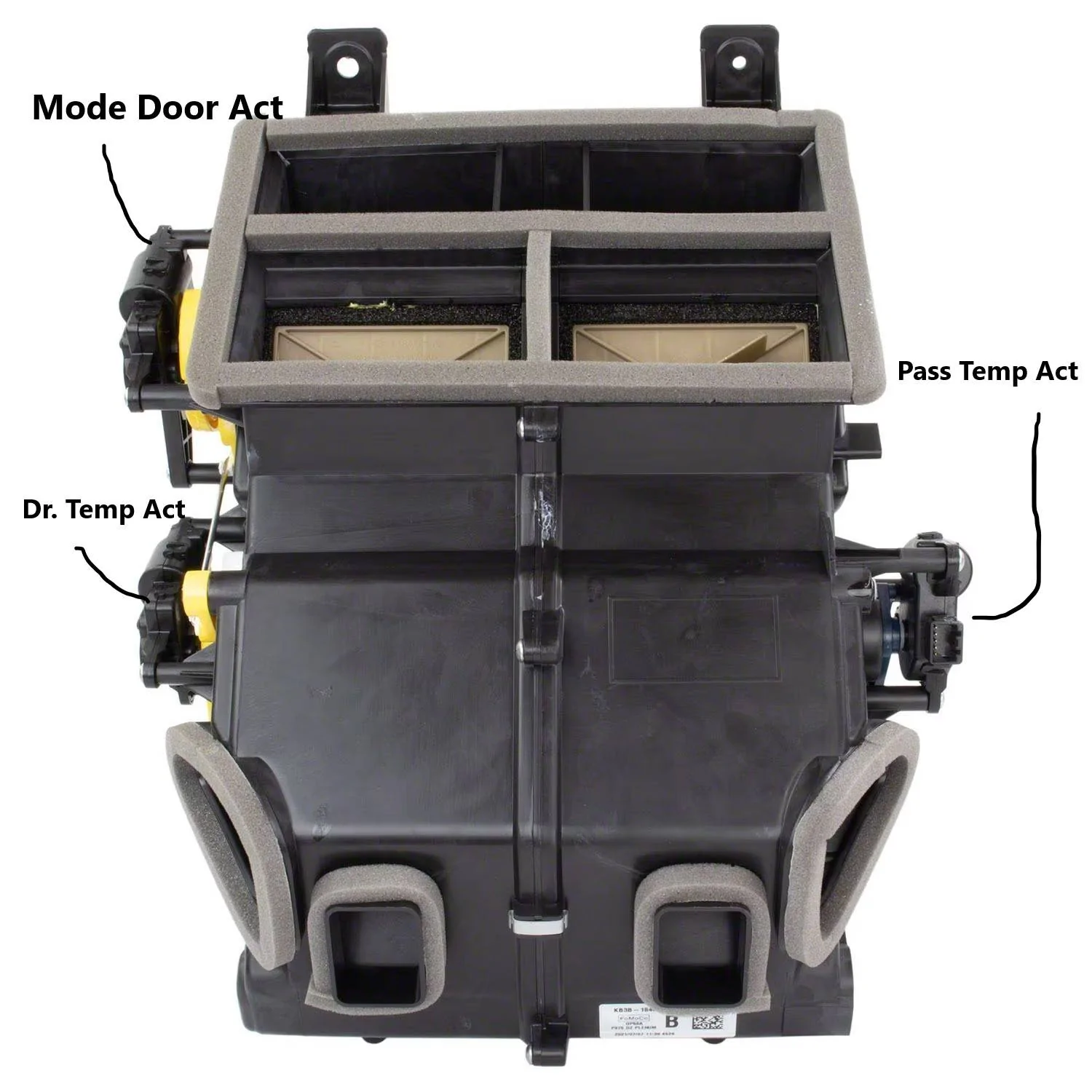

We have (1) Mode Door Actuator that controls (Moves) a Plastic Bell Crank (Yellow-Plastic Piece)
This moves 3 sets of Doors into position to distribute the selected airflow.
The visible doors in this pic show the Panel Air Doors
Note: For those that have issues with Foam pieces being blown out of the ducts / vents, if you look closely, you can see Foam around the Panel Vent Doors
There is Foam around the various doors and ducting to aid in sealing the system for airflow leaks.

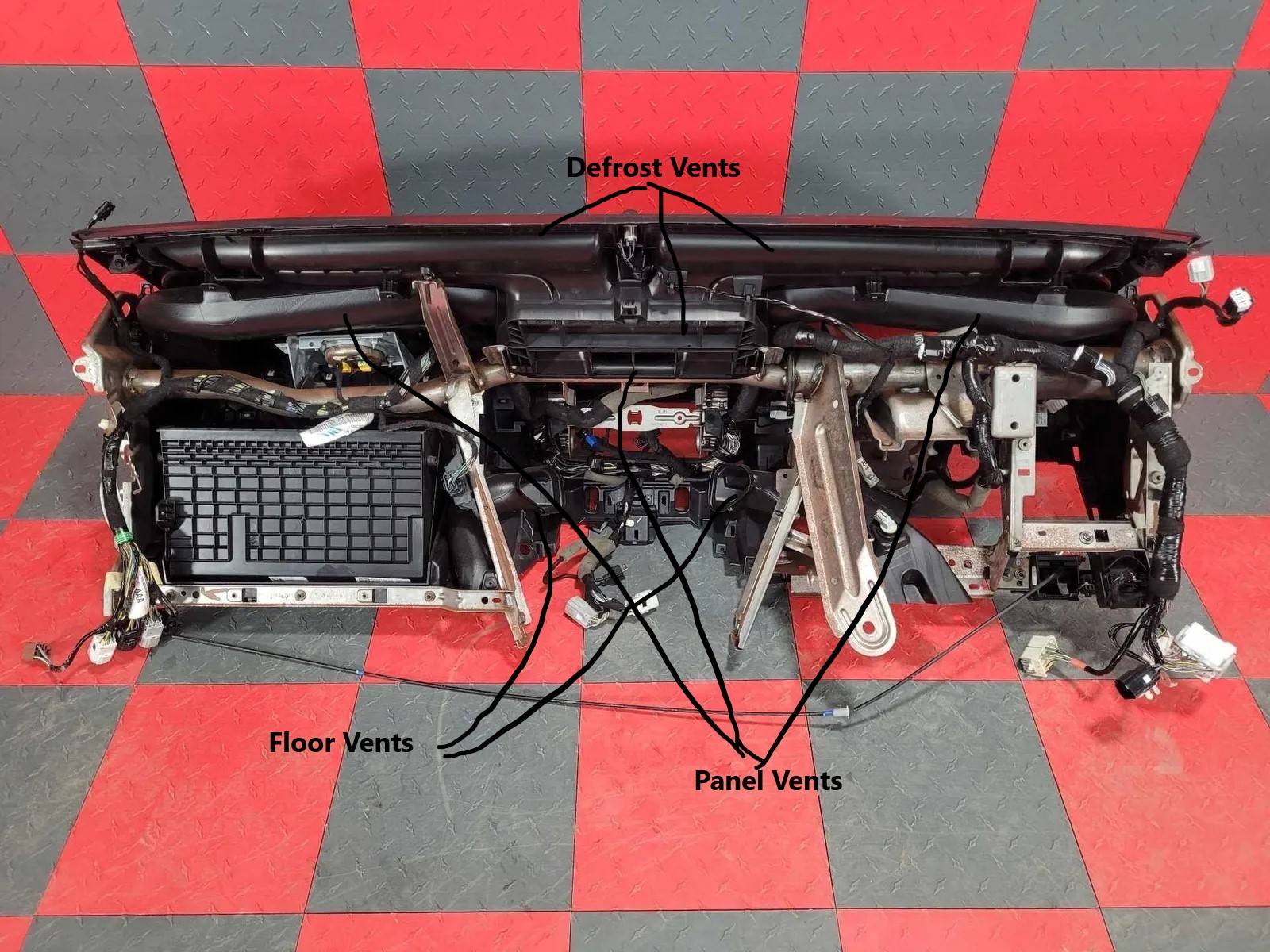

Here is a view from a removed Dash Console

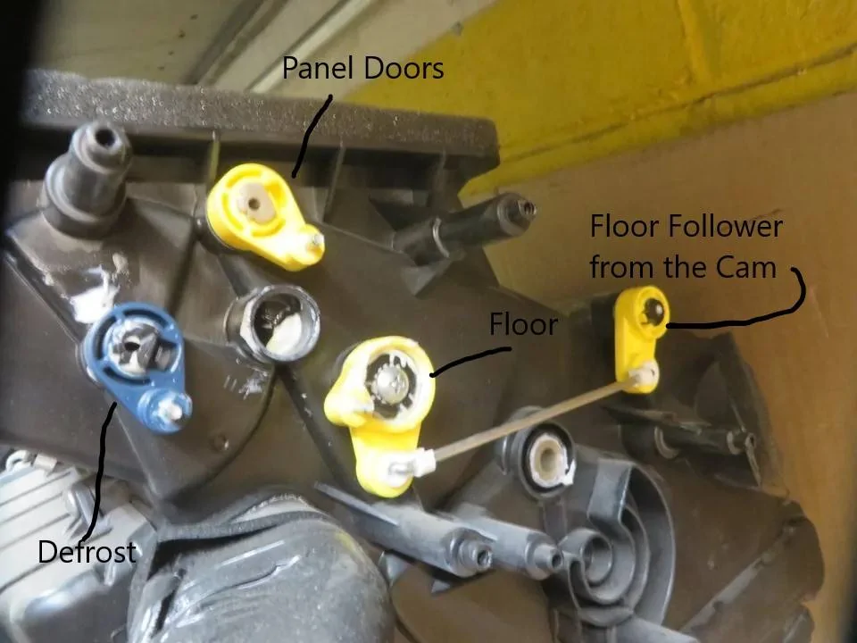

Now this pic shows the layout of the door levers that are driven by the yellow bell crank.
Note: The Lever I have labeled Floor is just the Driving lever for the Floor Follower - The Floor Follower is the Lever that is actually moving the Floor & Under Seat Doors.

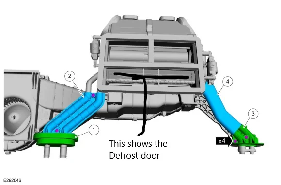

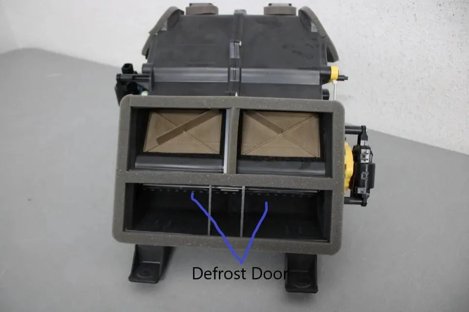

Defrost Door - Driven by the Blue Lever

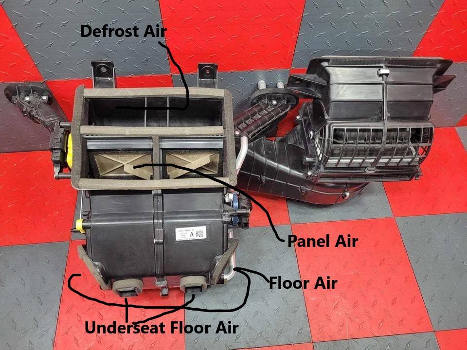

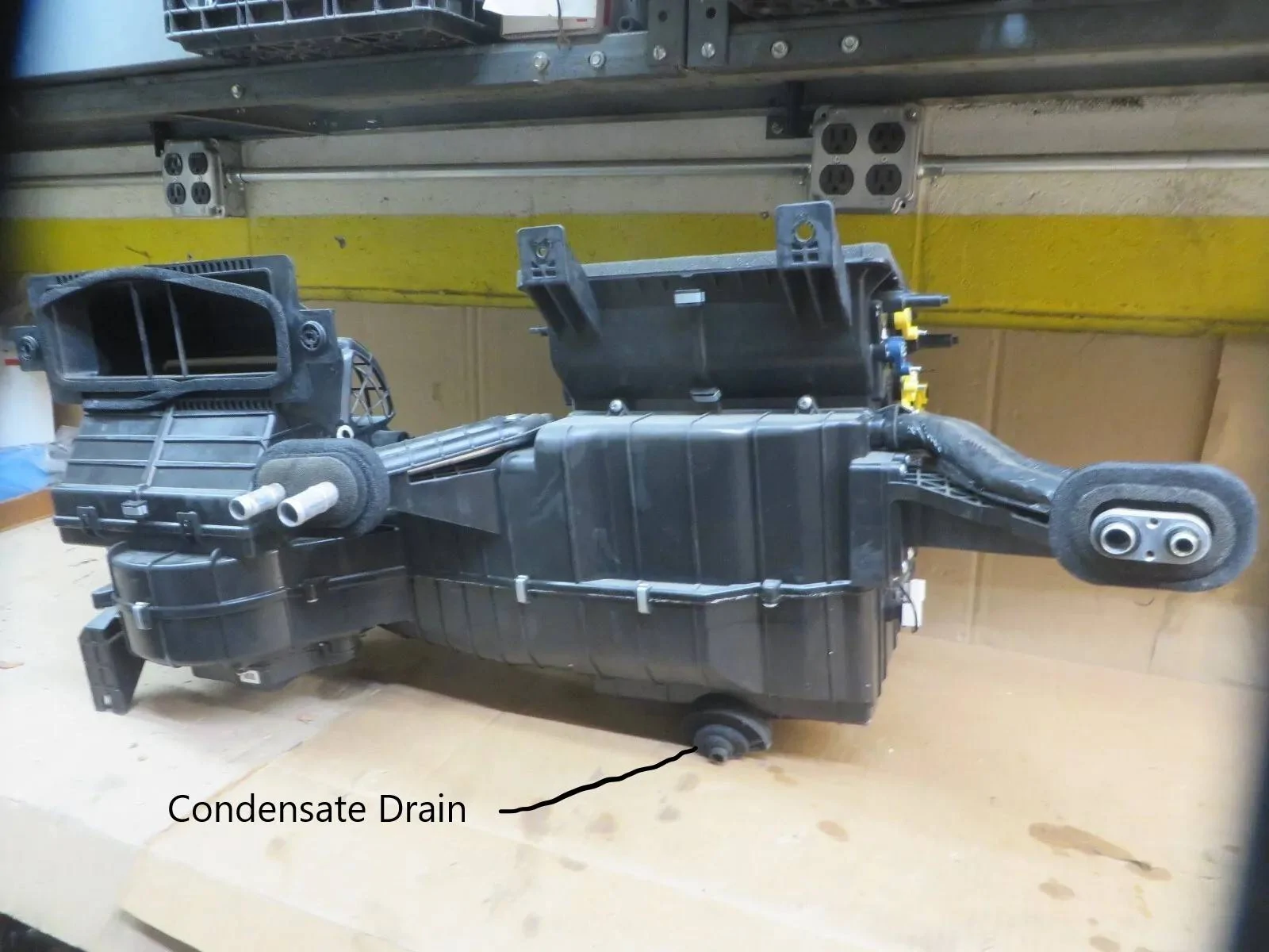

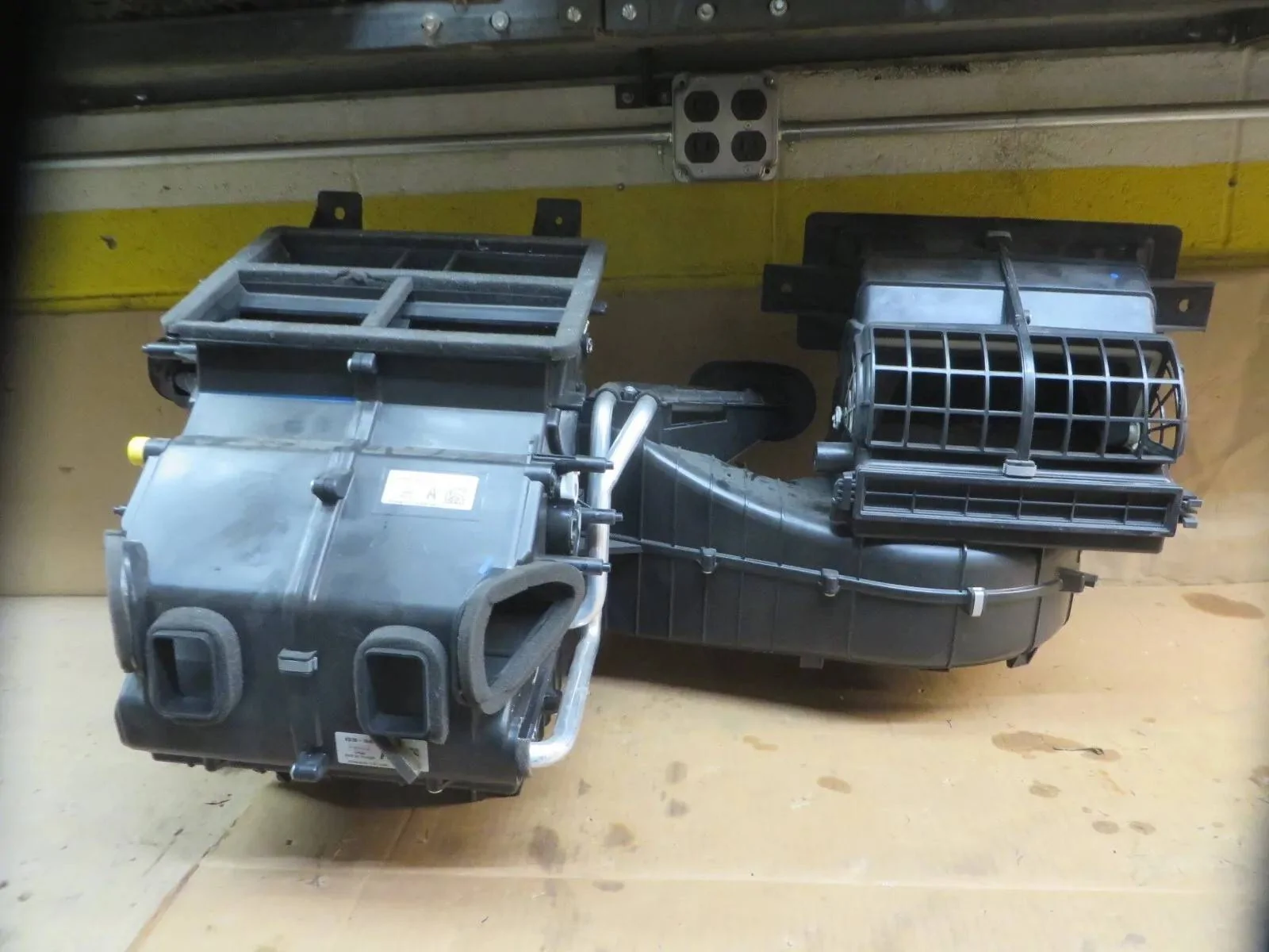

Basic Airflow to the Bottom of the Unit, then controlled by the various doors.
Note: The Location of the Heater Core
Picture this housing fully enclosed as it is mounted on the main unit.
There is constant airflow across the EVAP and Heater Core (at all times)

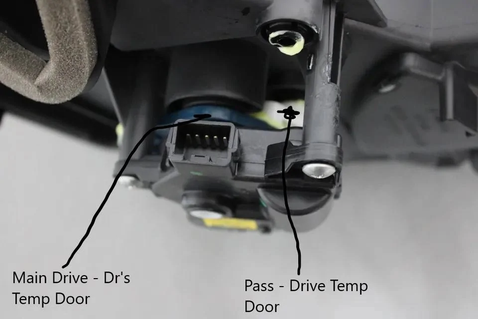

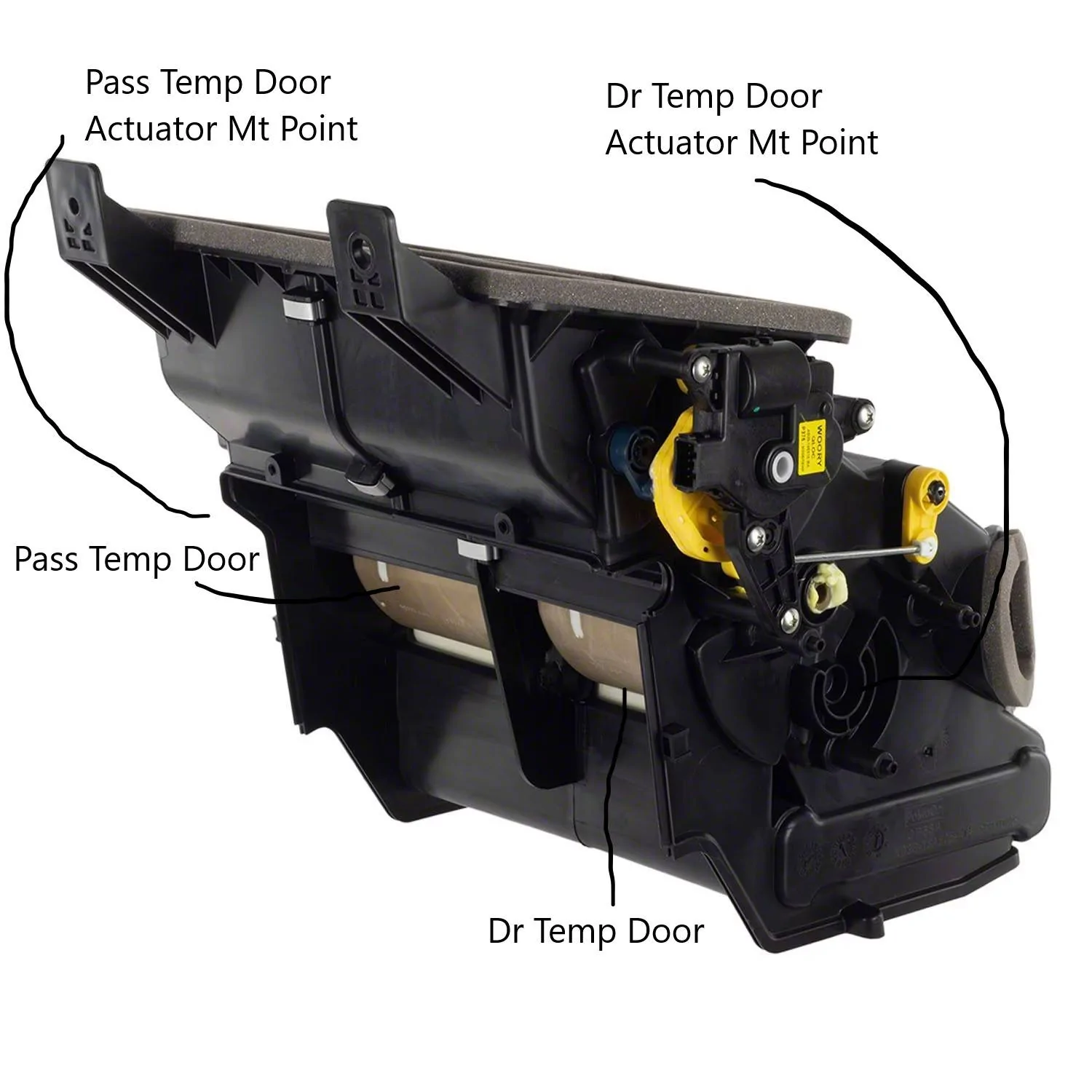

Here we can see the Drivers & Passengers Temp Doors (Aka Blend Doors)
Dual Climate will have (2ea) Doors - With Individual Control
This pic shows (Electronic Manual Control) Single Zone
So Automatic (Dual Zone) will have 2 Temp Door Actuators mounted on each side (as depicted)
Single Zone - Has (1) Actuator mounted on the Pass Side and controls both doors via a Bell Crank driving a lever (similar to the blue lever pictured)
The White Lever off of the Passenger Single Zone actuator moves the Driver's Temp Door
Electronic Manual Control (Single Zone)
Example of Dual Automatic Control

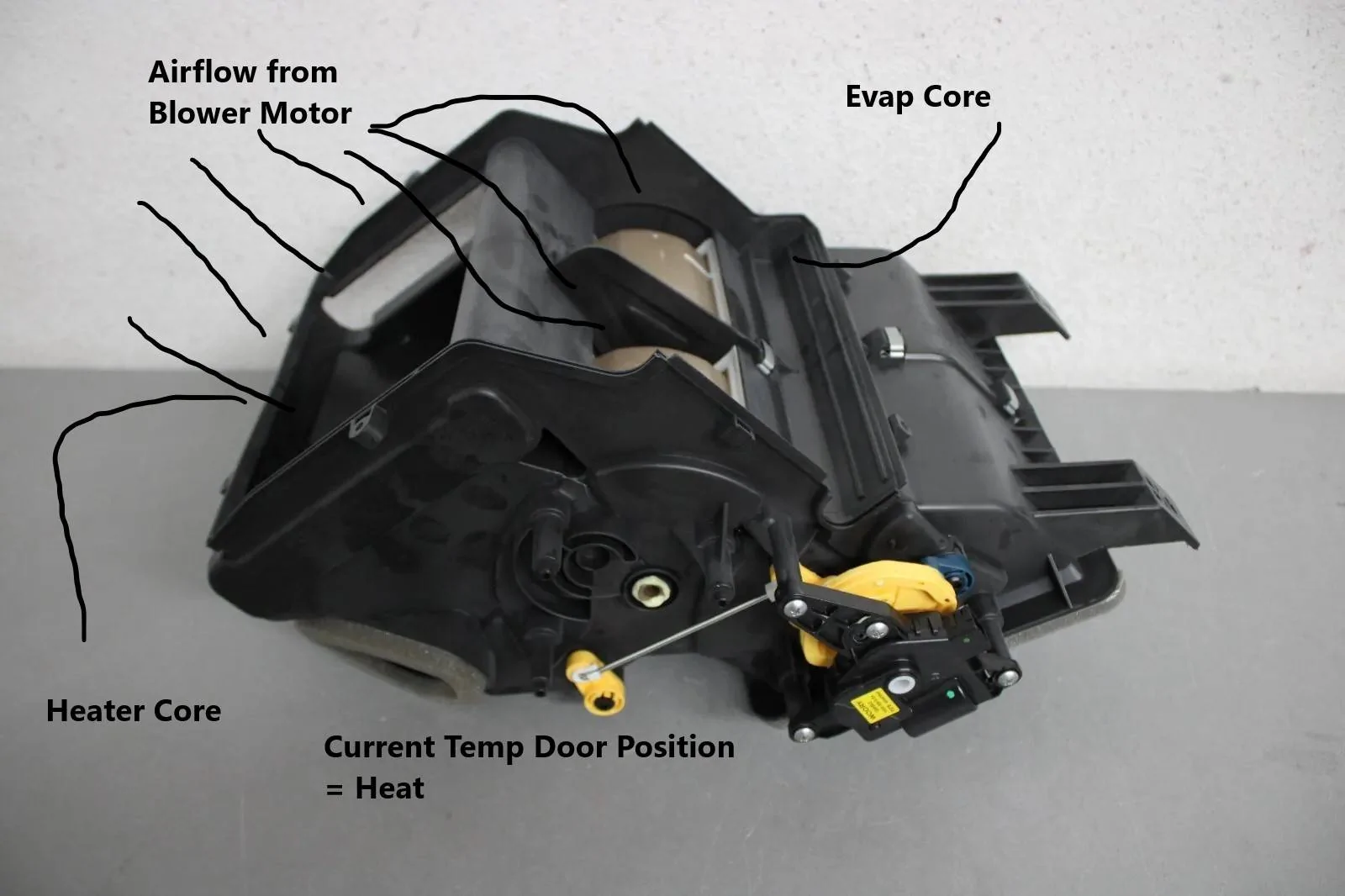

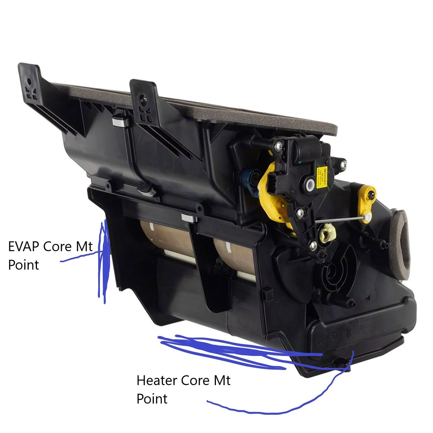

This shows where the Evaporator Core and the Heater Core, Mount to the HVAC Unit
This is how the Temp is regulated between the Cold and Heat
EVAP Core mounts to the Vertical
Heater Core mounts to the Bottom
If temps are not high enough for AC, then this would just be blended air coming from the Air Inlet and the amount the doors are open will dictate the amount of heat is allowed to be taken off of the heater core.
Airflow will travel around the heater core for heat.
or
Airflow will travel around the EVAP Core for AC
The (Open) amount of the Temp Doors adjusts the amount of Heated Air that is allowed into the duct work to the cabin.

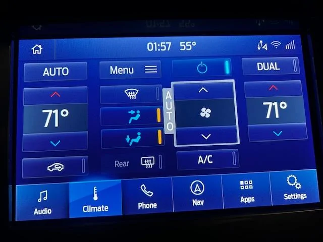

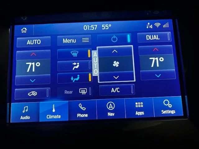

EDIT From Original Post:
To fully understand how to get B-Level Airflow
Being that the climate screen would be too cluttered by adding more buttons here they give you the option of Bi-Level Air by:
1. Floor / Panel = With FLOOR selected, you can press the PANEL button, this will select Bi-Level air.
or Vice-Versa the buttons.
2. Floor / Defrost = With FLOOR selected, you can press the DEFROST button, this will select Bi-Level air or Vice-Versa the buttons
When in Bi-Level mode, you will see both selections highlighted.
The only air distribution mode you CANNOT select is Bi-Level - PANEL / DEFROST
Example: Pics For Reference
2 buttons will be highlighted in (Bi-Level) Mode
Auto Control:
Auto Control and Primary Venting (Mode Position)
In AC or Max AC - Primary Output = Panel Vents
In Heat Mode - The Primary Output = Floor Vents (Heat Rises), the system will however adjust vent (mode) output depending on outside temperature and selected temperature.
I believe that the deciding factor is - If the Cabin Temp can be (COOLED) lower that the Outside Temp, then it will automatically switch between AC and Heat.
So, this would be somewhere NEAR 60 Deg (Outside Temp)
Ref Pic for Demister Vents (Location)

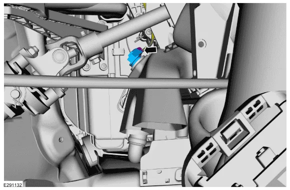

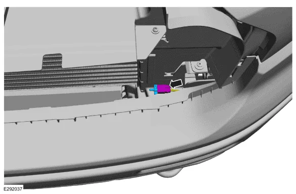

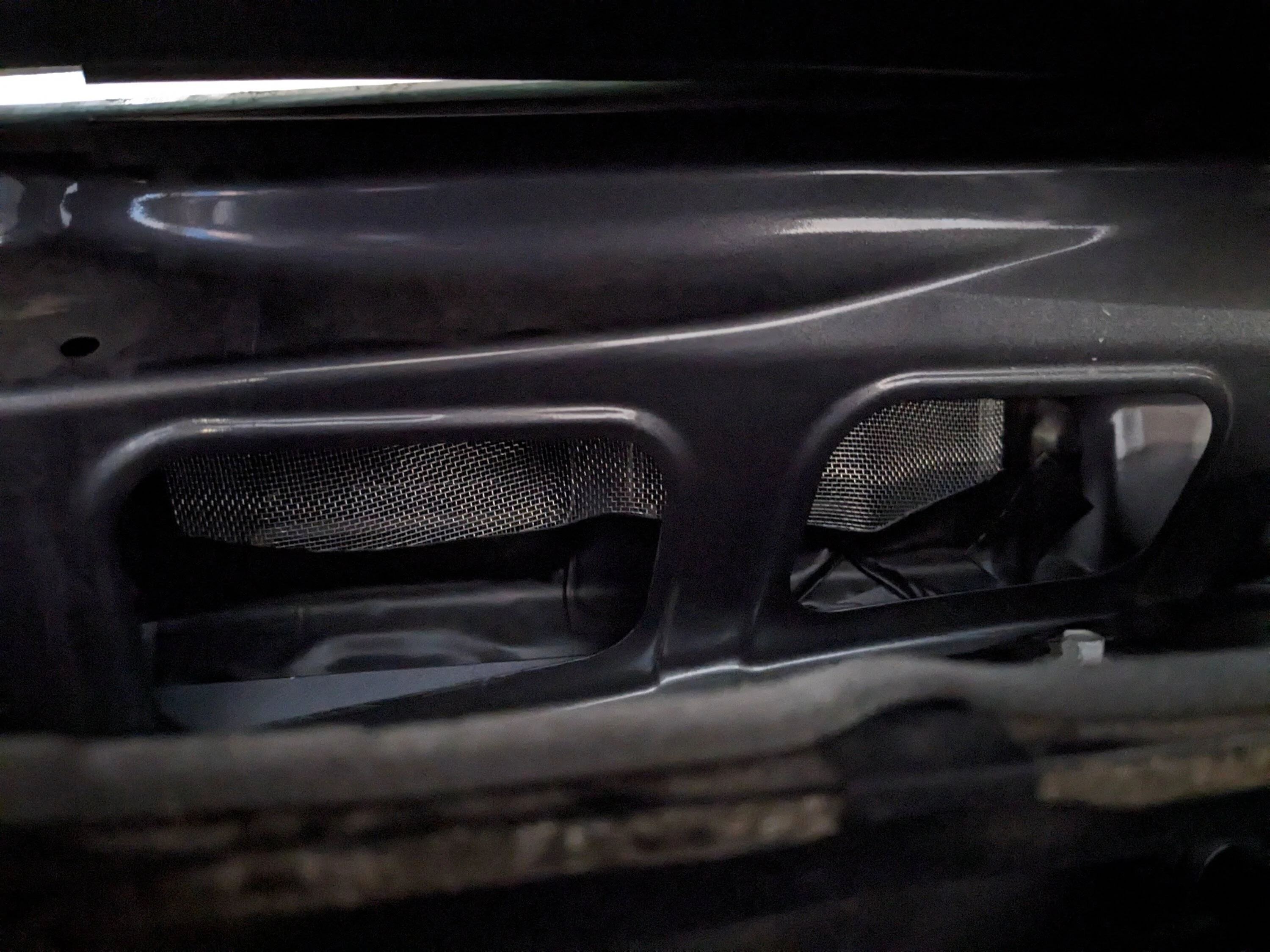

Ambient Temp Sensor (OAT) - Location (Front Grille Area)

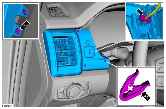

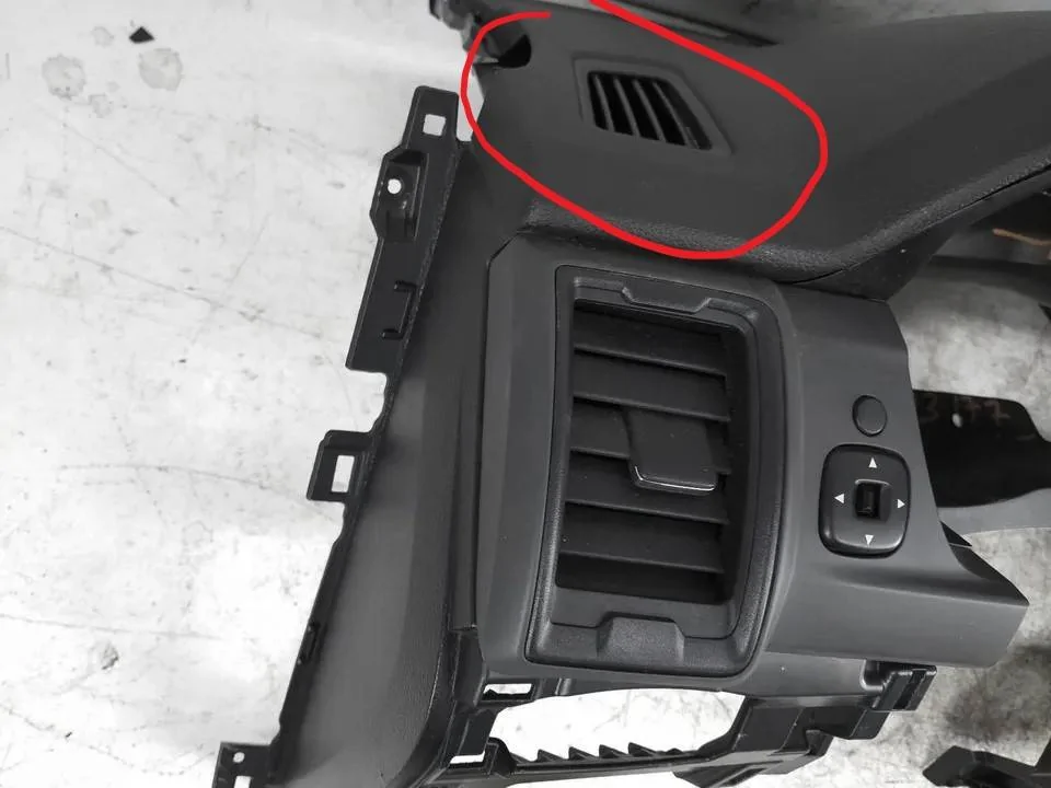

2. Temp / Humidity Sensor - This is the feedback sensor, and it reads actual cabin temp and humidity level of the cabin.
It is mounted by the Ignition Switch, as airflow is pulled across it (via a small electric fan) it is sampling cabin air temp and humidity.
From what you have selected on the Sync Screen let's say 72 Deg - In Dual Auto
The location of the Temp / Humidity sensor is on the driver's side.
The system is designed to maintain the selected cabin temp, now in Auto mode it is attempting to get the overall cabin temp (Mixed) to 72 Deg as fast as possible.
So, this will explain why the Driver's Side and Passenger Side - (Felt) temps may be different. (say in Heat mode)
It is balancing the cabin air temp.
Due to the many complaints about the Passenger Side (Feels Hotter) then the Driver's Side
This is what is happening.
The Passenger Temp door is commanded open a little farther to allow more heat into the passenger floor, you should note a rough (5 Deg) difference between Dr and Pass)
The reason for this is it is pushing hotter air into the passenger floor that will push to the driver's side and mix together then and when the system determines that the cabin temperature is able to maintain 72 Deg (Equally) then the Passenger Temp door closes some to equal the driver's temperature.
Now (IF) you select different temps between the Dr and Pass, then the Temp Doors will adjust accordingly open or closed to maintain the desired temperature split. (by controlling the amount, the Temp Door is opened or closed)
The Humidity Side of the Sensor - Controls the Air Inlet Door Actuator (Aka) Recirculation Door
If it senses high humidity, it will auto open the Recirc Door (If you are in Recirculation Mode)
The recirculation door operates as described above in the control section.
There is another sensor that can play a part in the automatic control of the Air Inlet Door and that is the Sunload Sensor (Below)

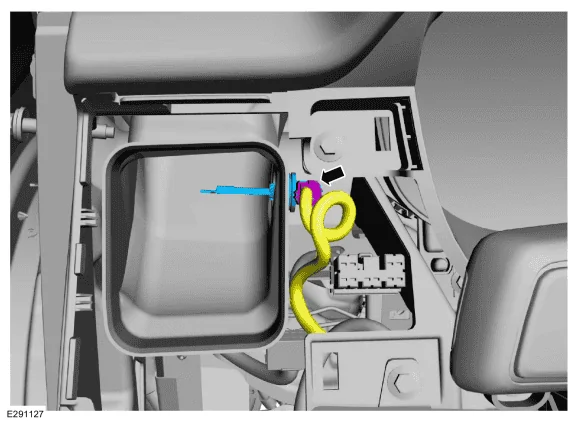

Temp / Humidity Sensor - Location
You will see a small vent on the dash at this location - Inlet for the sensor

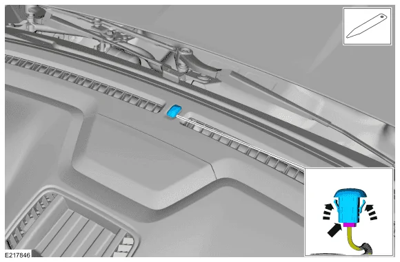

3. Sunload Sensor:
This sensor performs double duty.
In the HVAC system, it measures the Sunlight intensity such as direct sunlight and calculates that when in direct sunlight the cabin temperature will be hotter than the actual outside temperature.
The sunload sensor supplies information to the FCIM indicating the intensity of the sun on the vehicle. The FCIM compensates high sun load with higher blower and reduced discharge temperatures. (so places the system in MAX AC, and drives the temp to full cold and blower speed to high (Automatically)
In the Dual Automatic System, during hot weather, it will automatically set the system in:
--MAX AC - Mode the system is using the Sunload Sensor as an input and it (Closes) the Recirculation Door, this is how the Sunload Sensor ties into the Temp Humidity Sensor which is the main sensor that controls the Air Inlet (Recirculation) Door, the Sunload Sensor is a (Seconday-Input) for control of the door.
The other job of the Sunload Sensor - Not Related to the HVAC, it is controlling the Auto Headlamps (On or Off)
Sunload Sensor Location (On the Dssh)

Condensate Drain - Location
Now due to the location of where this exits the firewall, it is near impossible to see from the engine bay.
The condensate drain drops just on top of the transmission bell housing and the top of the transmission holds most of what you normally see dropping on the ground when you park the truck.
But some owners have experienced blockage of the drain and the outcome of this is Condensate pooling up in the bottom of the HVAC Case and overflowing through the seams in the case and dumping it out on the floorboards. (MORE NOTED) in a turn

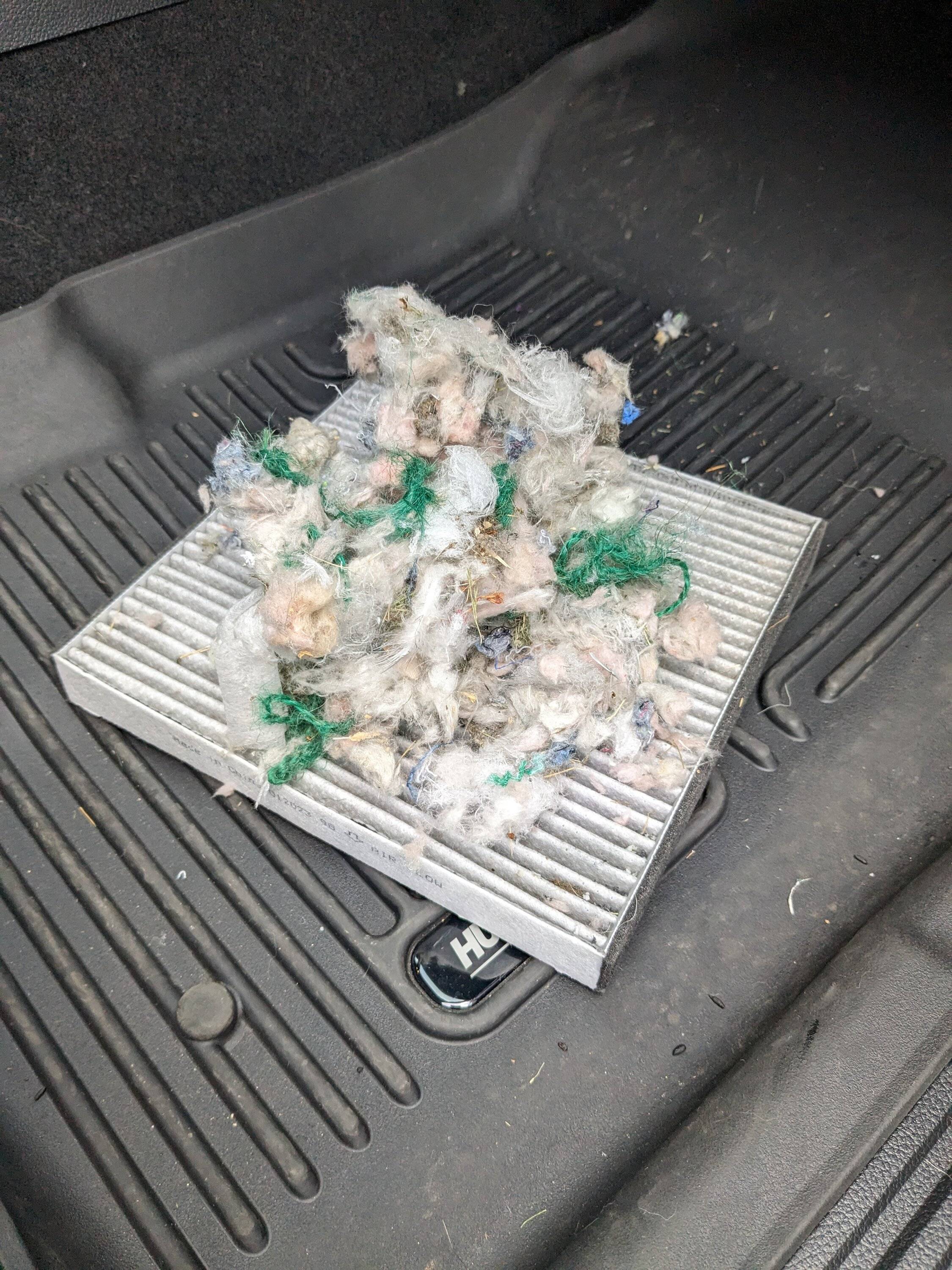

Dirty Cabin Filter or blocked Air Inlet (Leaves / Nests)
Evap Core Frozen (Iced Up) - During AC Operation - Summer Ops
Blower Motor - Housing (Squirrel Cage) - (filled with leaves / nests) or Blower Motor issue itself.
Mode Door Actuator, not moving to exact commanded position.
or an issue with the Bell Crank not moving the issued (mode) door correctly such as Foot Lever
This MAY or MAY NOT - generate the Popping / Clicking sound.
Piece of Debris - such as the foam that is used to seal the panels and doors and ducting connections, may have become dislodged and blocking the ducting airflow.
Piece of debris - that made it past the Cabin Air Filter - Leaves Etc and was sucked into the HVAC Box and now lodged and blocking the ducting.
Note: The Mode Door Actuator is moving 3ea sets of doors. (Defrost / Panel / Floor)

Temperature Issues (Aka Blend Doors)
If you have popping or clicking coming from under the dash when you are raising or lowering the temperature selection
Then it may be an issue with either Temp Door Actuator (Dr or Pass)
Note: Dual Climate has (2 Actuators) - Elect Manual (Single Zone) has (1 Actuator) that controls both side
The easiest way to check these actuators is to place the system in manual and drive each door full travel (full Cold to full Hot)
and note any popping and or clicking and feel the outlets for temperature rise or fall.

First: A Quick Review of Air Distribution
Panel:
Primary = Panel Vents (Strong Airflow) + Secondary = A VERY SMALL amount to the Defrost Vents Demist Vents and Floor Vents (Very Little Airflow)
The Recirculation button is enabled to allow you to press it to close the Air Inlet Door, but only for 5-Minutes, before it defaults back to open.
Floor:
Primary = Floor Vents (Strong Airflow) + Secondary = A VERY SMALL amount to the Defrost Vents Demist Vents and Floor Vents (Very Little Airflow)

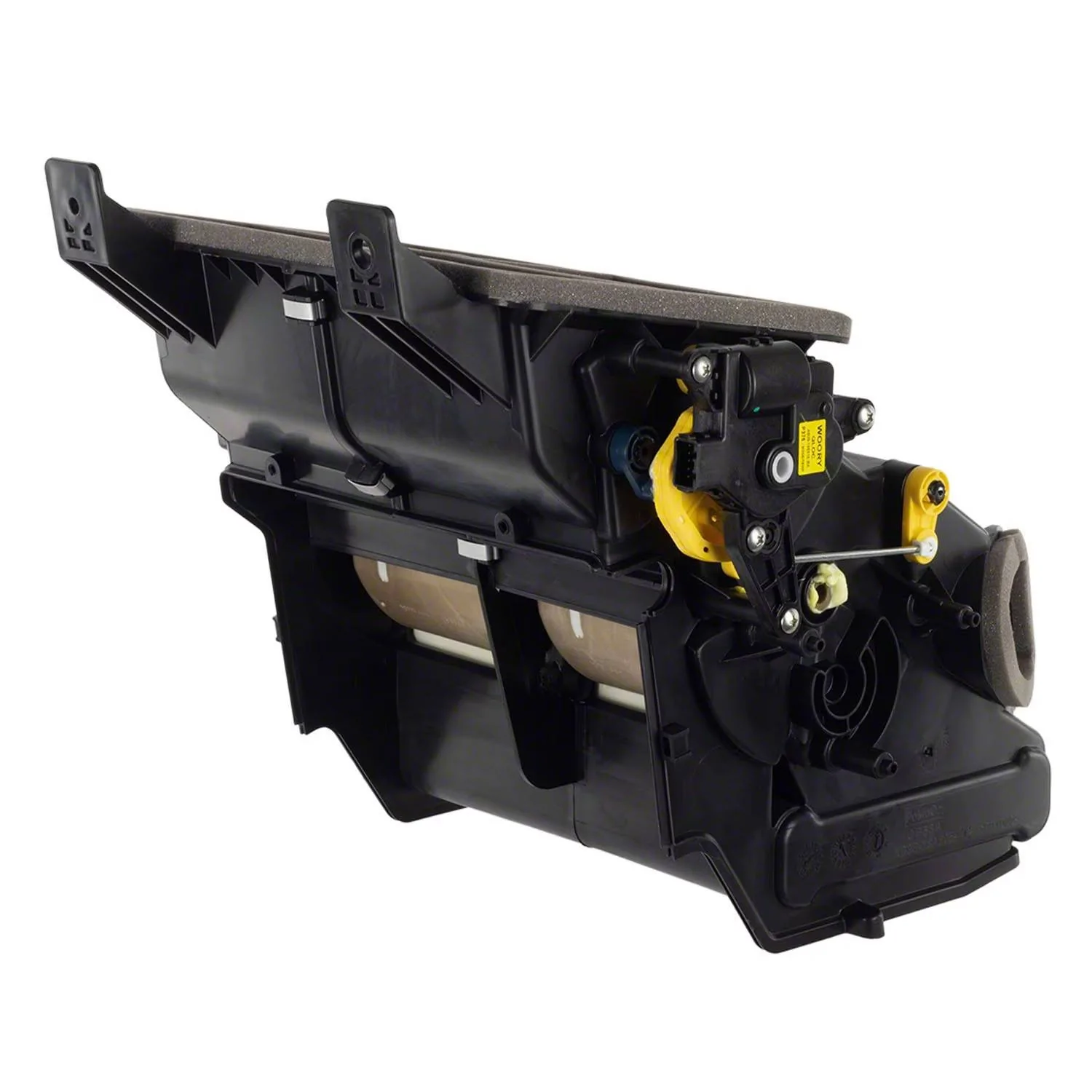

The Mode Door Actuator- Can be replaced - But the Steering Colum, has to be dropped out of the way to replace it.
The Service Manuals do not even cover this actuator replacement and it is buried so dropping the steering column out of the way should give you access to it.
The Drivers Temp Door Actuator Can Be Replaced - But (per the service manual) The steering collum has to be dropped out of the way to replace it.
However, with a little finesse and patience and drilling an access hole to get one of the mounting screws it can be done without dropping the steering collum.
The Passenger Side Temp Door Actuator can be Replaced by Removing the Glove Box. (Moderate Access)
The Air Inlet Door (Recirculation) - Actuator can be Replaced by removing the Glove Box (Easy Access)
To replace the Doors themselves or the Heater Core or Evap Core:
The entire HVAC Assembly requires removal, this requires the whole dash console to be removed to get access.
To replace the Cabin Air Filter - Remove the Glove Box - Easy Access
To replace the Blower Motor - Easy Access - From the Passenger Floorboard

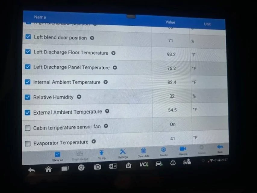

Let's Look at Scan Data (Live Data-PIDS) Related to the Climate Control System
Using my Autel 906TS - Scanner, most High End (Bi-Directional) Scanners have these PID's available.
I have not checked the Current Forscan Release, but as of yet I do not think Forscan can show these.
This shows Live Data of the FCIM (Front Control Interface Module)
This is where the Climate Control PID's are located.
This is just Overflow PID's related to the HVAC (The 2 unchecked) PID's at the bottom of the screen.
Showing the Cabin Temp Sensor Fan - On (Running) and the EVAP Core (Temp Reading)
Notes: For T/Shooting the system
In Manual Mode- you can select each position and they should match the readings below.
In Manual Mode - you can select Temperature up and down and watch the percentage raise or lower, you are looking for the percentage to increase or decrease without glitches or popping and clicking.
The most important is looking for FULL TRAVEL - 0-100%
Air Inlet Door Position:
The Air Inlet Door has 3 Operating positions.
Open - 100% - stays in this position the majority of the time.
Partially Open - 48% to 52% (uses this position at certain times) dependent on temp and humidity.
Closed / Recirculation (ON) - 0% - Closes when the Recirculation Button is selected but after a programmed (5-Minutes) it opens back up to 100%
In Max AC - It Closes 0%
With Truck Off - The Air Inlet Door Moves to 48% - (Partially Open) - (For Air Circulation - Ventilation In the HVAC-EVAP Core)
With System Turned Off (Truck Running) - The Air Inlet Door moves to 0% (Closed)
Note: Even when Closed (0%) the door is still about 10% open - this is to allow some fresh air into the Cab

Left Discharge Panel Temp:
The is the discharge air temp as measured in the Driver's (Left-Panel Vent)
Left Discharge Floor Temp:
This is the discharge air temp as measured in the Driver's Foot Vent
Depending on what mode you have selected - Floor / Panel / Blend - Temp Readings will vary, but for testing.
T/Shoot Note: If you are seeing an odd reading - Try removing and cleaning the sensor it may be dirty.
Heat:
In Manual Mode - Drive the Temp (HI) and you should see around 180 Deg in the Floor and around 165 Deg in the Panel with the engine at operating temp.
AC:
In Manual Mode - Drive the Temp (LO) and you should see a low Panel temperature reading, the actual reading will vary due to the ambient temp and humidity.

80 Deg Day - Output Temp 45-50 Deg
100 Deg Day - Output Temp 55-60 Deg
The basic average is 35 to 40 Deg lower than the Ambient (Outside Temp)
External Amb Temp - Should match OAT Temp, using your phone etc, this is the temp displayed on the Sync Screen
Note: If the truck is sitting in the hot sun, it may take a few minutes of driving to get an accurate temperature reading.
Internal Amb Temp - This is the Temp/Humidity Sensor, this reading will vary and dependent upon the selected temp and the discharge temperatures from the panel and floor temp sensors.
Once the Cabin has reached a balanced temperature say 72 Deg, the sensor will read actual cabin temp and humidity.
Relative Humidity: Ties into the above, except this is the Input that controls the Air Inlet Door (Auto-Opens) if you have Recirculation Mode (Selected)

The Temperature Control of the system wiring is a complex 5-Volt Reference system, and it is monitored by the FCIM so it can open or close the Air Inlet Door (Temp & Humidity) Monitoring.
and also control the system in (Automatic) Mode
The 5-Volt Reference wiring circuit entwines all the temperature sensors and door actuators on
the same circuit.
This allows the system to automatically move a door and the rest of the circuit knows exactly what position it moved to.
The door actuators are a 5-wire circuit.
3-Wires - 5-Volt Ref -V Ref Return - and Signal Wire (to move the door) (Feedback)
2-Wires - Are the Bi-Directional Power / Ground for the actuator motor
Depending on the direction the motor is commanded to move CW / CCW, is to which of the 2 wires are power or ground.
The command signal to move the door comes from the Feedback signal wire.

Great, and thank you! One thing that always confuses me. Not sure, but i assume the recirculation is tuned on when the button is lit up, correct?
137,177
Yes if the lights on it recirculating. I always use the touch screen for the HVAC controls because it's hard to see the buttons below. Or I'll turn on the lights which helps to see them better. 🤓
