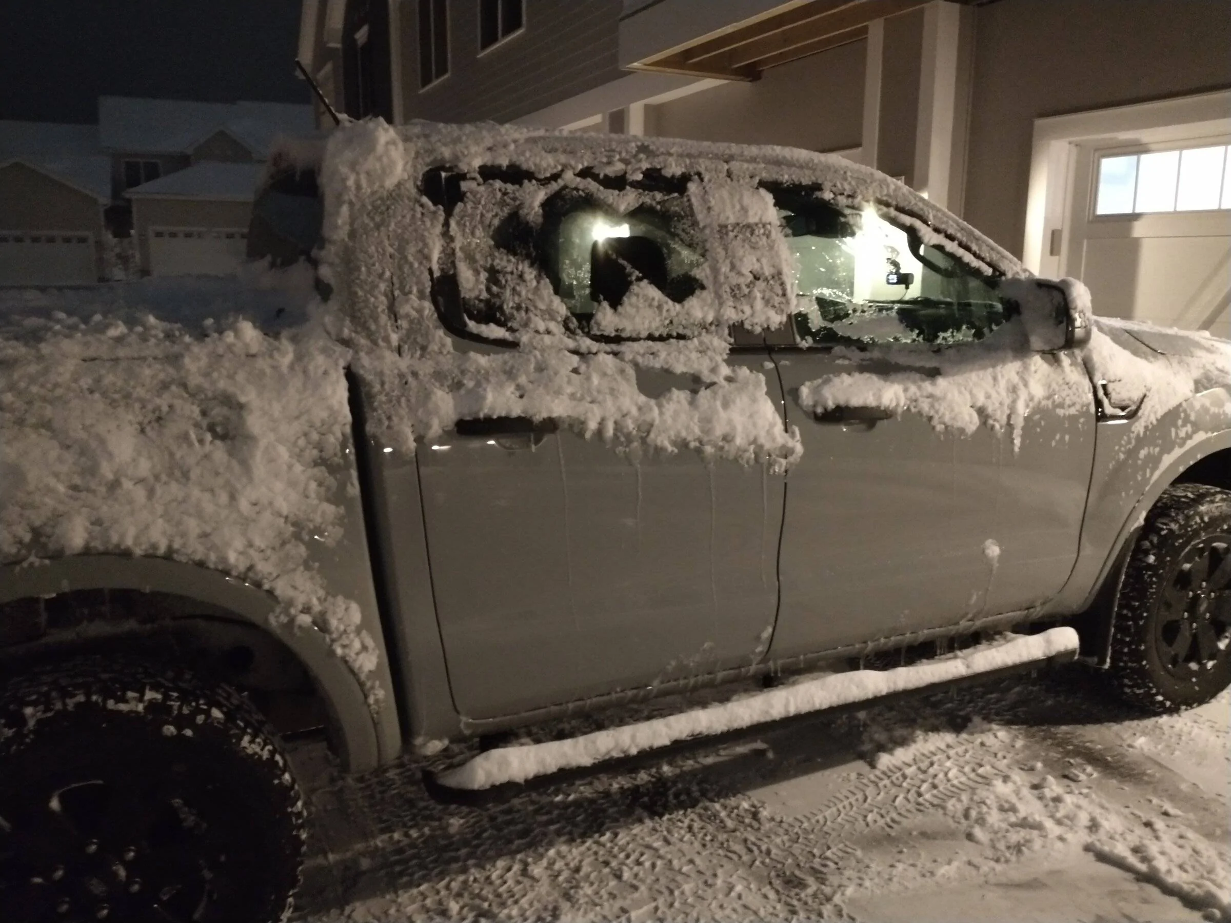

I drove in some slop/slush yesterday and my truck sat overnight in below zero temps.
I warmed the truck up for 15 mins and started driving and it was making a clicking noise from the front drivers side when I turned left, not with each rotation of the tire, it was less often than that. It almost reminded me of binding when in 4X4 at a sharp turn but I was in 2WD and it was more of a noise than it was a thump (a little thump).
Was worst at full lock to left.
At first I thought maybe it was hitting some ice in the wheel well, but when I got to work there was no build up in the wheel well.
It got up to 10 degrees now and I went outside and took it around the parking lot, it made the noise once and now it seems to be gone.
Anyone else experienced this?
