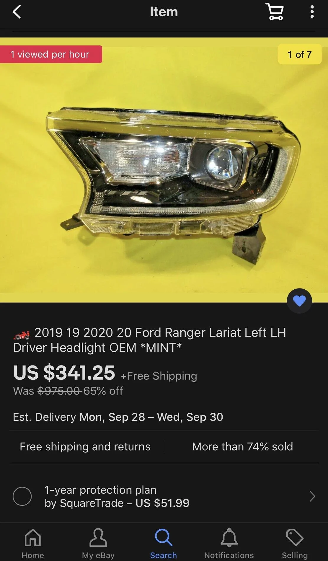

Just wanted to share some information. I have been considering doing this upgrade but the funds and just not there right now. Anyways, I added several *mint* condition ones to my watch list on eBay and the seller has sent offers for 50-65% off the listed price (see image). The seller is rendrmtionautoparts.
Thanks Steven and Vince/RangerVA
Got a pair for $400 with tax - with some broken tabs. Hopefully I can figure out a fix!

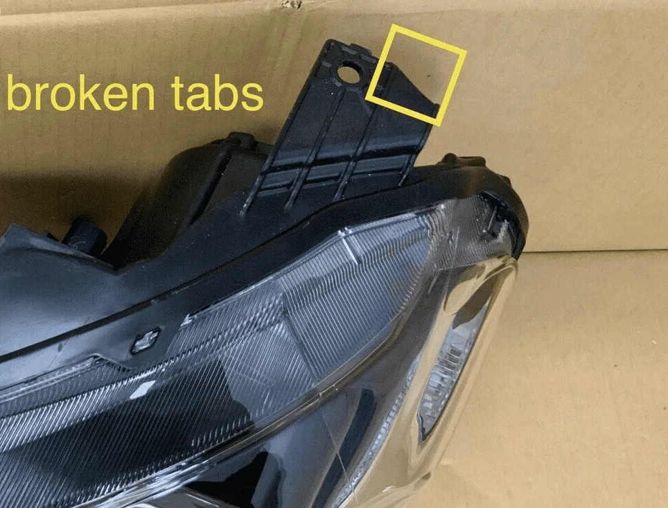

You can see the minor damage to the corners and I forgot to mention one of the lights had a missing cap, which I just took off the old headlights and put on the lariat.
Vince
Mine are in the mail and have same broken tab. Did this cause any issues?

Ok another broken tab question - the other light I have coming is missing this tab, outermost at the top. This is the one that uses the phillips HD plastc clip. I cant for the life of me figure out why that is even there!?
I am assuming I dont need to worry about it but as an engineer its DRIVING me crazy as to why they would design in a tab without any function. Much less needing 2 clips per truck to fill the hole!
It goes thru the fend sheet metal, so maybe alignment to the fender?
Phil can you shed some light!
That’s the same tab my lights were missing.Mounted with zero issues,and are rock solid.
