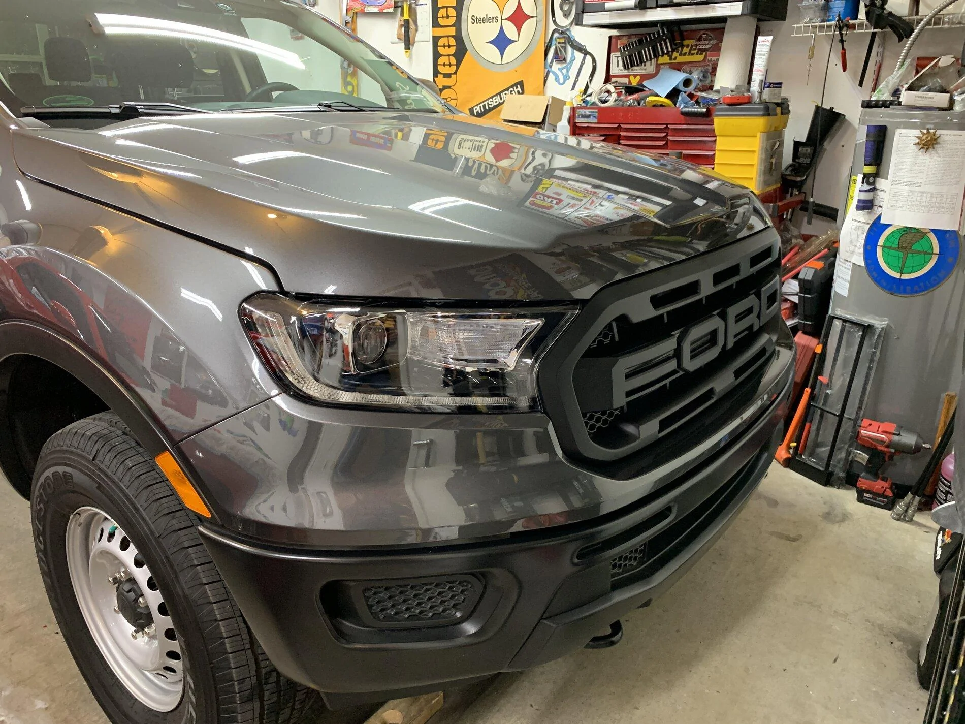

Well I finished the swap. Shout out to @earsmccoy for the video and making it look too easy. Ha ha. My advice is just take off the skid plate then the two end valence bolts are easy. The forscan settings in post 121 work great. Thanks all for sharing the wealth of knowledge.
Looks great! Nice job.
