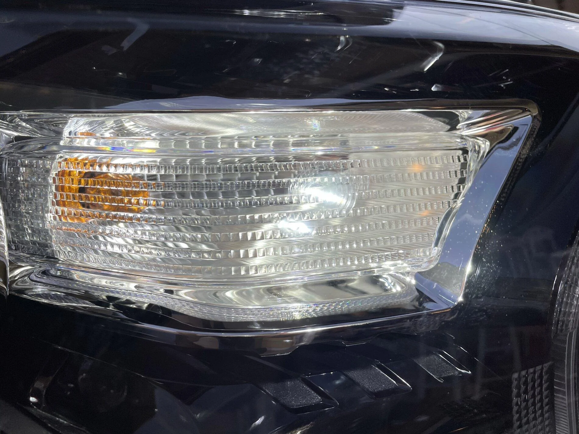

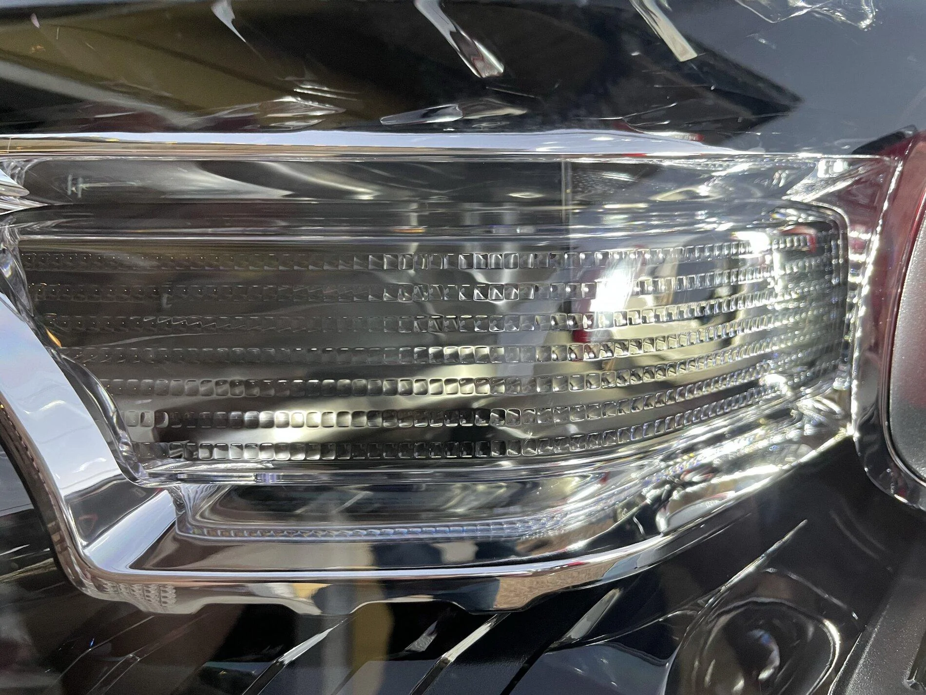

Just got mine swapped over and noticed a problem. There seems to be a manufacturing defect in my left Lariat headlight. :( The reflector inside the turn signal housing seems to be missing completely. Not broken, just...gone. Ugh. I didn't even notice the difference until I got them all the way in. They both work perfectly, it just makes the driver turn signal dimmer.

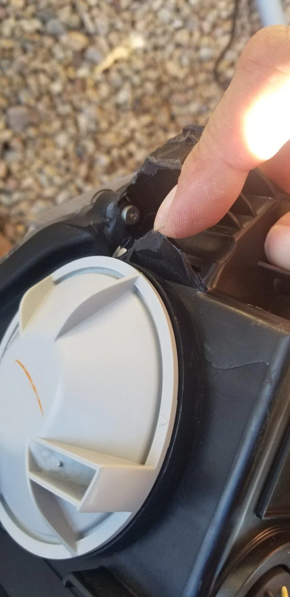

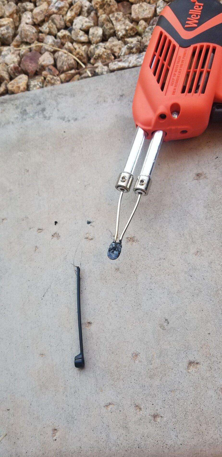

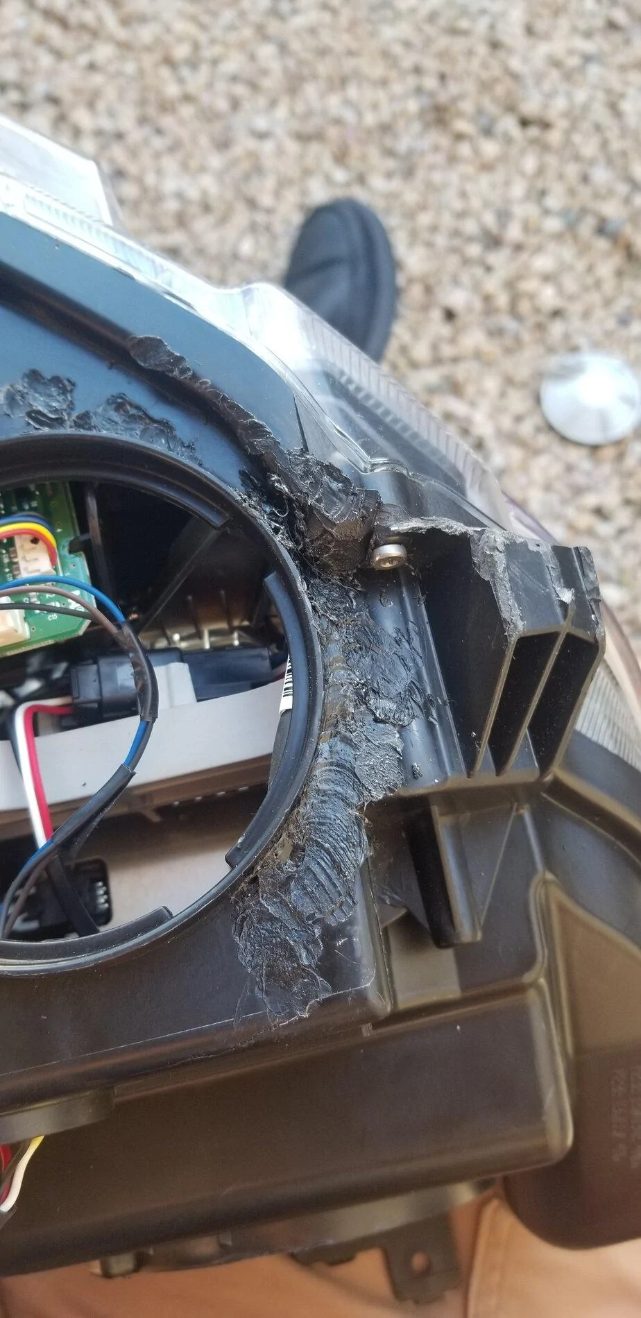

Fixed a crack and small hole in one of my used Lariat housings using a soldering gun and a zip tie as 'filler rod'. Worked great. By the way, if you buy a used housing that doesn't have the cap on bottom you can use one off your halogen housing.

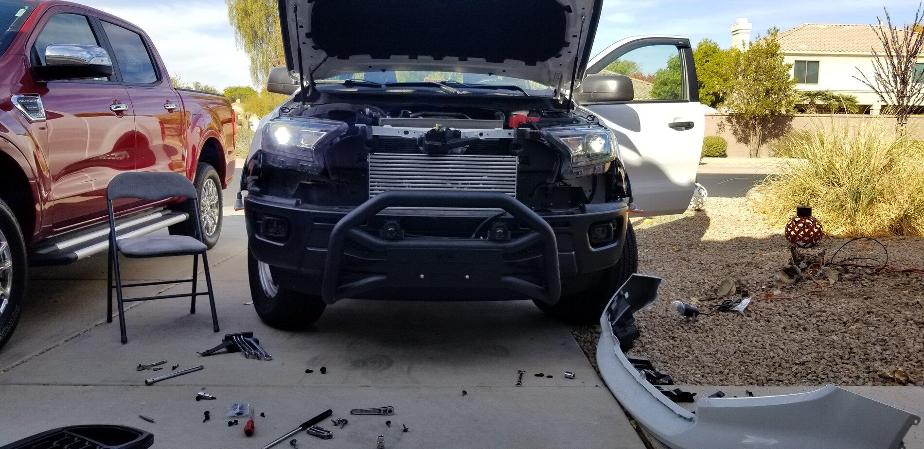

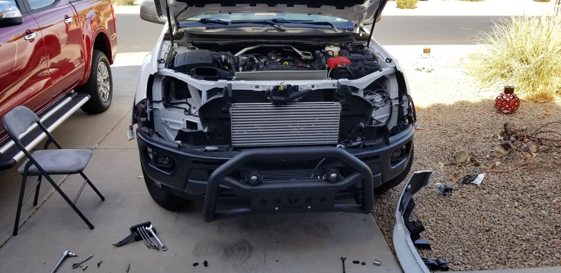

I swore a little and bled a little but I got them installed. Might go for a night ride later.
