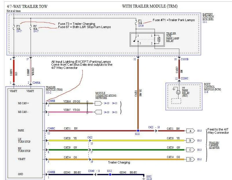

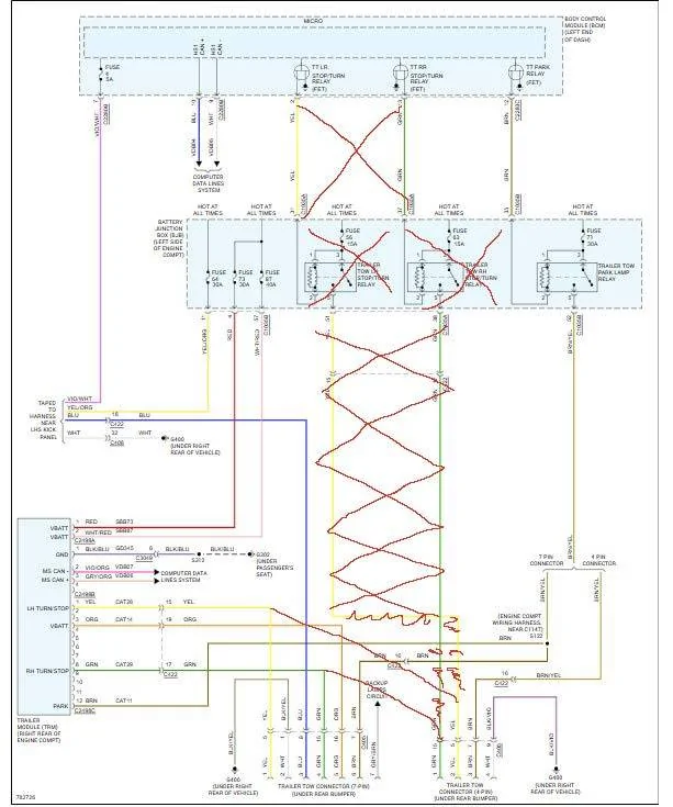

I dug into this and confirmed the wiring diagrams for the Trailer Lighting Circuit is misleading
and all available diagrams are wired as such.
I have a Lariat -With the TRM & 4/7 Way Connector
I along with others were confused by the factory wiring diagram that made it appear the relays were on all trucks, that is not the case

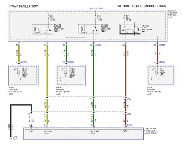

If you ONLY HAVE the 4-Way Trailer Connector - The wiring is as such and the included relays
and your truck came from the factory with (ONLY) this connector
Now
If you have the TRM & 4/7 Way Trailer Connector there is not a full circuit diagram that is correct
So we have to look at 2 separate diagrams and note that the Trailer Stop / Turn Relays are removed and not used - It uses the TRM for that.
However, the Park Lamp Relay - is still used and we gain another relay (Trailer Back-Up Lamp) Relay
So, If your truck came from the factory with a 4/7 Way connector (it includes a TRM)
The TRM takes the place of the (Trailer Stop/Turn) relays that are noted in all wiring diagrams and misleading that the (4-Way) of the 4/7 Way connector routes to the BJB & Includes those relays in the circuit (They are NOT-INSTALLED) and the TRM provides that relay function.
The Park Lamp - Relay and the Back-Up Relay are the only relays in the BJB when you have the 4/7 Way Tow Connector and associated TRM.
The 4-Way side of the connector is spliced into the 7-way wiring, the wiring diagrams do not depict that.
I have to split it up into 2 diagrams.
But this should make it clear now and this is how the 4/7 Way is wired
Note: I edited this from the original post
So, for the OP if the Left Trailer Turn is not working and the others are. It's not the fuse.
It's the TRM or Wiring
Now

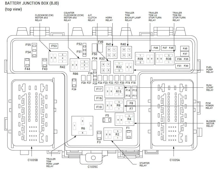

Ok, can you look at both of these pics and note on the 1st pic - if the relays (R39 & R38) are installed.
If they are installed, then - Fuses 56 & 63 - Should also be installed.
Fuse 56 = Trailer Tow LH Stop / Turn Relay
Fuse 63 = Trailer Tow RH Stop / Turn Relay
Then Note:
Relay (R40)
This should only be installed (if the TRM) is also installed
Trailer Tow (Back-Up Lamp) Relay
And
Note Relay (R6) Trailer Tow Park Lamp Relay
This should be installed on either (Option)
and
Fuse 34 -Trailer Tow Park Lamp Relay
For Reference my 2022 Lariat - Does NOT have Relays (R39 & R38)
and only has the (R6 & R40) Relays with Fuse #34 Installed for the Top View

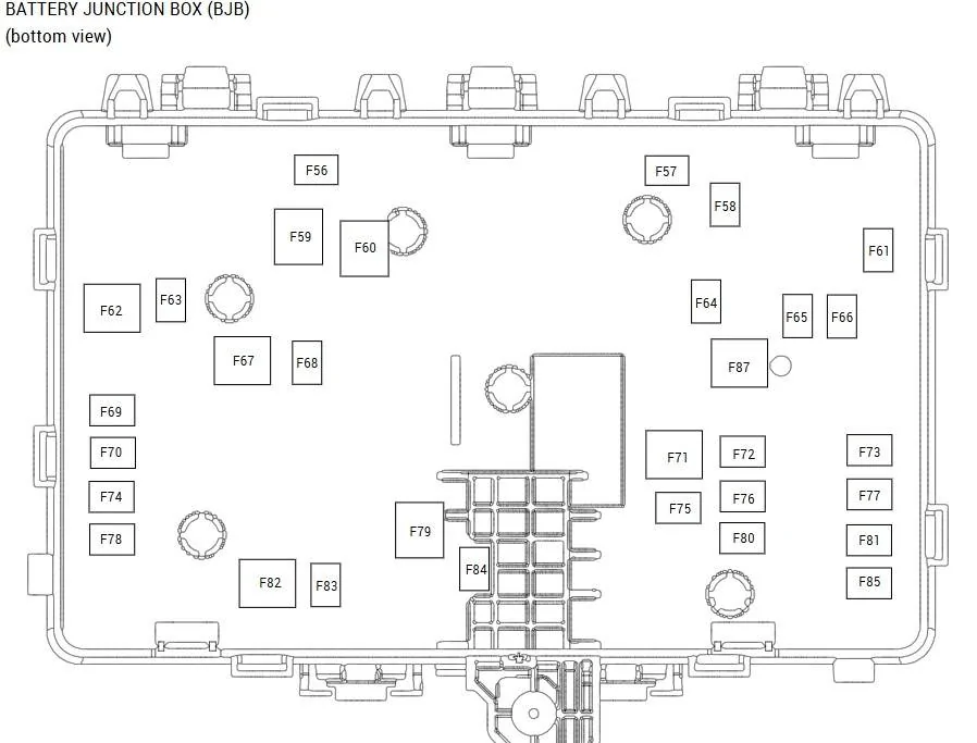

This is a pic of the BOTTOM side of the BJB, you MUST REMOVE the BJB and pull the cover off of the box to access these fuses.
Fuses 56 & 63 - Feeding Relays R39 & R38
Fuses 73 & 87 - Feeding the TRM
Fuse 71 - Feeding Park Lamp Relay
This pic shows (Fuses 56 & 63) Empty and (Fuses 73 & 87) Installed
It also shows (Fuse 71) Installed

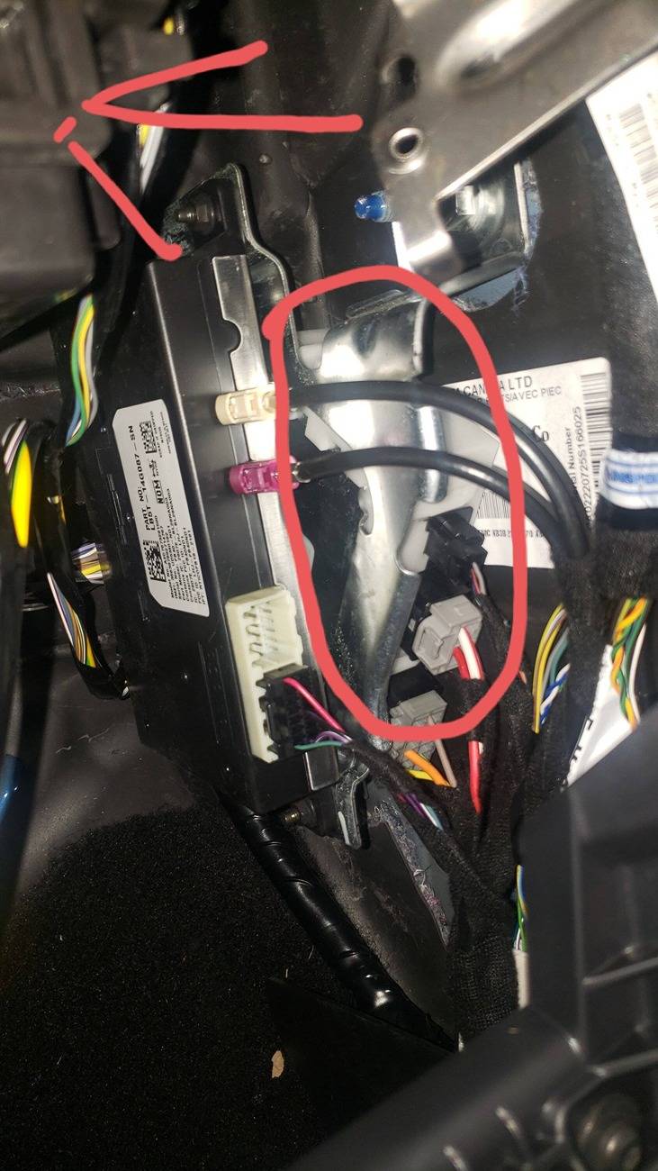

In the Right Passenger Kick Panel - you will see the TRM (Circled) If Installed

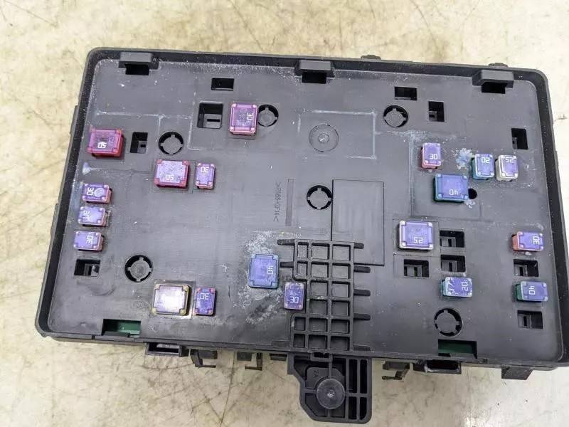

With using Ebay as a reference to the BJB (Engine Bay Fuse Box) and noting that all US version rangers at least pictured with the cover (OFF) all show the R38 & R39 relays removed, however the (ROW) Rangers have them.
A second confirmation is using the Ford Parts Diagrams, the part number of the BJB only changes for Rear-Wheel-Drive Trucks and With or Without Parking Sensors, all 4WD show the same Part Number.
So, with that guidance and reflecting back on a previous thread and trailer wiring.

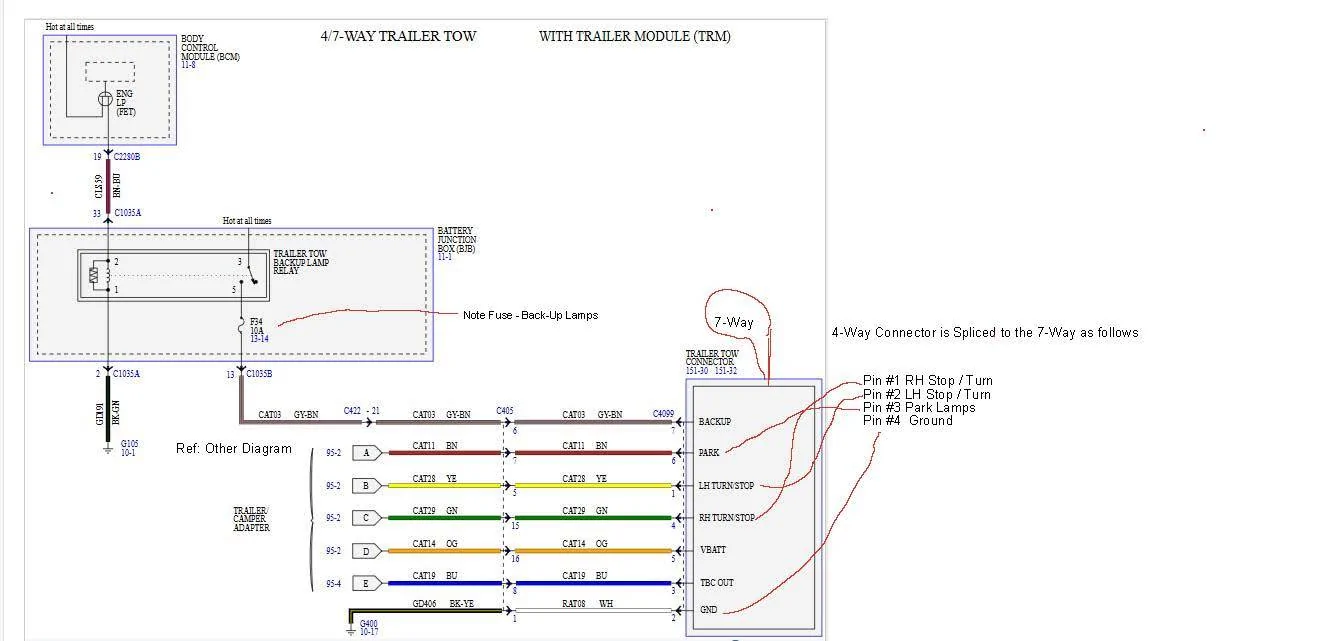

I am fairly certain (ALL) US Version Rangers have the TRM Installed, and the (configuration) difference point is at the C405 Connector (This changes the wiring harness part numbers) from C405 (aft) to the trailer connectors either (4-Way) or (4/7 Combo) the Rear Parking Sensors also come into play with those part numbers.
So, either configuration 4-Way (Only) or the (4/7 Way - Combo) the LH & RH Stop / Turn lamps are routed through the TRM.
The TRM (4/7 Way) Option will add the (Reverse Lamp) Relay into the circuit as well as Trailer Charging.
Both configurations use the (Park Lamp Relay)
This is how I see it being actually wired and unless I am wrong as someone with a (US Version) Ranger and without the TRM and having the Relays (R-38 & R39) Installed would have to chime in, as the documentation I see so far - That is not an option for the US Version Ranger.

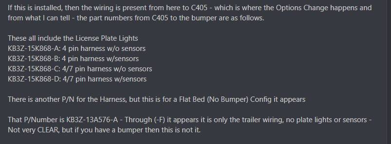

from a previous thread - this is the Harness part numbers for C405 Rearward to the Trailer Connector. (Options)
If the TRM is installed, then these are the harness part number options to add the 4/7 Way trailer harness to the truck.
