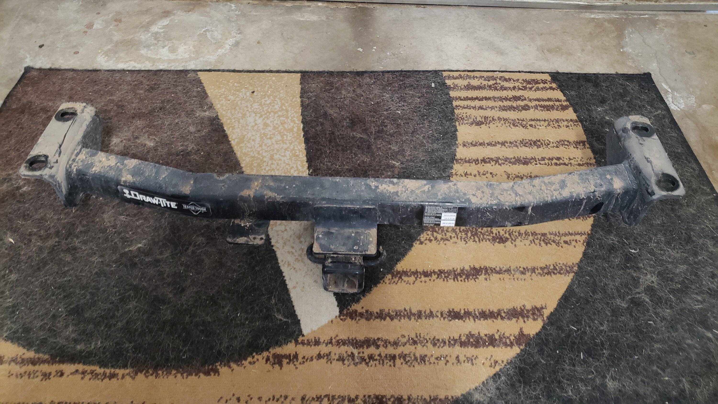

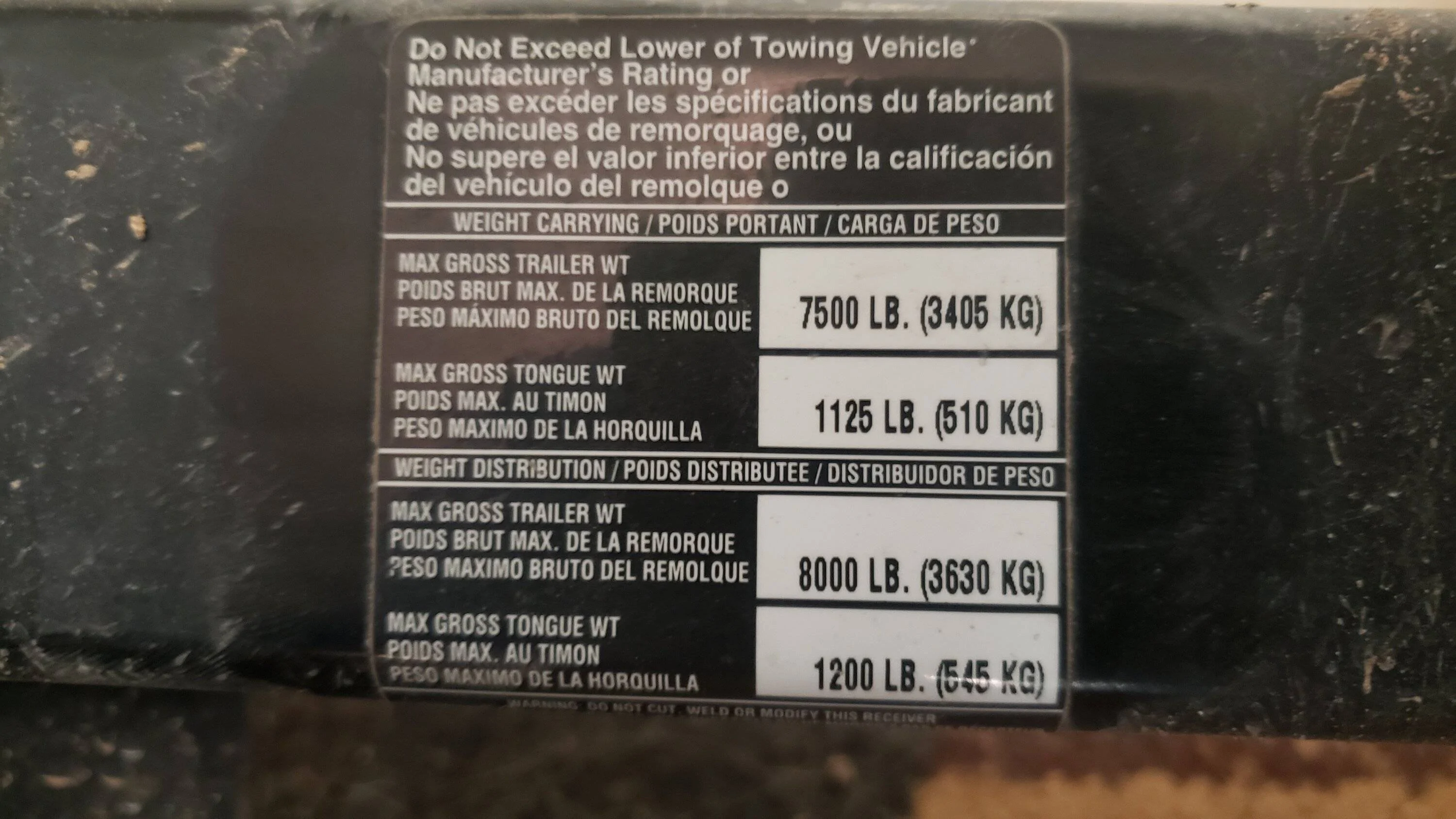

I have a receiver hitch you can buy. Just took it off my 2020 ranger 2 days ago. Selling cheap! 50 bucks
