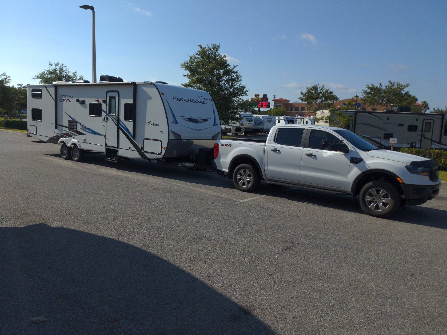

Just an update if anyone still cares lol. I have taken my 33' 6,000 lb dry freedom express on about a dozen camping trips. I have had 0 issues and 0 scared. The ranger handles it without any issues. It's a very capable truck and very happy with the Ranger.
I have had about 8 people approach me at the campsite asking me how the Ranger handles the trailer and towing such a big trailer and I let them know I have no issues. I have probably sold ford 4 Rangers by now lol.
Hope everyone is enjoying their Rangers!! I know I am!

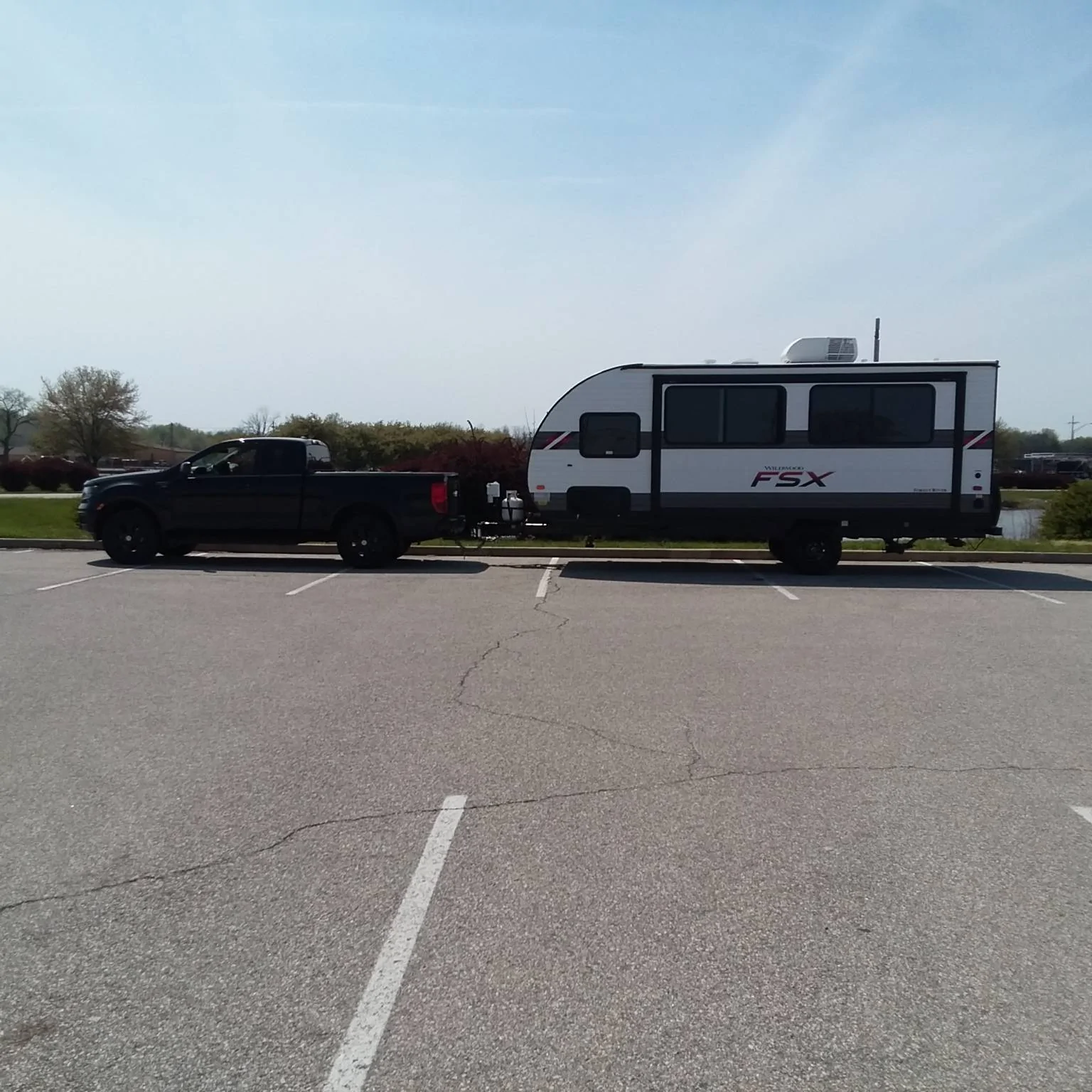

I did a experiment last week on a short camping trip, little over 200 miles , central Indiana, pretty flat, 99% interstate. 23 ft , 5000lb camper. Stayed at 55 mph. 16.6 mpg. previous trip about 400 miles, 63 mph 12.5 mpg.

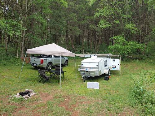

Did about 250mi with my teardrop last weekend. Drove on I-40 over the Appalachian mtns and got about 21mpg.
Honestly I think about the biggest camper I'd be willing to pull any distance would be something like a Casita. Sure, the Ranger CAN pull something bigger, but if I get a camper, I want to do actual road trips with it. Not just pulling it a few miles to the nearest family campground. No way I'm dragging a behemoth halfway across the country with a little Ranger.
I also like to be able to put my camper in quiet, hidden little spots like this and getting too close to the max rating on the truck makes that a sketchy prospect.
Other than the gas mileage going down, how'd the truck handle while towing?
Great, no issues at all.
Handled great. No issues at all. I use a Anderson WDH which works very well with my truck and camper combination.
