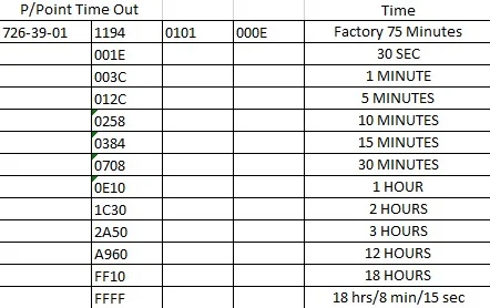

Factory = 75 Minutes
Can be changed via Forscan (BCM)
However, this would be for a normal (truck off) condition
Technically they should still remain powered as normal, but there is not a detailed diagram or description of what is powered or not powered during a Flat-Tow.
We know that it is imperative to ensure you are in Tow Mode, and ensue the ignition is truly (Off) and not in Accessory. It ties into the Transmission Relay, not getting powered.
By referencing the various posts of - Major Issues from either improper Tow Mode set-up or the truck itself pulling itself out of it.
I would think that Ford would have included a more detailed description of Tow Mode - Power distribution.
Basically, the information in the Owner's Manual for Tow Mode is all you get
This is another Ranger feature I wish I could get detailed info on, other than this is how you get it into Tow Mode, I would like to know specifically what it does to get it into Tow Mode

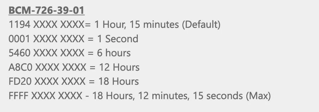

This is the settings for Forscan to change the timeout on the aux sockets, but be sure to have battery power from the RV to preclude draining the rangers.
