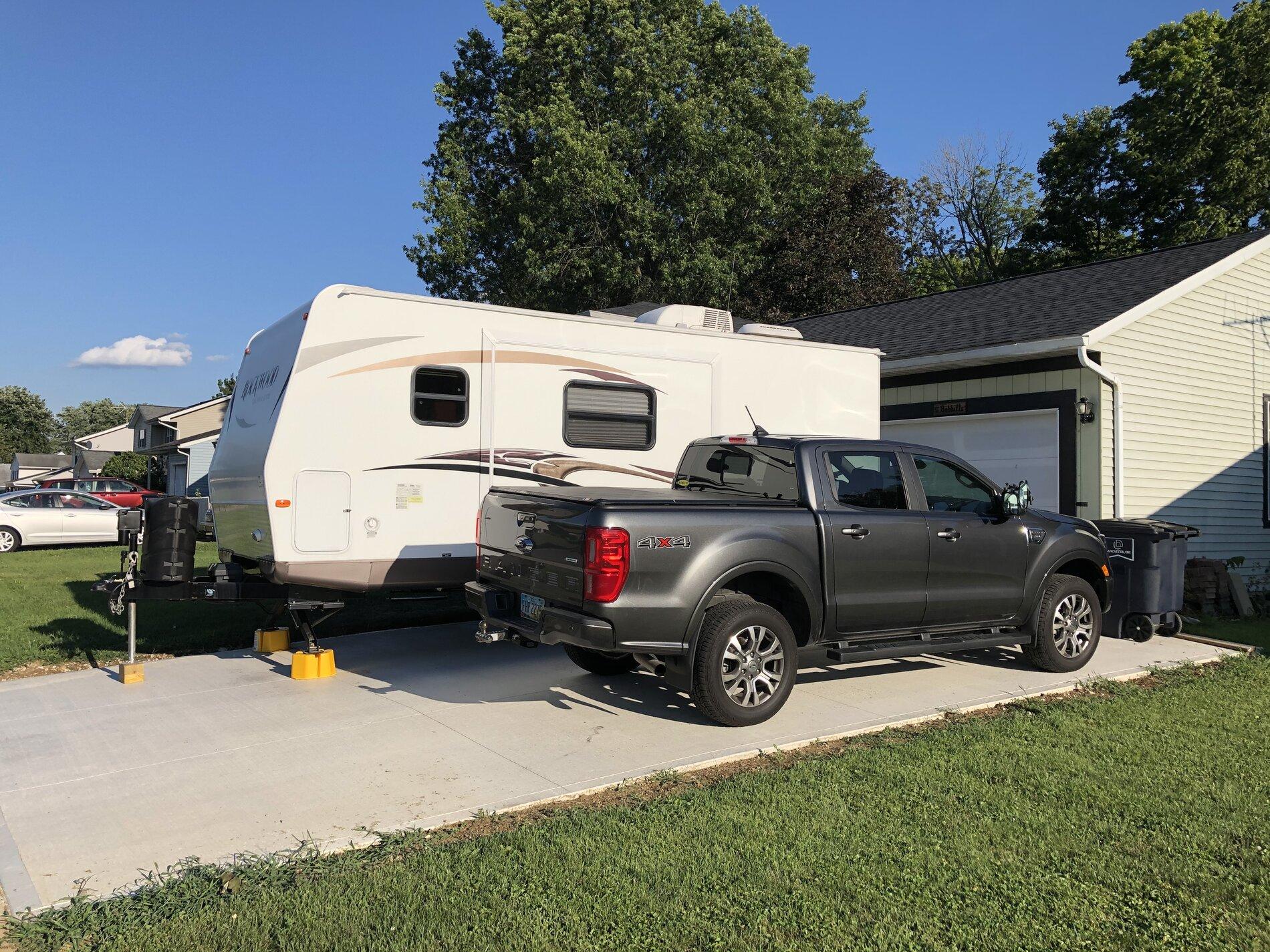

I tow a Rockwood 2304S just fine without weight distribution hitch or anti sway.
23.75 ft
Dry 4,605 lbs payload capacity of 1800 lbs
Hitch weight 661 lbs
Using the Ford Tow Pro Elite.

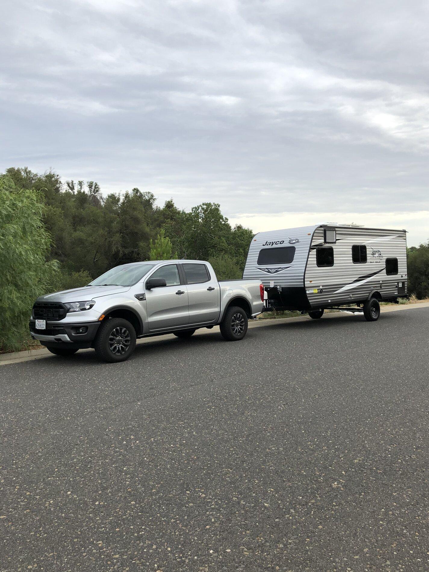

Just bought this Jayco. Tows and stops easy.
Me too! That trailer is actually the reason I bought my Ranger.
I had a '16 KIA Sorento SX with 3500 lbs towing capacity and 350 lbs max tongue weight. I expected the trailer to be around 3050 lbs (2945 lbs on the website + I was told about 100 lbs extra for fiberglass exterior). I was okay with a 3050 lbs trailer since we'd have well under 450 lbs cargo and therefore not reach the towing limits of the vehicle.
When the trailer arrived it turned out to be a 2021 model which apparently grew to 3075 lbs (130 lbs more than 2020). And the fiberglass exterior appears to add 160 lbs, not 100 lbs like I was told. Our trailer's sticker shows it as 3237 lbs dry. That left me only 263 lbs from the limit of the vehicle without even adding any cargo.
It actually towed pretty well, but even without any cargo in it there was a lot of rear sag in the vehicle. When I looked into getting a weight-distribution hitch to level it, I realized that the weight of the hitch itself would put me way over the max tongue weight of 350 lbs, which I was already uncomfortably close to.
Now with the Ranger I don't have to worry about any of this! :)
