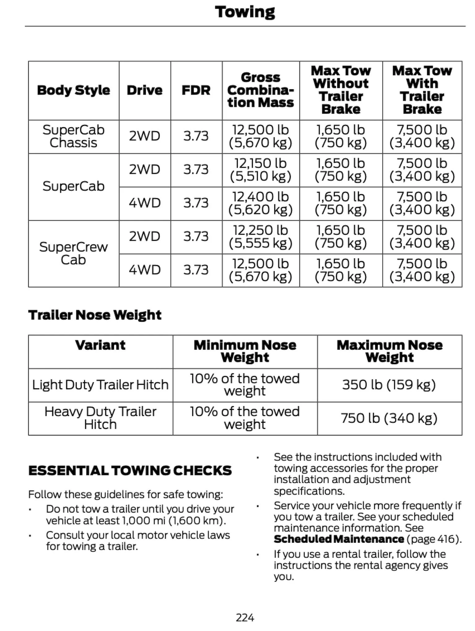

From the Owner's Manual:
There is section of the TOwners Manual explaining GAWR GCWR info etc found on your door sticker, starting on page 221.
Ford also has a free Trailer Towing Guide HERE. It is recommended that you install trailer brakes for large trailers; several threads on here for that. Many states require them for larger trailers
