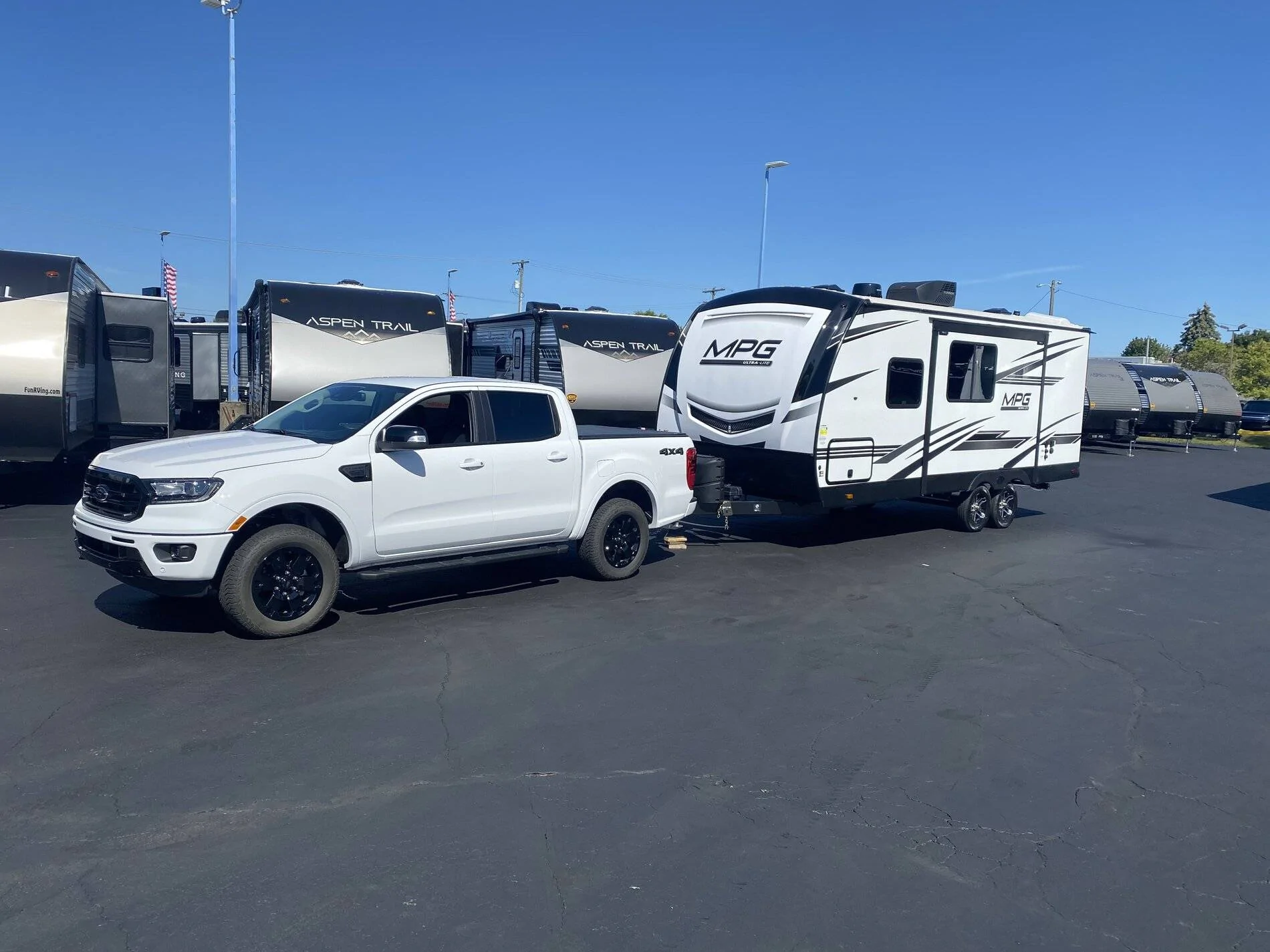

I am using my 2021 Ranger Lariat to tow my Cruiser MPG 2100 RB. I have not towed it far yet, but I never tow it with water in the tanks, we load it up as most would. It is just me, wife and 20 pound dog. We carry what most do without a lot of extras. No issues so far. I do have the Blue OX sway/equilizer hook up. My dry weight of my trailer is 5500# but I figured after loading it with bedding and supplies, we are about 6300#. Hitch weight is about 700#. It seems to pull it nice, but we are planning on a trip from Michigan to Pigeon Forge next summer. Has anyone towed down I 75 south near Kentucky/Tennessee border with a similar set up? I plan in sticking around the 55/60 MPH range as we will be in no hurry. Just curious about the elevations and what to expect.

That's a great looking setup, looks like a perfect trailer for us too! And we also have a 20 pound dog! That's the little terror in my profile pic.

I highly recommend you take truck & trailer to a truck stop weigh station, or even a moving company, as many have their own scales. (It would have been great to have done this before you loaded anything in the trailer). Weigh both truck (full of gas & any extra gear including wifey), & trailer while hitched together & then each separately. (I don't believe you need to take the dog cause you already know what she weighs)!!!
This will take the surprise element out of any of your adventures.

Nice looking setup. sounds like a trip to Dollywood. Mine rig is about 4200 loaded and I towed it out to Arizona and back to Wisconsin last year. Did several 6% grades with no problems both up and down, the Ranger is a towing beast. You should be fine, just use tow mode and lock out 9th and 10th gears. Being a turbo elevation really does not affect the Ranger much. Just be prepared for the gas mileage, figure about 10+ pulling that much frontal area. Staying under 65 will help, going over that and the mileage goes down quick. The suggestion to weigh your trig is a good one. You then know where you stand and can make adjustments to the hitch, and loading, if necessary.
