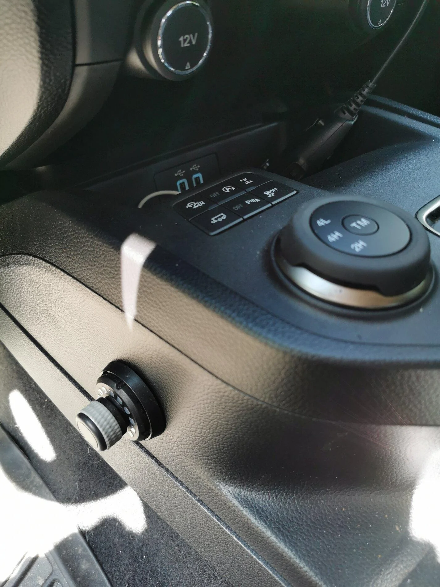

I tried to keep things simple and safe.
I self-installed the Spectrum:
https://www.amazon.com/gp/aw/d/B07CZTXL8P/ref=cm_cr_arp_mb_bdcrb_top?ie=UTF8
And paired it with the generic connector harness that goes with the Spectrum. (Curt # 51515). Instructions for the connections are all over this forum and I found it straightforward.
For ease of wiring and handy access when I need it, I screw mounted it to the side panel and think its a good blend of being available but not in the way.
There's lots of options out there, and as long as it 'controls' the trailer brakes and works for your budget, then it's done its job. 😉
Have a great trip!

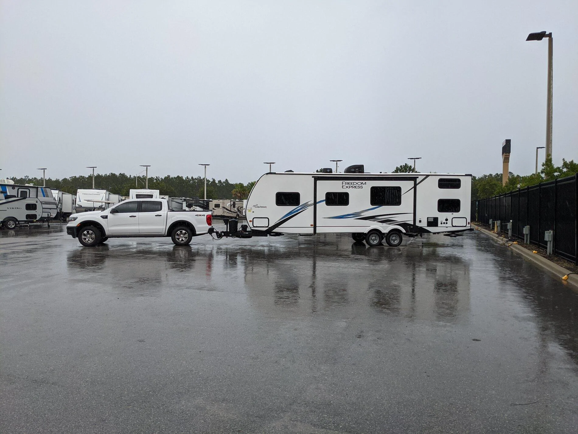

Well guys pulled it home 20 miles in a Florida rainstorm going about 55-60 MPG.
Multiple semis past and I felt it not gonna lie but nothing terrible or crazy. Engine was idling about 2000/2500 RPM the whole time pulling.

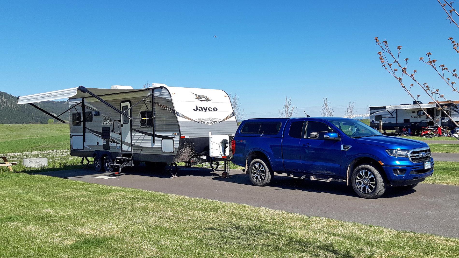

We've been towing a 24' (29' LOA) travel trailer at around 6,500 lbs with water. This is a bit longer and heavier than we had originally planned, but has been working out okay. I really wouldn't consider anything longer or heavier. Our highest comfortable highway speed is 65, but we back off to 60 or 55 if there is any significant crosswind as we do get bounced around quite a bit. Going faster than 65 doesn't feel confident or comfortable, even in calm wind, and that would just further tank the mileage anyway. The biggest disappointment is range, which is about 185 miles as our mileage at highway speeds averages only about 9 mpg. I really wish we had an extra 5 gallons or so of fuel capacity. We have more than enough power going up mountain passes at highway speeds but we typically go a bit slower on the downhill side. The tow mode on the transmission works surprisingly well, automatically downshifting when you touch the brakes, meaning I rarely have to manually downshift. The Ford/Redarc brake controller works well, and the few times that I've had to brake aggressively, the truck and trailer have behaved compliantly. I've never had to manually hit the brake controller. The one time I got a surprise gust at the peak of a hill, everything straightened out almost immediately. The Ranger's built-in sway control likely restored order before I had a chance.

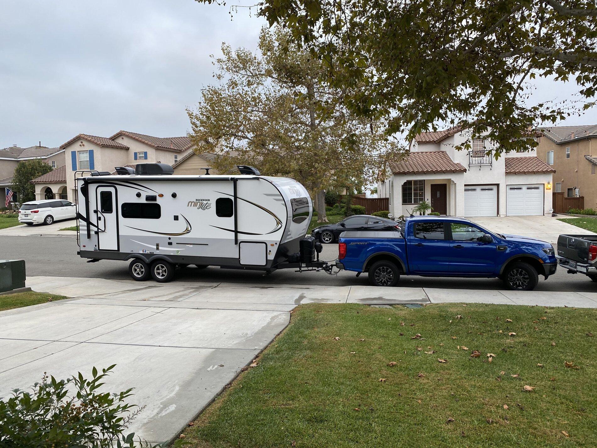

Was thinking the same thing. 25ft or less and would want to be 6000 or less in weight. I got a micro minnie which is 7 ft wide. Makes it very easy to tow.

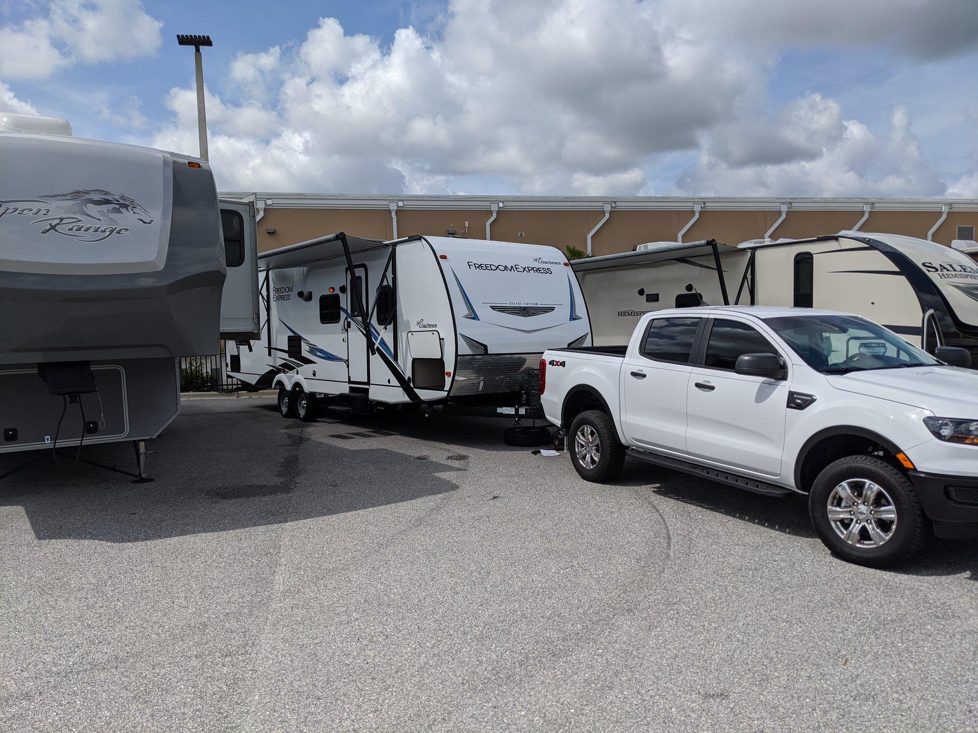

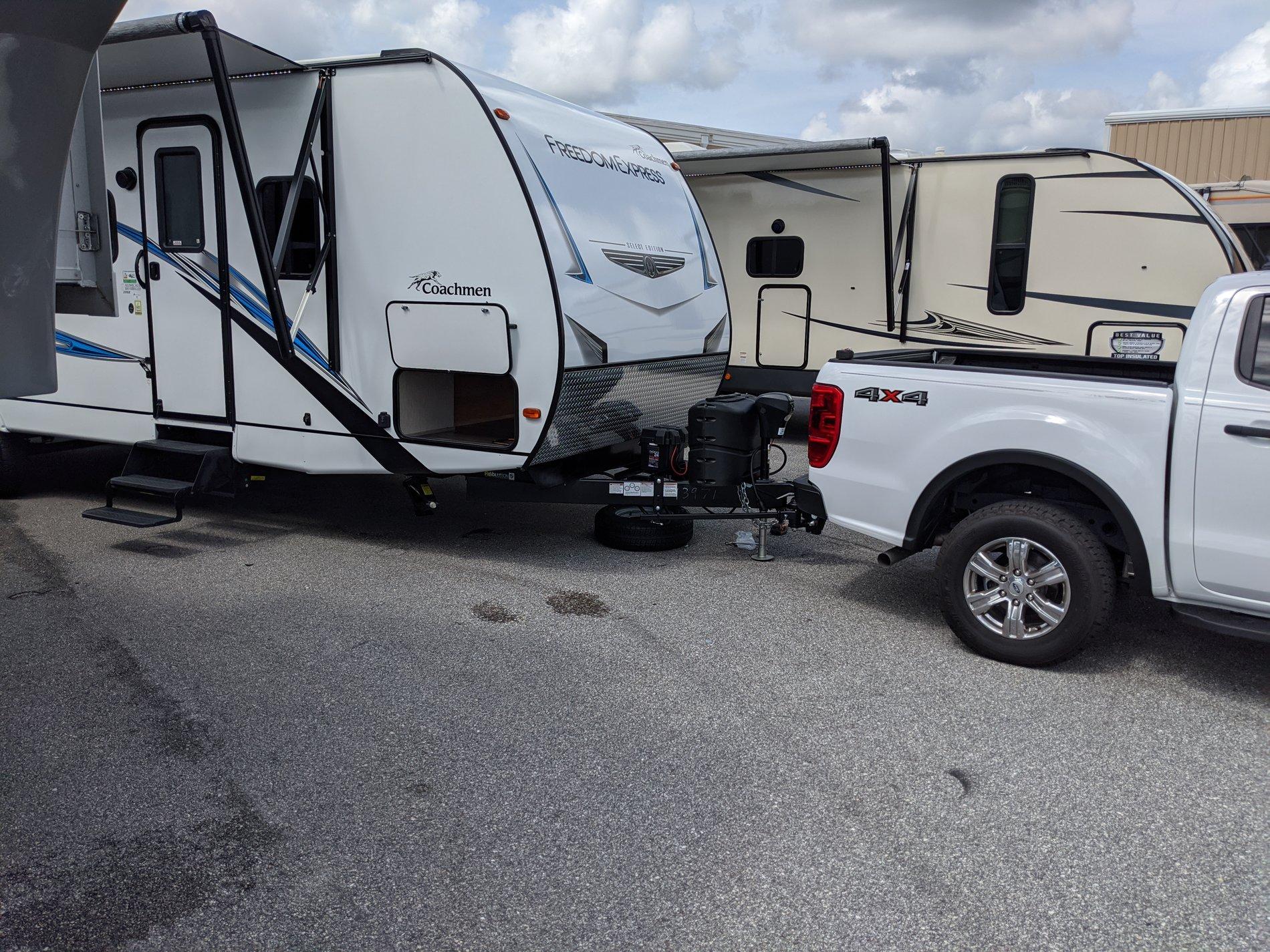

Well we pulled the trigger on the 33' trailer. Here is it hooked up to the truck. They had to put a 9" drop on it to set it up right.
My experience with rvs is that it takes you three times to find the one you really want :)

RangerLover - How does your rig handle in the wind? Looks like you have a WDH. Also, the braking performance....assuming you have a brake controller. I am looking at something similar in size and weight....many seasoned in towing tell me the unit is to big...but I am beginning to doubt the knowledge
